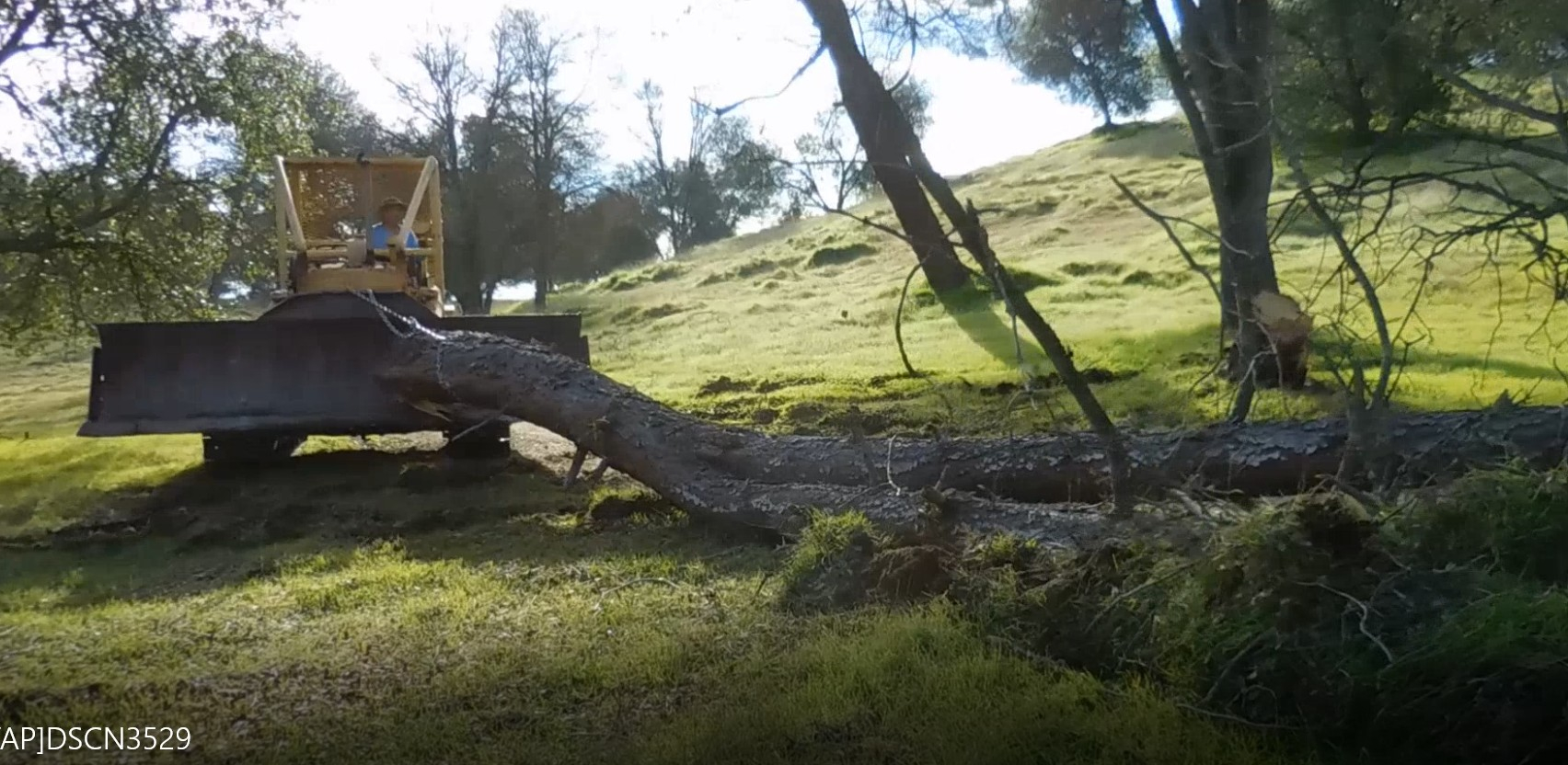

Several giant digger pine trees that I needed to cut down due to the tilt.
It could fall down very soon and be dangerous to our family.
I have had this dozer for more than 15 years and cleared my 80 acres property.
This is a 1958 International Harvester TD 14 142 Series. It is 64 years old and made in the USA.
This is probably my last mission with this dozer in my life.

How did you come by that machine? Original owner?
First tree looked lake it was hung up on the stump. I was surprised to see the power nose down as you tried backing up. Thanks for sharing.

I purchased this big toy 15 years ago from another guy for clearing the heavy wood property.
Probably I am more than the 3rd owner.
Yes it is said to have a 60hp 18000 lb 4 cylinder engine but as you have seen it is so powerful..
