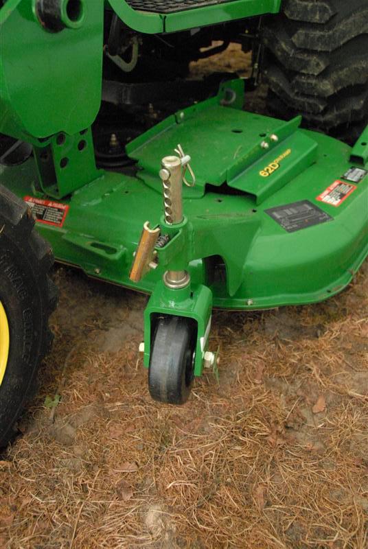

   / 62D MMM Creating Divots with Front Wheels #10
megotatractor said:
can someone post a pic of these wheels?
Your wish is my command! :)
I can get other angles if you like.
