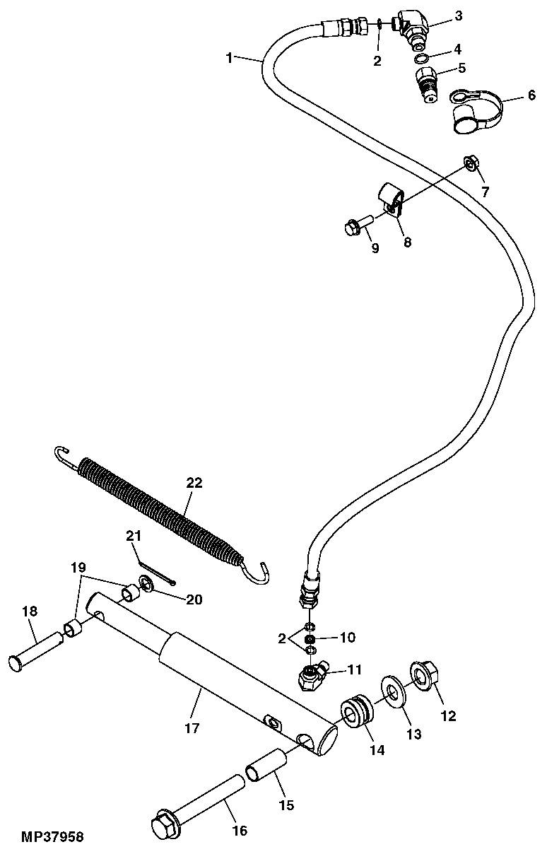

Answer to a previous question - yes, the 2305 has the hydraulic speed control for lifting/lowering the 3ph.
   / 62C mower deck won't lift or drop #25
The cylinder in this picture is the optional lift. It takes the place of items #19 - 33 in Loogie's first picture if you have that option.

I have a 2305 with a 54 inch belly mower deck. It was slow to raise and lower. Remove the hydraulic hose at the cylinder that raises the mower deck. There is a silver metal disk about the size of a dime with a pin hole in the center(referred to as the orifice part E in the mower lift kit manual). The pin hole was blocked. I cleaned it out with a pin and replaced it. Deck moves properly now. Easiest way to get to the cylinder is to remove the rear tire.
