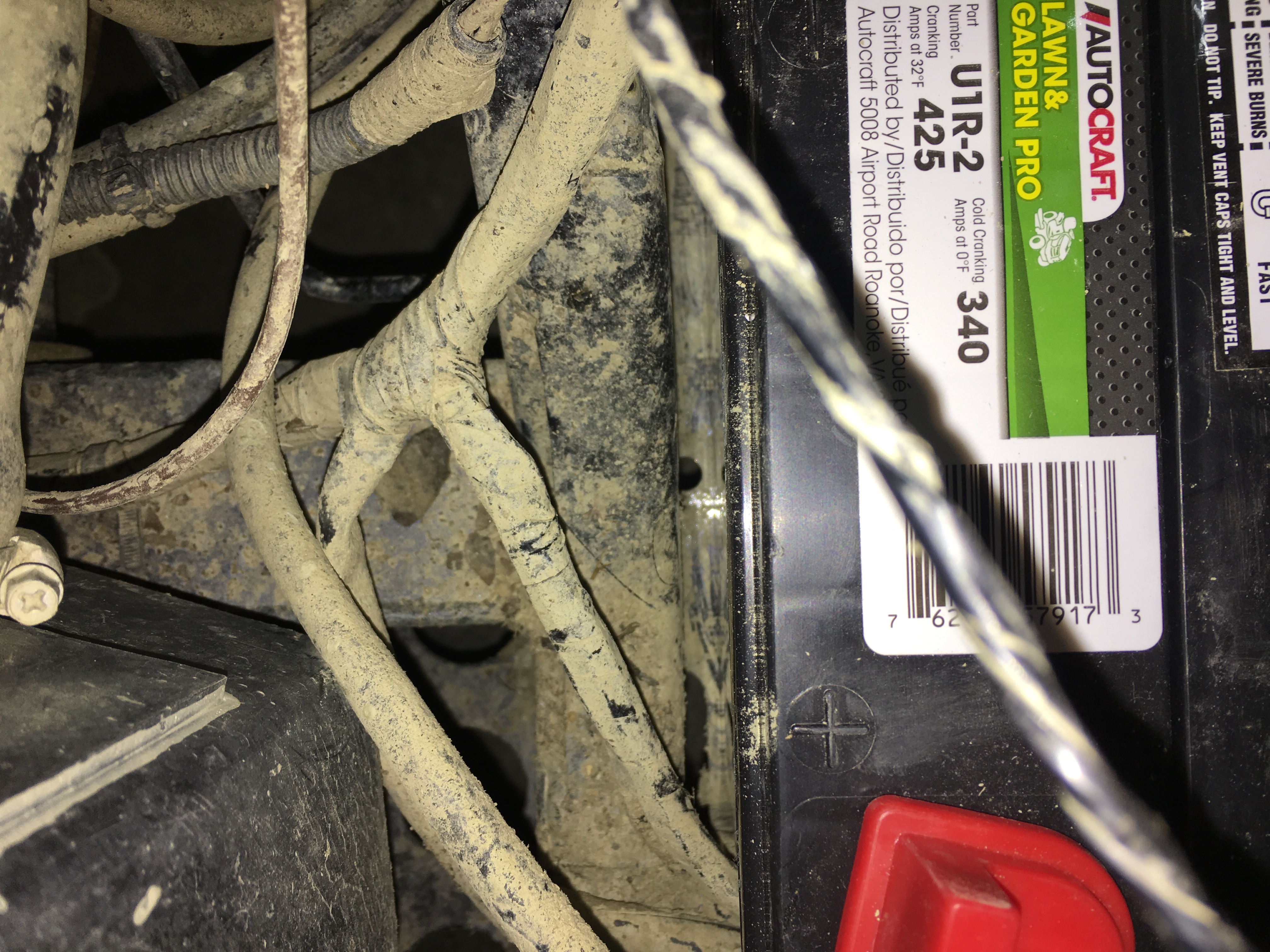

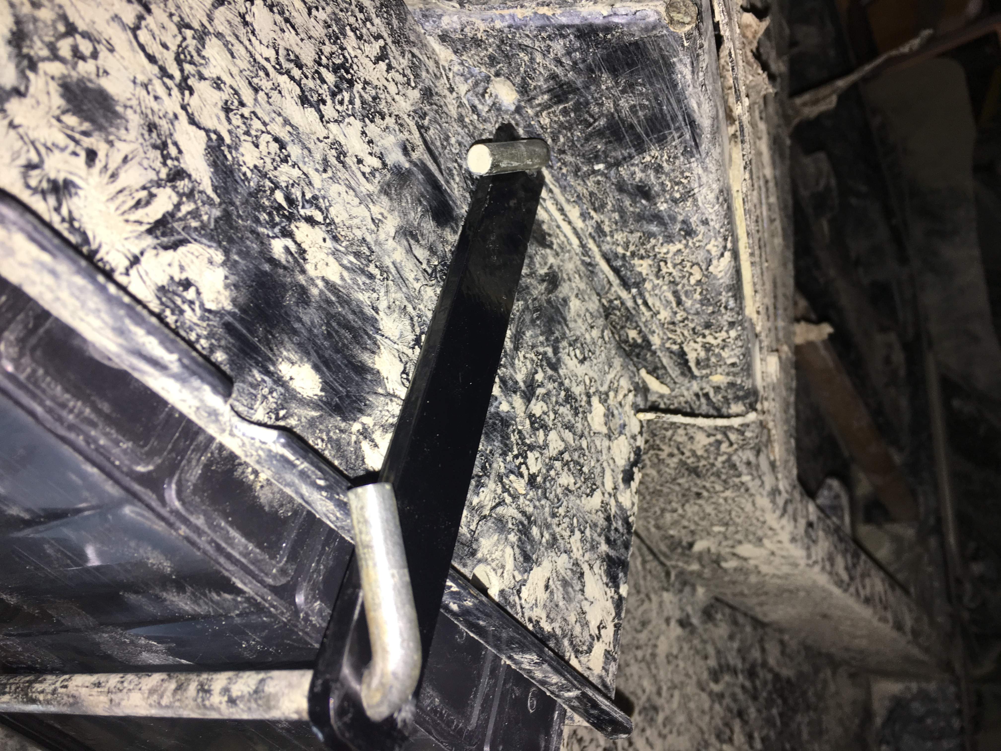

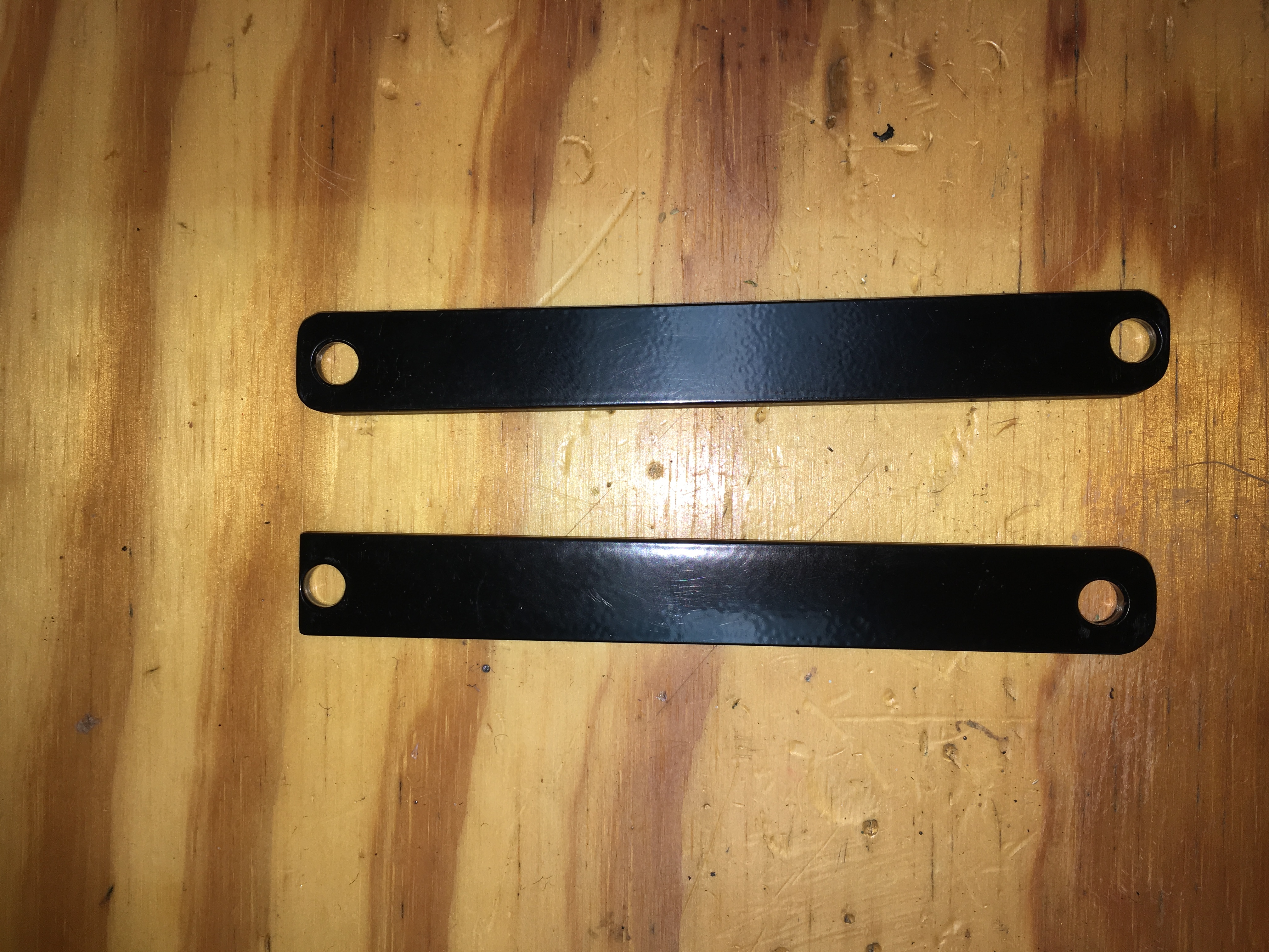

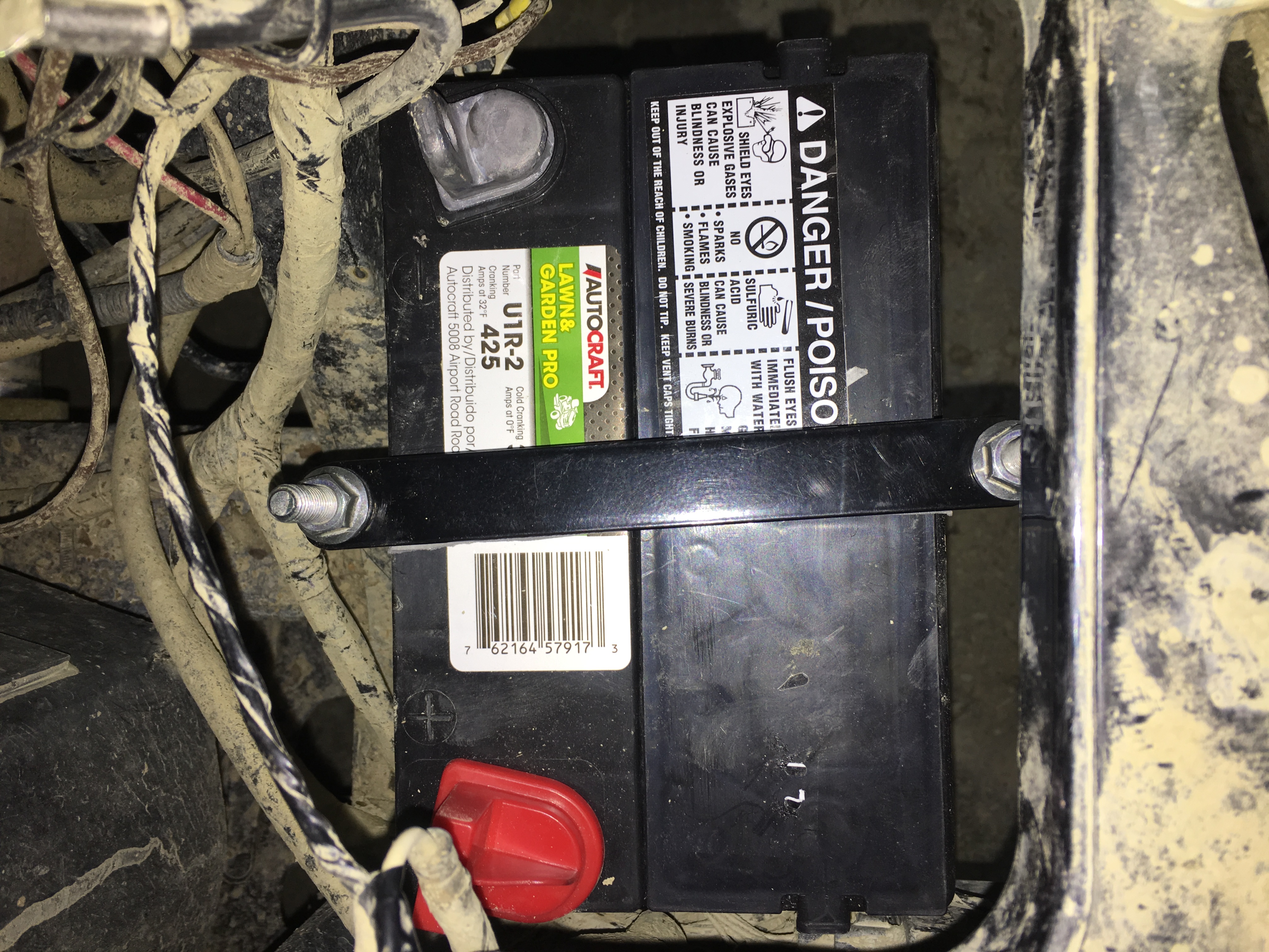

My sons JackA$$, thats what ya call a small mule, battery died so I looked at replaceing it with a larger lawn mower type.
They sell kits to do this but they are high for what ya get. So I improvised with some 3/4 inch wide flat stock I had on hand.
The holes are spaced 5.75 inches center to center. The bottom piece has to be ground close to flush with the hole on one end
for clearance. The battery sits over a little and I may put a piece of treated plywood under it for extra support. I placed some
foam tape under the top piece and snugged it down.
My son sandblasted and powdercoated the brackets. We now have a 340CCA to replace the 190 CCA it had. 297B706B-743B-4204-8AB9-D2AF56DE3CBC.jpeg6C0B92A1-8EFC-46B4-9217-357303F7D94A.jpeg807009C6-334A-43D5-978E-2D941504E850.jpegD0A864CD-E78A-4CD8-8243-B4BEB6E02524.jpeg98C378E8-035C-4502-AACF-0DA08F570334.jpeg
