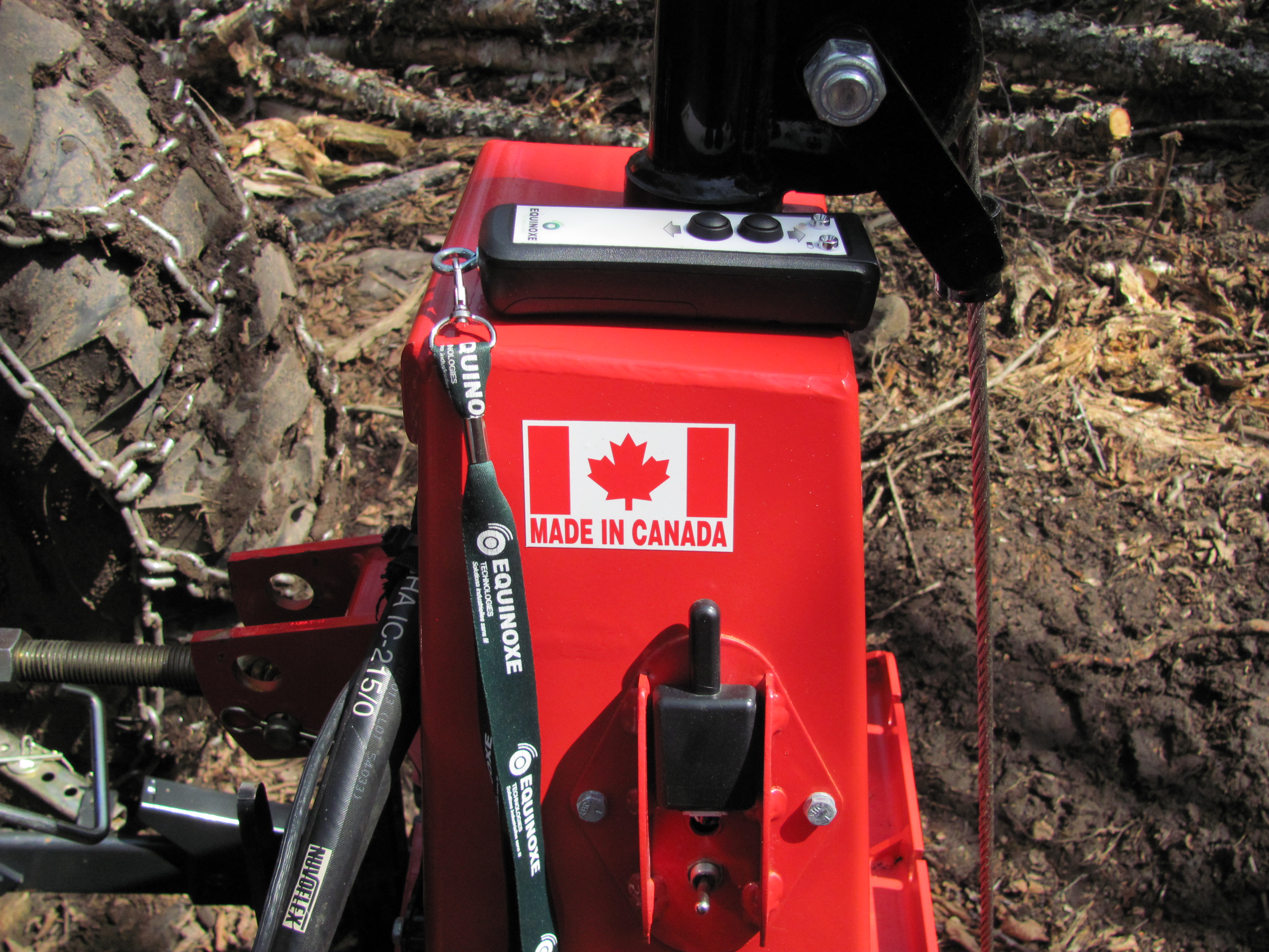

Something you may want to consider if you are a one man operation is a wireless remote for your logging winch.

Downsizing the winch to make it the limiting point is interesting. Of course I was looking at the biggest baddest winch possible. But sizing one smaller than the tractor could otherwise handle is an interesting approach. And I have pretty much decided on a remote control for the winch-- just in case.
