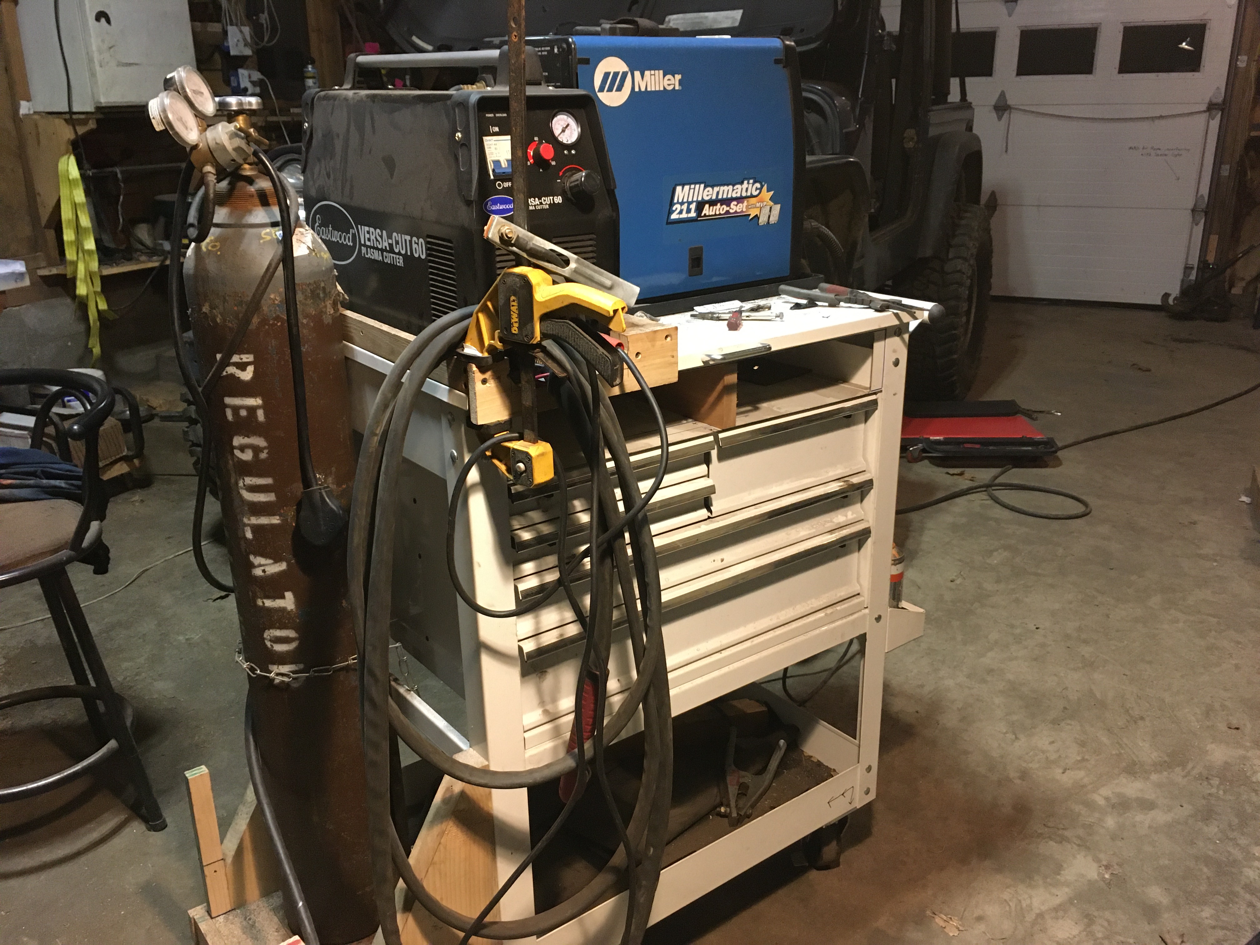

And the newer neighbor is getting tied of looking at it so he list on Free For The Taken........ My Miller211 is the same stile as your Miller140, just a hair more oomph and lot more $$, might be the next size up, they still make the 211 but different smaller version I assume it has the same out-put. Sounds like our duty cycle is about the same, comes with age....
Miller Millermatic 14 MIG Welder with Auto-Set for sale (97335) - Welding Supplies from IOC
Miller Millermatic 211 MIG Welder with Advanced Auto-Set for sale (97614) - Welding Supplies from IOC
I don't know if he'd give it away as he has plenty of room in his garage where mine is pretty full.
Yes that 140 AutoSet is exactly like mine, I purchased new in May 2010 for $649 and I think the Miller 180 AuotSet dual voltage was about $950 at that time.
My lifetime lease for a 80 cubic ft argon/co2 bottle was $200 full, and when I purchase another 80 cubic ft bottle of argon for tig welding it was $250 about 5 years ago,
Now I see your can purchase bottles empty from Amazon for about $160.
