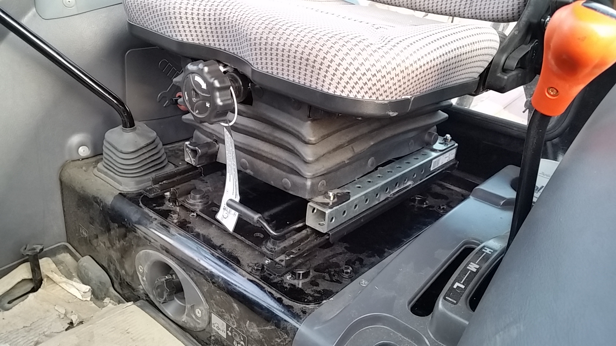

I need about 2 more inches of leg room on my XR4040 but this doesn't work on my tractor.

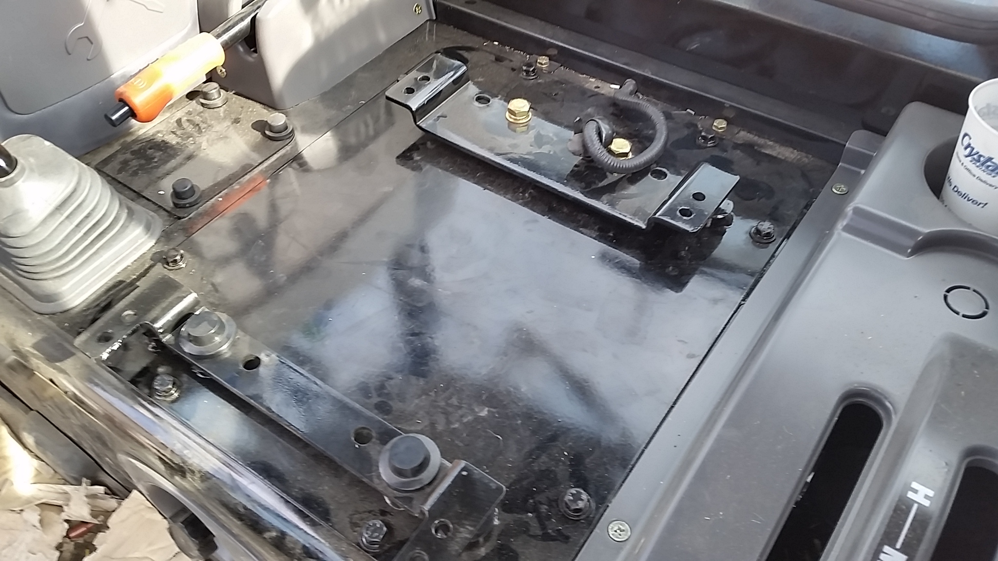

I was able to move my seat back by changing the bolting on my XR4046HC, I'm not sure on the open station but I would think the floor pan is the same.

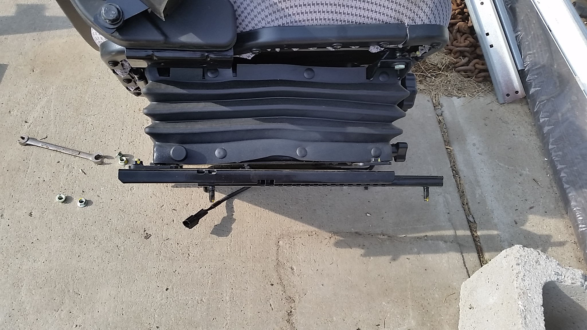

Did you use existing holes or drill new. Looks like my xr4040 has two sets of holes, mine is bolted in the back so I would have to drill to gain any length. There is room for the seat to move back a couple more inches though.
   / 60 second seat seat adjustment fix (extending it back) #38
For those with the XR, Legroom is NOT really the issue, It's height. I raised mine 2" and it made ALL the difference in the world!!!!
