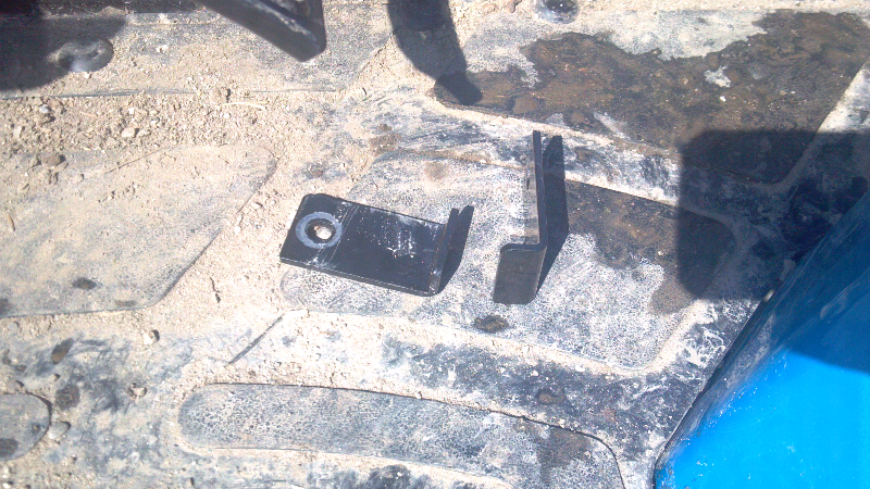

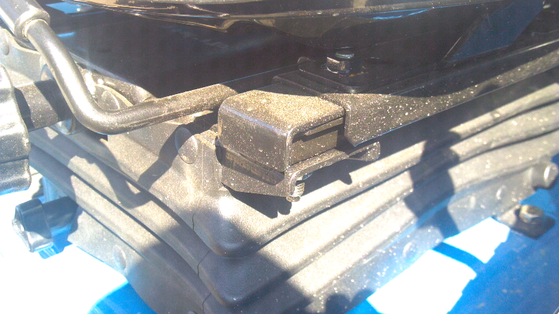

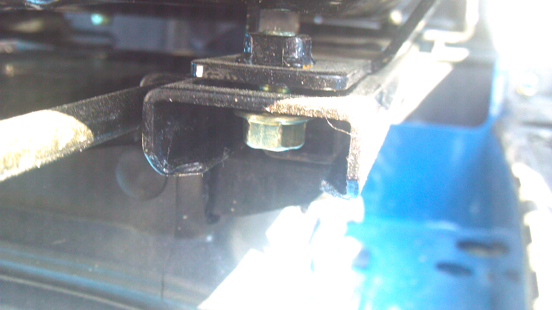

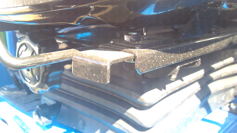

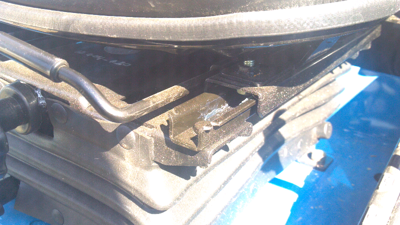

If someone's already posted this, sorry for the repeat...
I've been complaining about the seat not sliding back far enough so I looked at it today. Very easy fix.
Grab a #13 socket. Pull the seat forward. Unscrew the bolt holding the "stop bracket" right at the front of the rails (unscrews from the bottom). The bracket falls off. Replace the bolt (so u don't lose it). There's one bracket on each side.
Enjoy several more notches of leg room!

I got to wonder what function those two pieces had and what bad thing is going to happen now that you took them out.
   / 60 second seat seat adjustment fix (extending it back)
My guess is that they're there to keep the seat from going all the way back and hitting or rubbing against the fuel tank. However, there's a thin metal cross bracket behind the seat that also protects it...
I'm thinking the "stop brackets" were an initial fix to prevent it, and that the cross bracket was added later.
The new Holland version seat goes back further, like mine does now. I'd have to go inspect one, but I'm guessing they just use the rear cross bracket, and not the seat rail stop tabs
