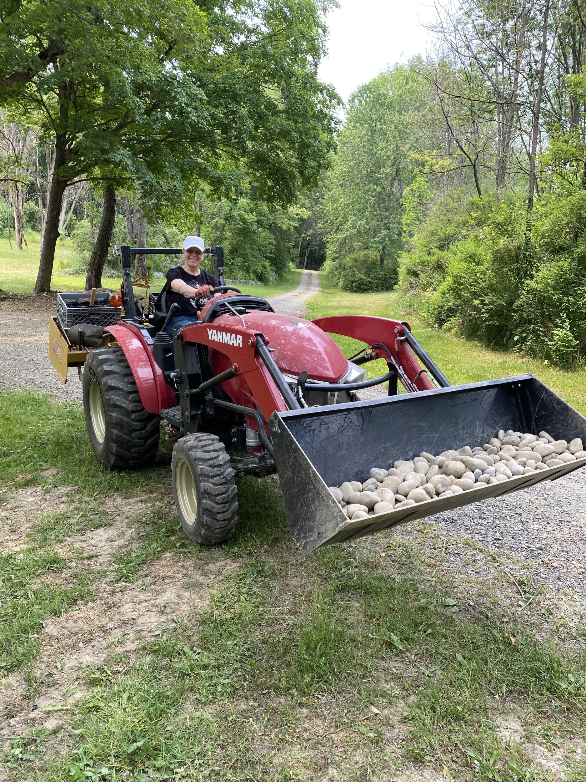

I have YT235. No cab. I ordered at set of BORA wheel spacers before it was delivered to the dealer. When it arrived both front and rear wheel were set “in”, when the wheels were set out there was no need for spacers. They sit on my shelf. All education is expensive.
