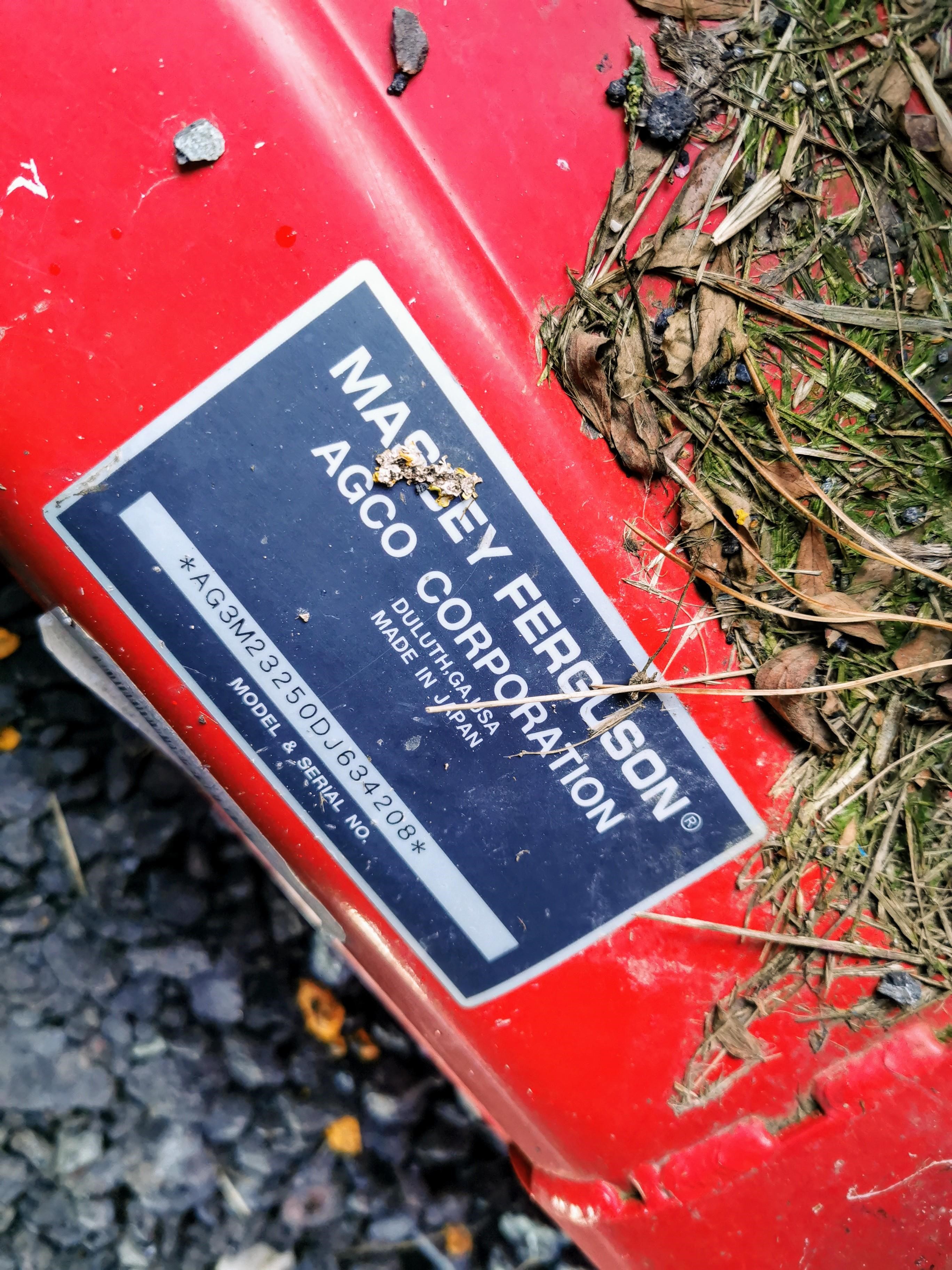

Just bought a 2017 GC1705, the seller was not sure if the MMM is a 54'' or 60'' deck.
Can anyone tell by this number i have from the deck? As far as i know its a 60'', but im not sure. Tractor data says its supposed to be a 2326 deck, but mine is a 2325(?).
AG3M2 23250DJ634208.
Martin
/ 60'' MMM on GC1705 #2
Hi
Martin
It's a 60" mower.
/ 60'' MMM on GC1705 #3
There are two different 60-inch decks I think. The 2325 may be the light-duty (standard) roll under deck and the 2326 (which I have) is the drive-over deck. Can you confirm which way yours mounts?

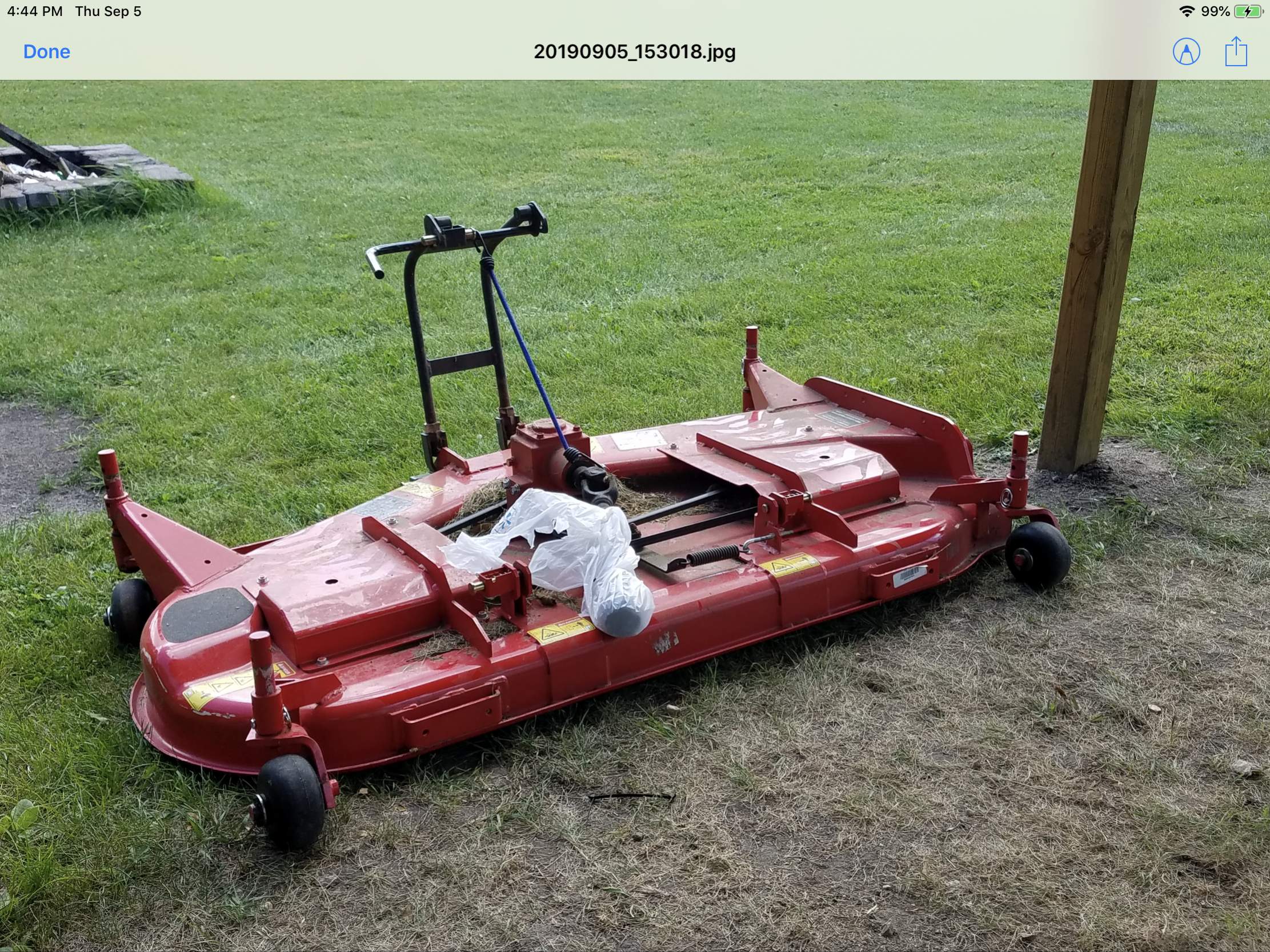

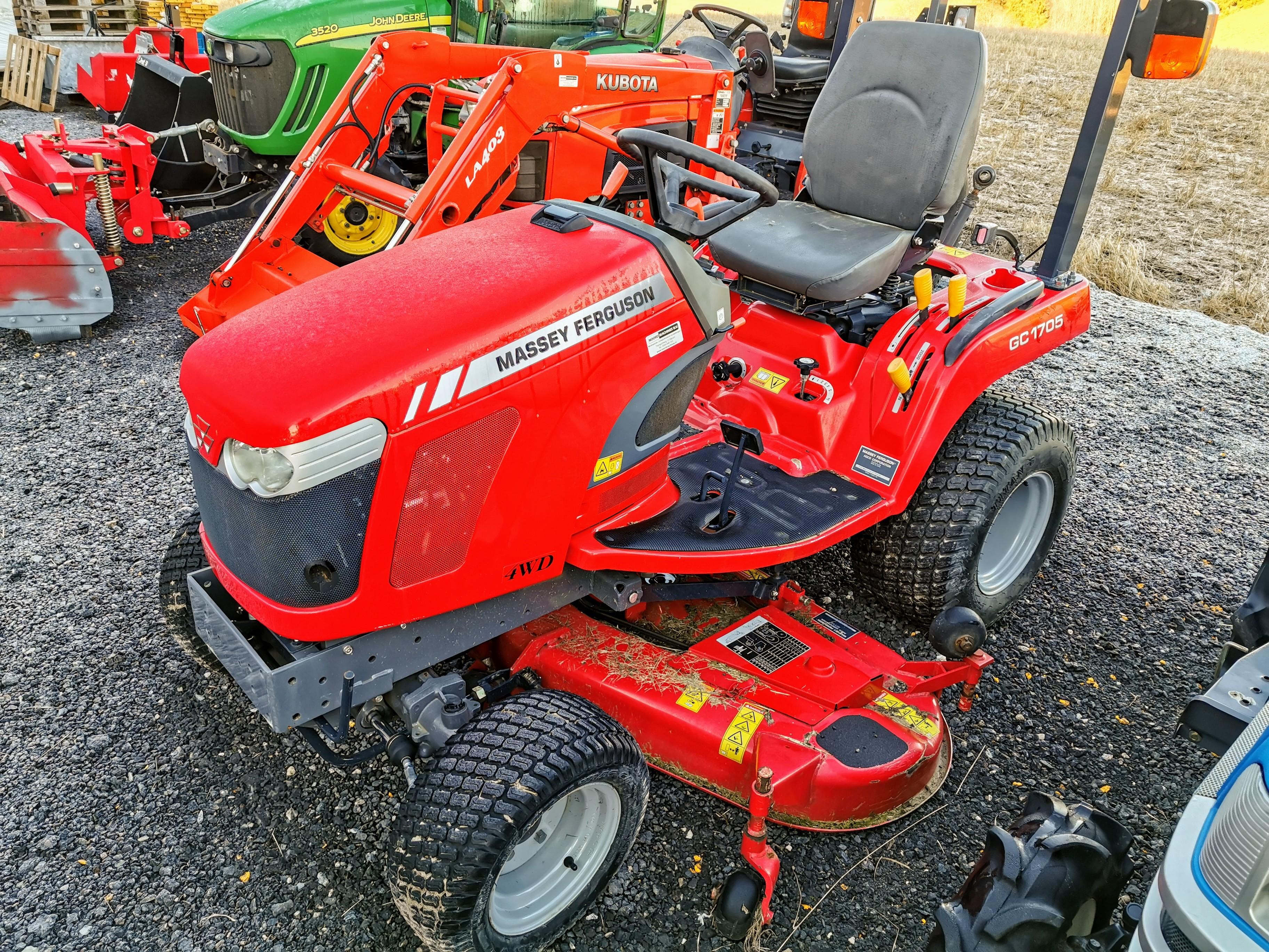

Here is two pictures of the tractor and deck. I just pulled it out from the side and back on the same way. Not sure if this is the one i can drive over.. Seller was not sure either.
/ 60'' MMM on GC1705 #5
Definitely NOT the drive-over deck. Yours is the roll-in/out style.

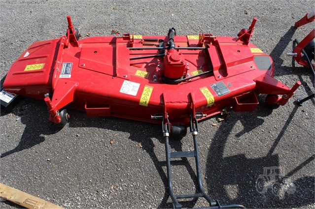

This is the 2326 - note the brackets on the front for the front wheels to get purchase and back over and the heavy-duty belt coverage/wheel path. Heavier gauge steel as well.
