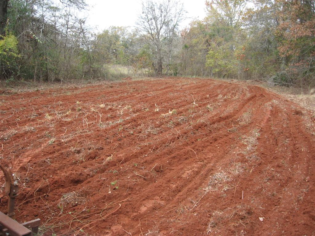

Ok well maybe 90 with all the picture taking.

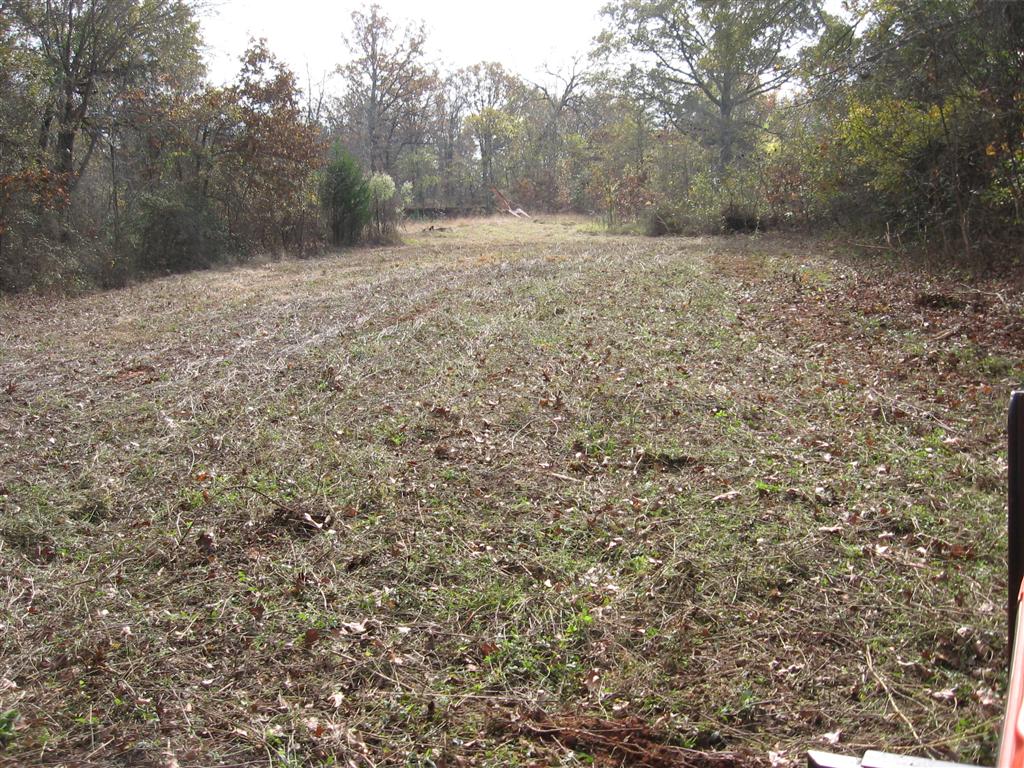

We scouted this place, sort of a hidden half acre field that wasn't to far from the house. My wife and daughter went into town so I decided to play. It's really to late for a food plot this year (most all of the deer have gone 100% nocturnal), but it's a start for next year. Actually the soil looked promising for a garden this spring.
This is what it looked like at first, I made one pass before I took the pic.

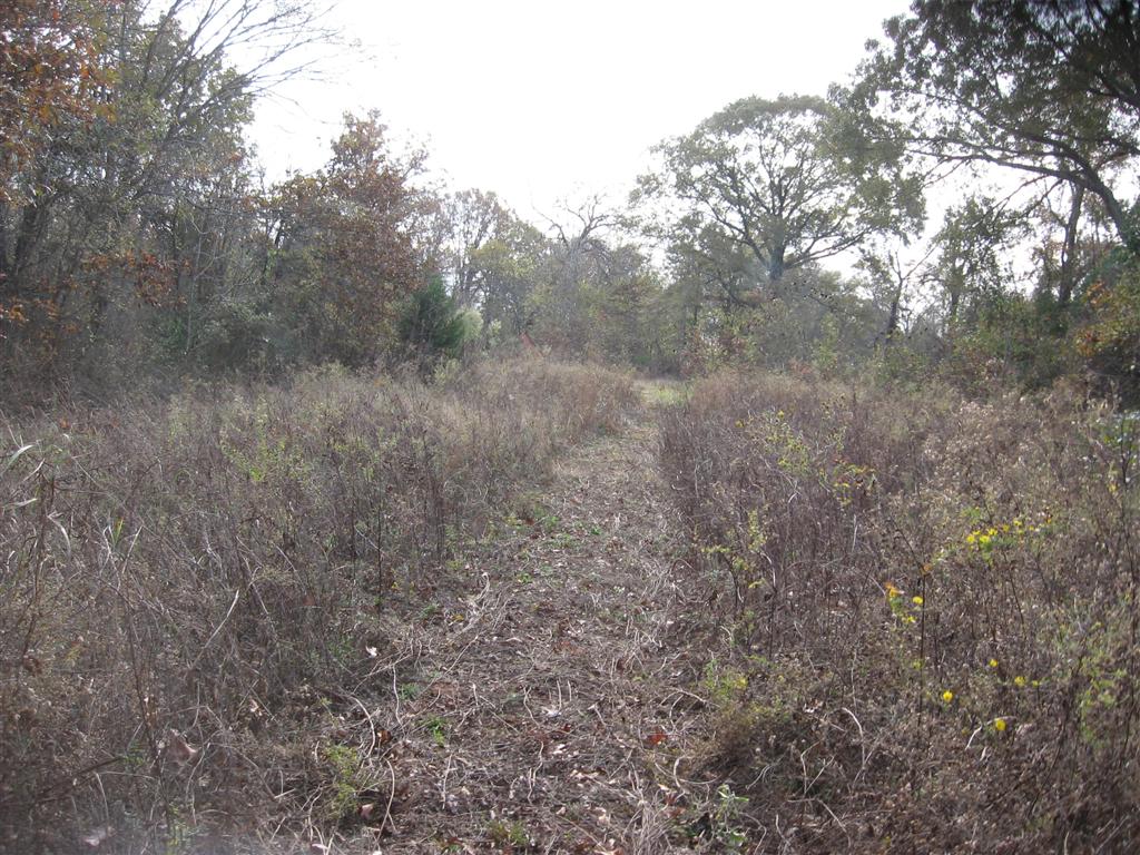

   / 60 minute Food Plot
#2

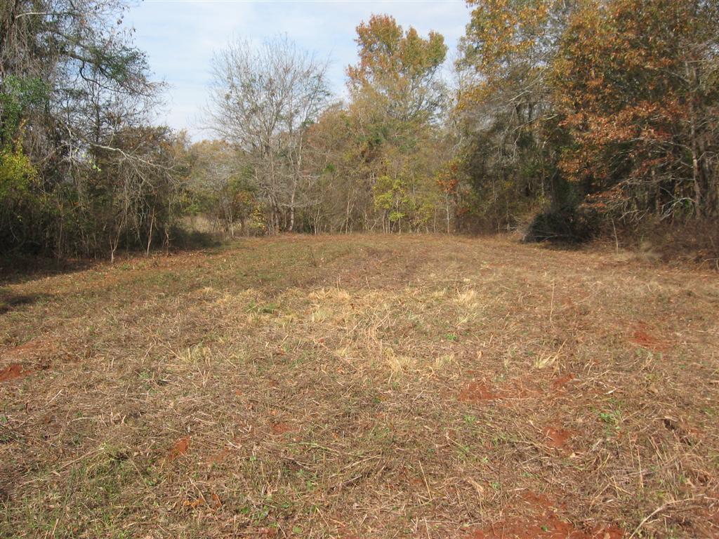

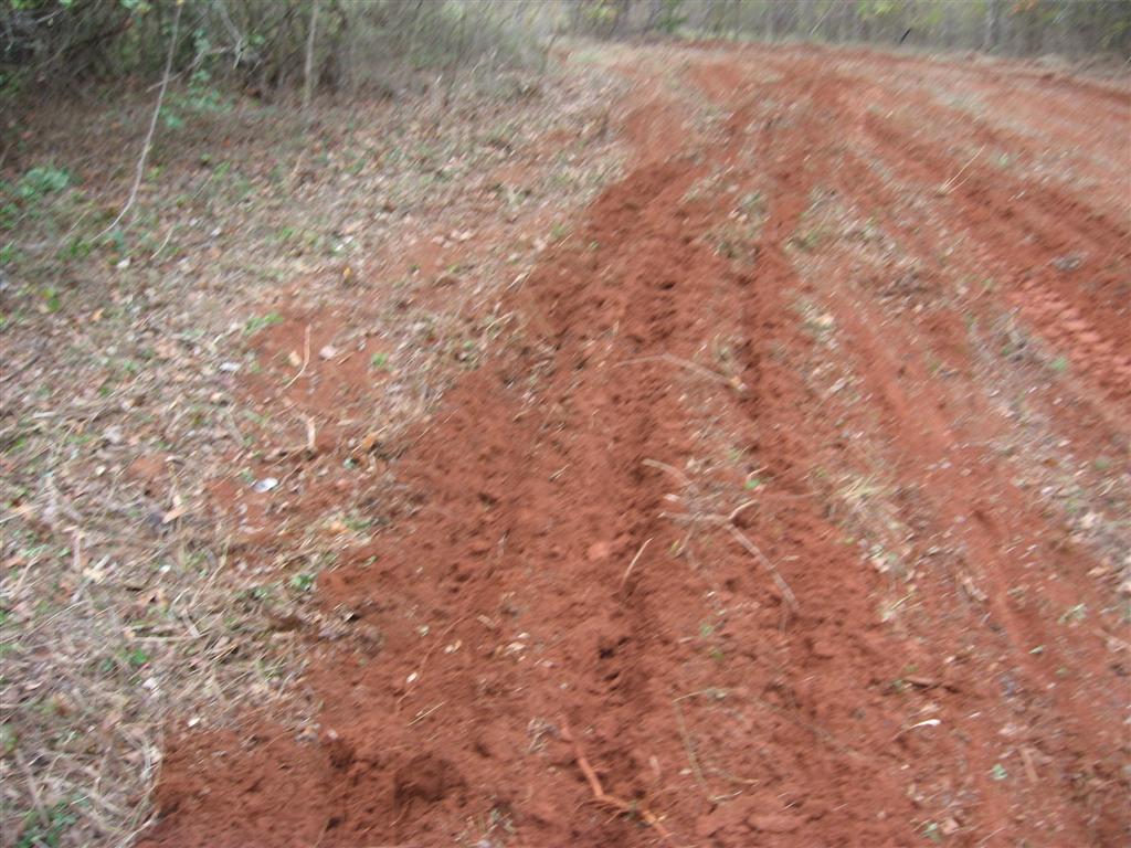

Then after a mowing. Lots of briars and vines under there.

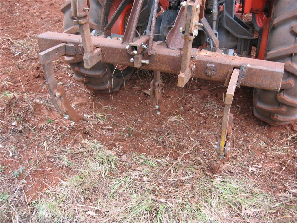

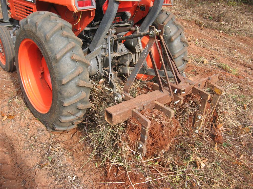

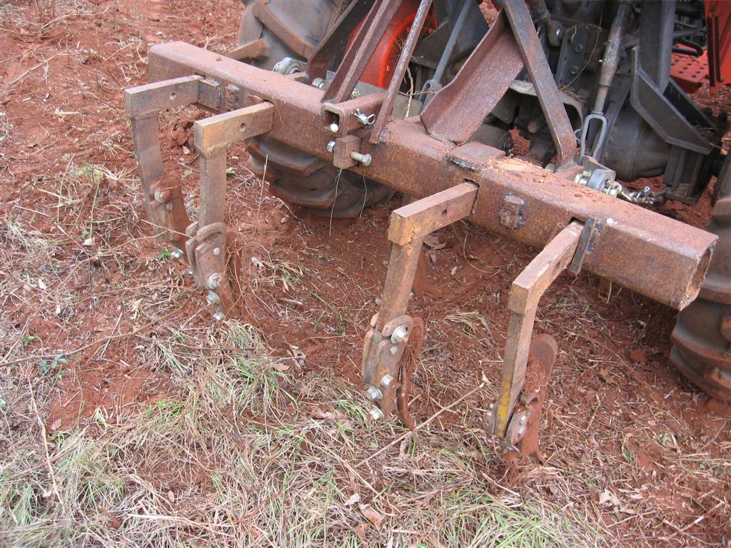

Some of yall have seen this homemade contraption I made from some old plow parts I got from my uncles place. there are 5 chisels to rake up the dead stuff. I don't put it to deep in the ground, at the end of the row I lift, back up to drop it, then head out again. It really cleans it up. I guess a landsscape rake will do the same. But this one was basically free!

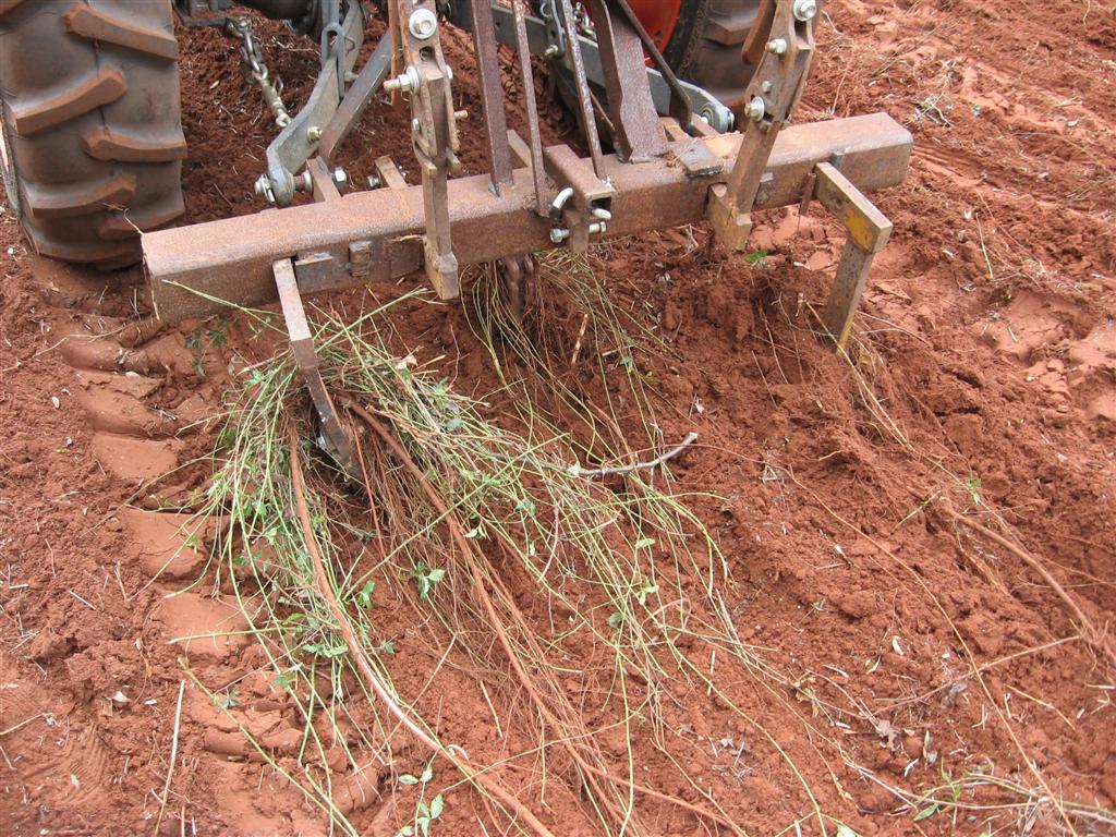

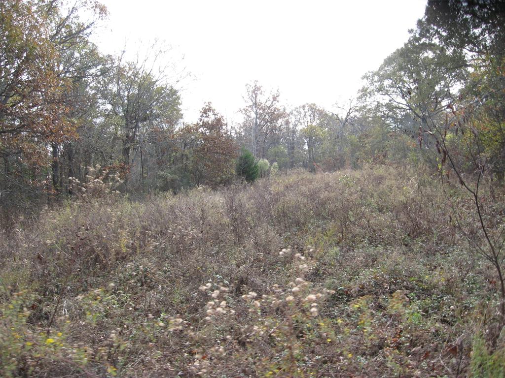

Once I get most of the junk rakes off I remove 2 of the chisels, leaving only 3. They are spaced further apart so I don't pick up as much junk but I run deeper to loosen up the soil. First pic a before then after.

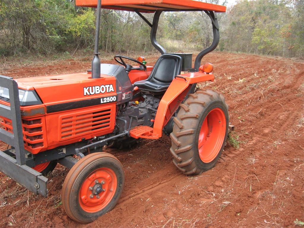

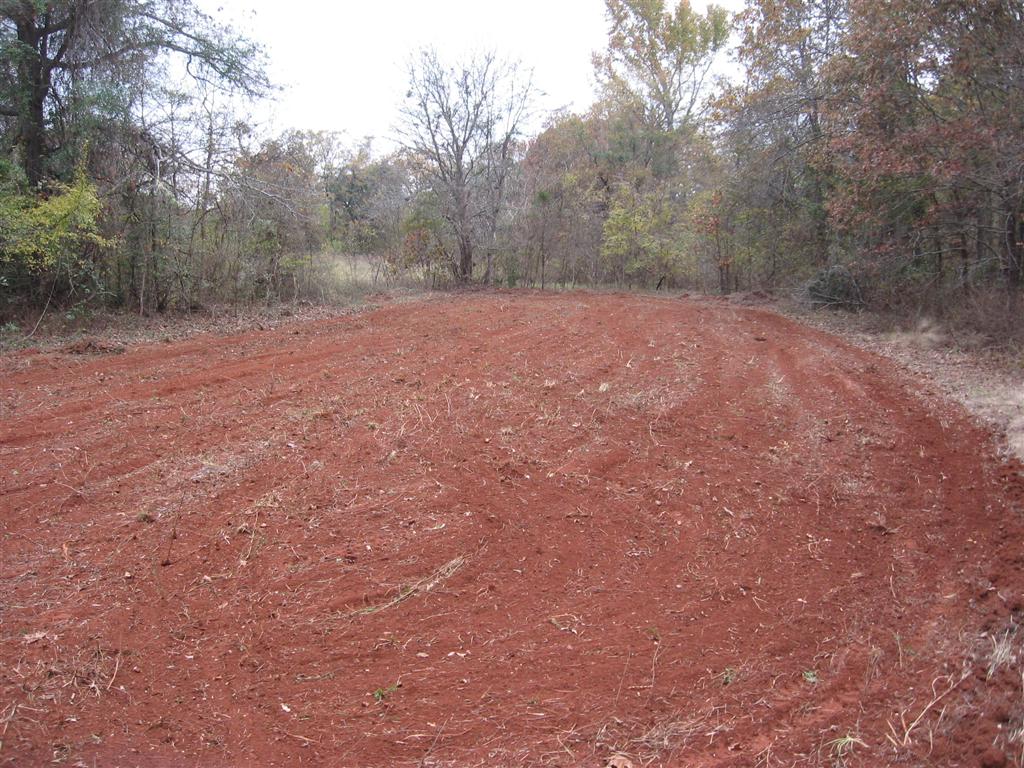

Of course the tractor shot!! And the finished product.

After I hand tosses some rye and used my ATV and drag to cover the seed and smooth it out. I thought about bringing the disc out but for this late in the season and the really loose soil it didn't need it. I'll start to disc in feb-march if it's dry.
Enjoy the pics if nothing else. I'll try to follow up with another in a couple weeks when the rye comes up. I only had enough seed for the right side so we'll see.
