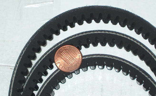

I ended up going with the Dayton 6L260G from Granger. This is an AX120 belt. Just put it on. Pic attached.
