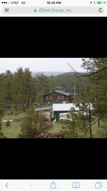

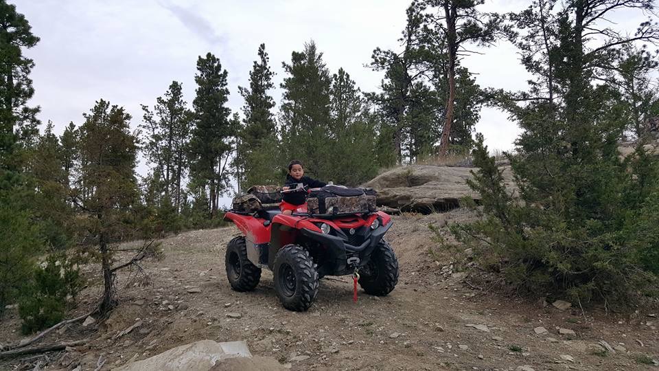

I purchased about 200 acres in Montana a few months ago and never had a tractor before, im pretty handy and can run equipment but never owned a tractor.
Property is about 50% wooded and 50% pastures with some rolling hills here and there...I plan on doing some hobby farming (in the future/maybe), food plots for deer, build and maintain some roads, clear snow, move rocks, logging (lots of logging) and just whatever else comes up
I currently leaning towards the Kioti NX6010 but am fairly open to a good machine at a decent price. The reason i stoped looking at bigger than 60 hp is the lack of Hydrostatic transmisions on them, once o drove the hydro i knew i HAD to have that, I want my wife to be able to use it also, hydro is MUCH easier
included a few pics of the property so you can see what ill be dealing with
