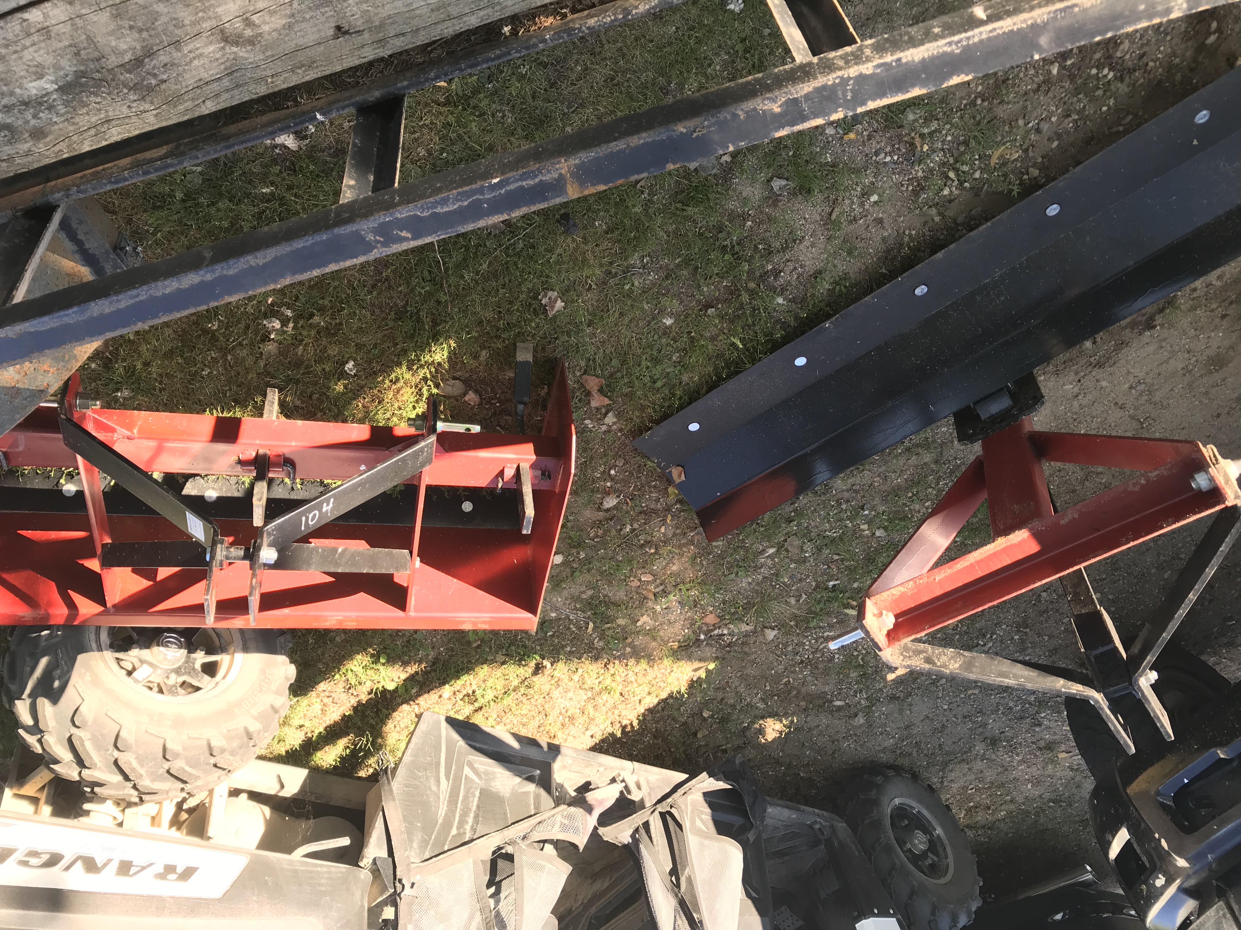

I just bought a Walco box blade and back blade with my tractor purchase they look well built. I bought a MF GC1705 and the box blade is a 48 inch and the back blade is a 60 inch.
Jim.
