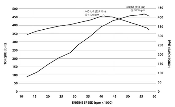

Here is a factory dyno graph of the GM 6.2L L86 (looks the same as the L87):

Here is the factory dyno graph for the GM 6.6L L8T:

Notice how the L8T/6.6L makes more torque at lower RPM versus the L87/6.2L that does make more power, overall, but takes more RPM to make the same power, in the lower ranges.
Under the same conditions, the L8T will outlast the L87 due to having an iron block, lower compression ratio, a regular pushrod (no DFM), and being able to do more work at a lower RPM. And it will do it on less expensive fuel.
