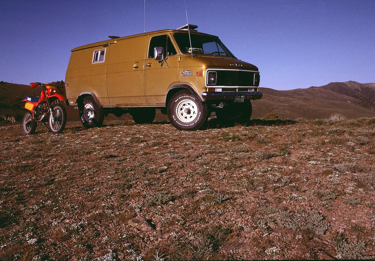

I personally do not like siamese bores myself. I am old enough to remember how that failed back in the 70's when GM utilized Siamese bores to punch out the otherwise outstanding 350 small block to attain a 400 small block from the factory. The 400 was pretty much an utter failure.
Sure glad the 400 in my 1976 GMC Terravan wasn't an utter failure. Drove that thing for 32-1/2 years! Unlike most though, my front main seal leaked, no problem with the rear main. No other engine problems...got rid of it when the body rotted out.
