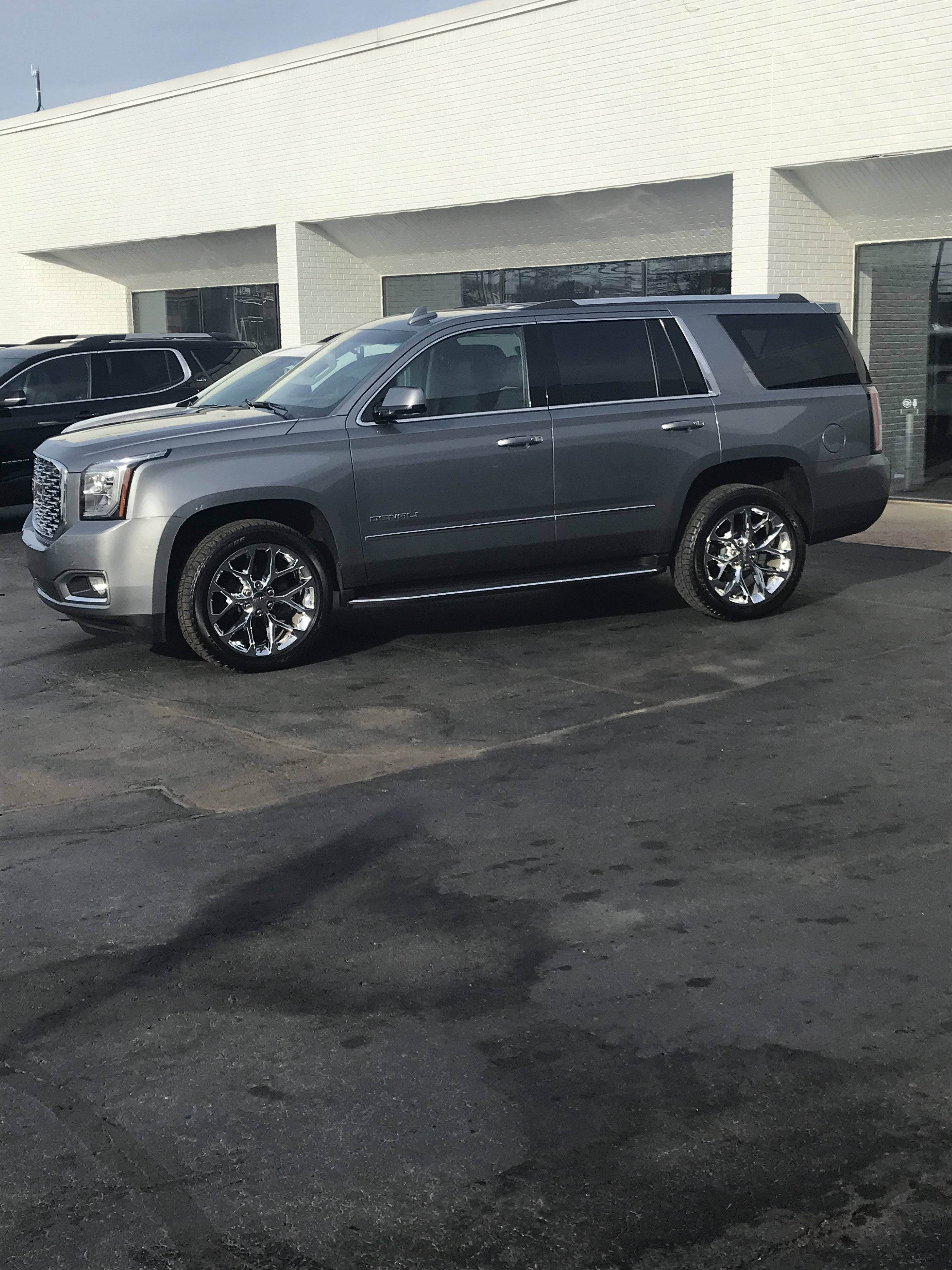

I have the 6.2 in my 2020 Yukon with the 10 speed but towing is only at 8600 lbs.
