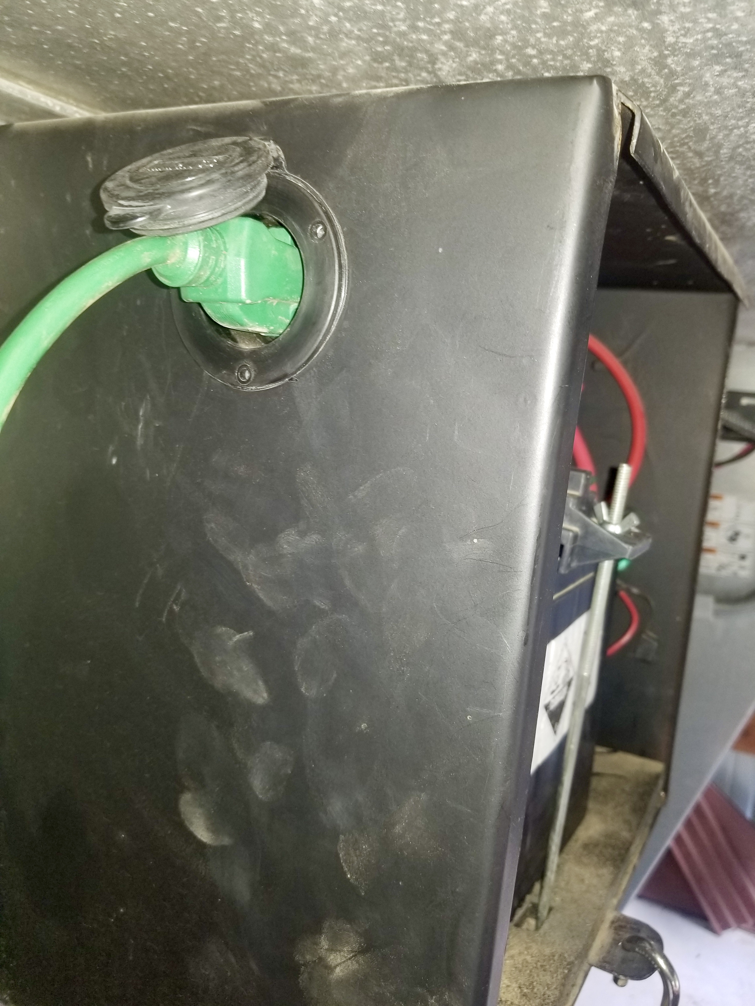

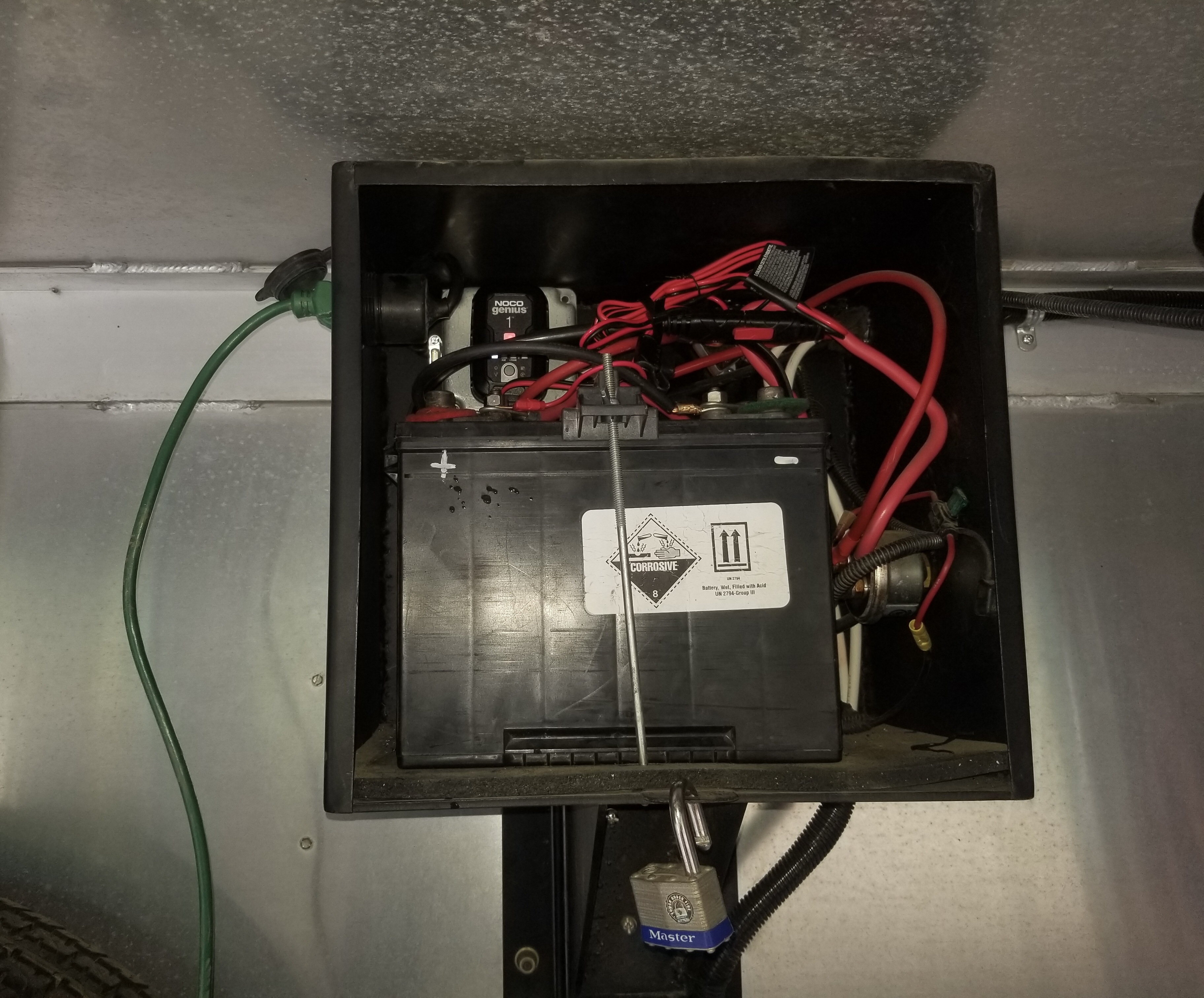

Im no expert, but i dont think a battery is designed to get a long charge at 50 amps. Even my rolling battery charger only has a recommendation for a couple of minutes at 40 amps, and the highest setting is for use during starting only. Otherwise its 4 amp charging on a timer.
At 40 amp charging, my battery gets hot pretty fast.
What ive done for my trailers is to install a 1 or 2 amp float charger hooked onto an exterior male outlet so i can leave them plugged in when not using them. Batteries always fully charged.
