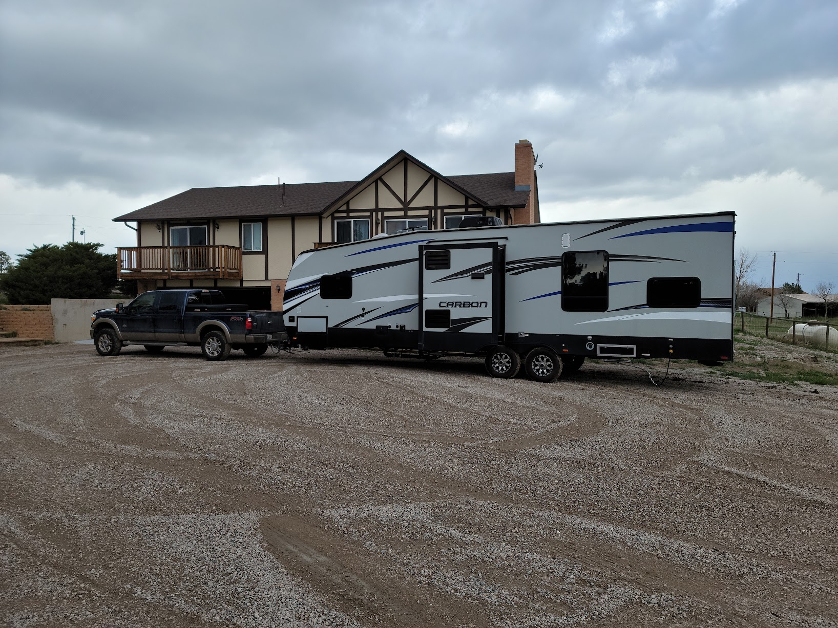

Looking to hear people's experience about towing a bumper pull with a side by side on a rack over the bed/cab or pulling a medium/small 5th wheel with a double trailer (2,000lbs of side by side). Not teribly tractor related, but hoping the TBN hive mind has some experience on this front.
We mostly dry camp. No campground or hookups. Just head out to the woods for a long weekend. We don't want to take the camper offroading, but some of the dirt roads aren't great. We are planning on some longer multi-week trips to national parks & what not that would likely be normal campgrounds as well. Just me, the wife, the 45lbs dog & in some cases the cat. We have a 2 seater Artic Cat SxS toy that weighs around 1,400lbs.
2014 F350 double cab short bed (6.5') & PowerStroke. Weighs around 9,400lbs with toolbox & normal gear load for traveling, camping, etc. Thinking about pulling the bed & putting an aluminum flatbed on in many scenarios so I can toss a tractor implement on. I need a skirted one with built in toolboxes under the deck to replace the bed box I have now that would block a ramp or 5th wheel hitch..
Former option: 17' Casita, 3,500lbs. Towed well with my former Toyota Tacoma. I could have towed it without wheels on at freeway speeds well with the F350. It was too small for us to live in & a F350 powerstroke not being appropriate for keeping up on trails with friends lead to getting the SxS.
22' flat deck trailer (4klbs) & 8klbs of tractor & implements, 12klbs total (Same as the Carbon 35). 1,000-1500lbs tongue weight according to the WeighSafe hitch, no WDH or sway control. Load varies depending if it's my tractor or somebody else's or how many implements. Tows down the highway at 75 & have it 80 (usually keep it under 70 though) with no issues as long as I balanced it right with the WeighSafe hitch. Feels solid & well behaved. Irrelevant for camping, although I could in theory haul the SxS on it. Baseline for what the truck can tow well that I keep comparing the campers to that weight equal or less. F350 needed to haul this setup for my side job doing tractor work.
Current setup:
35' Carbon 35 bumper pull. 12klbs loaded, 1,500lbs tongue weight (with toy in the back, excessive tongue weight without), Blue Ox WDH & sway control. All axle, hitch , GVWR & other weights in spec as per Cat scales. Very twitchy over 65mph & not super pleasant to tow. I'm wiped out after 4-5 hours of towing so really won't take it out of Colorado, or even longer in-state trips. As we've found out, it's generally too big for our uses, even if it towed well. Its length means any little hill get uncomfortably close to the plumbing hanging low in the middle. Difficult to maneuver even with lots of room & won't fit in may campsites or off-grid locations.
Pro:
  • Hauls toy
  • Big enough to live in for longer trips
  • 2 slides make it nice & roomy in kitchen/living area
  • Sleeps 7+ (only 2 of us + 1-2 pets though)
Con:
  • Unpleasant to tow above 65 & can be a bit twitch at 65
  • Unpleasant to maneuver due to excessive length, impossible to fit in many places
  • We never use the 12' of garage other than for the toy (queen bunk beds there are useless), very occasionally for guests
  • Length makes dirt roads & uneven stuff problematic for the plumbing
  • Max rated tongue weight for the truck if the toy is loaded & WDH is on (otherwise it exceeds tongue weight ratings

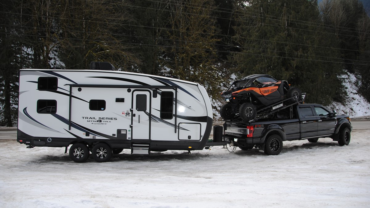

Possible option 1:
SxS bed rack
Replace 35' toy hauler with 25' bumper pull trailer around 6-7klbs
Has anybody hauled a setup like this? Looking to get the SxS camping & get a camper that is nicer to tow. Does the balance with a 2 seater SxS on a bed rack & "half ton towable" type trailer work out for a 1 ton SRW truck? I can definitely crunch the numbers, but there are a lot more unknowns with this setup than I can easily calculate compared to normal trailer weights (even considering most dealer weights are lies).
I think I will be close on the rear axle ratings with about 2,000lbs of side by side & ramp plus 5-700lbs or tongue weight. But a WDH will help shift some of the weight up front.
Basically a setup like.
Pro:
  • Towing a reasonable length "1/2 ton towable" trailer with a 1 ton will be a breeze
  • Can easily load up the toy on the truck if I can't drive it to a trailhead in camp
  • Could fit a 4 seater SxS on the ramp of we upgraded from our 2
Con:
  • Some effort required to load the toy on a steep ramp
  • May be a bit heavy combining toy weight & hitch weight

I have no personal experience doing this.
IMPO, setting aside increased wind resistance and raising the center of gravity, if that 1,400lb side by side were to roll backward off the ramp on the back of that truck, the first thing could be to take out the front end of the camper.
IMPO, I wouldn't want to be the guy loading the side by side that far off the ground onto that ramp, either.
Another option might be that the next level of truck chassis could make for a better towing experience with your present 35' toyhauler.

I'm not to worried about the loading & unloading. I've driven the side my side up way worse & steeper hillsides already. To load the toy hauler now I have to gun it yo get up the ramp, then immediately stop it 1-2" from running through the wall. Option B is just hook a winch to pull it up the ramp. Have an old one from a small plow I should toss on the side by side anyway.
Even if I magically could snap my fingers & make the toy hauler pull perfectly it's still not great. We over bought. It's to long to turn around on smaller dirt roads. It sleeps 7+ & there are only 2 of us + occasional guests. Something that sleeps 2 + a couch & dinette would use space better. Also keeping gas & oil fumes out of the trailer will help the wife's migraine issues.
I have thought about upgrading to a duely or F450, but what I have now works well other than this trailer. I hear the F450s turn tighter than the 350, which would be nice though. 1/2" taller, 8" longer & much wider than the F350 double cab short bed & i cant park it in the garage. Not the end of the world, but i like parking it inside. Some of it comes down to I like my truck better than the trailer.

Beware of the ramp on the truck with a pull behind; the picture of the black Ford shows it really squatting in the back... Even with overloads or bags, that truck is overloaded...
