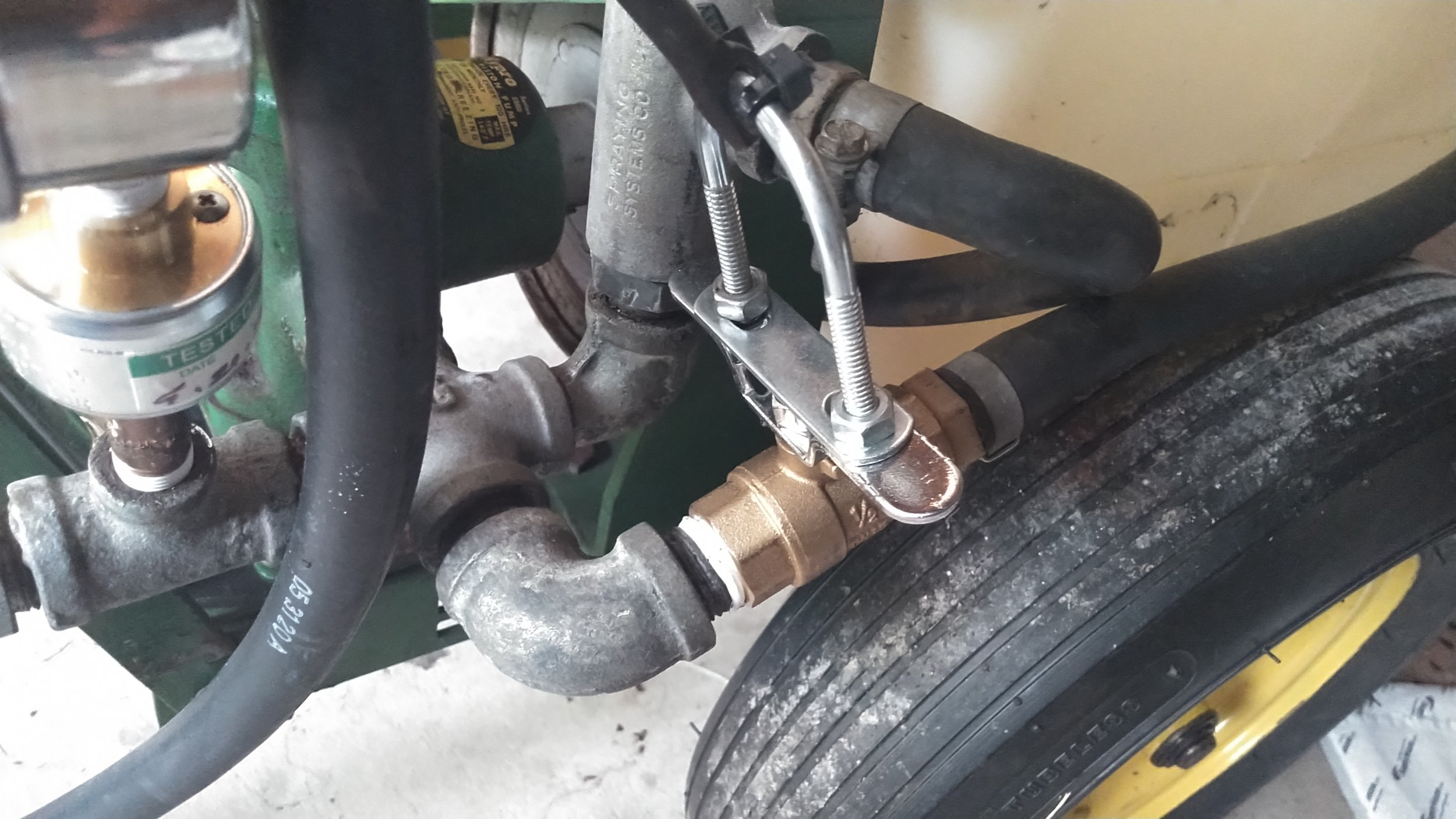

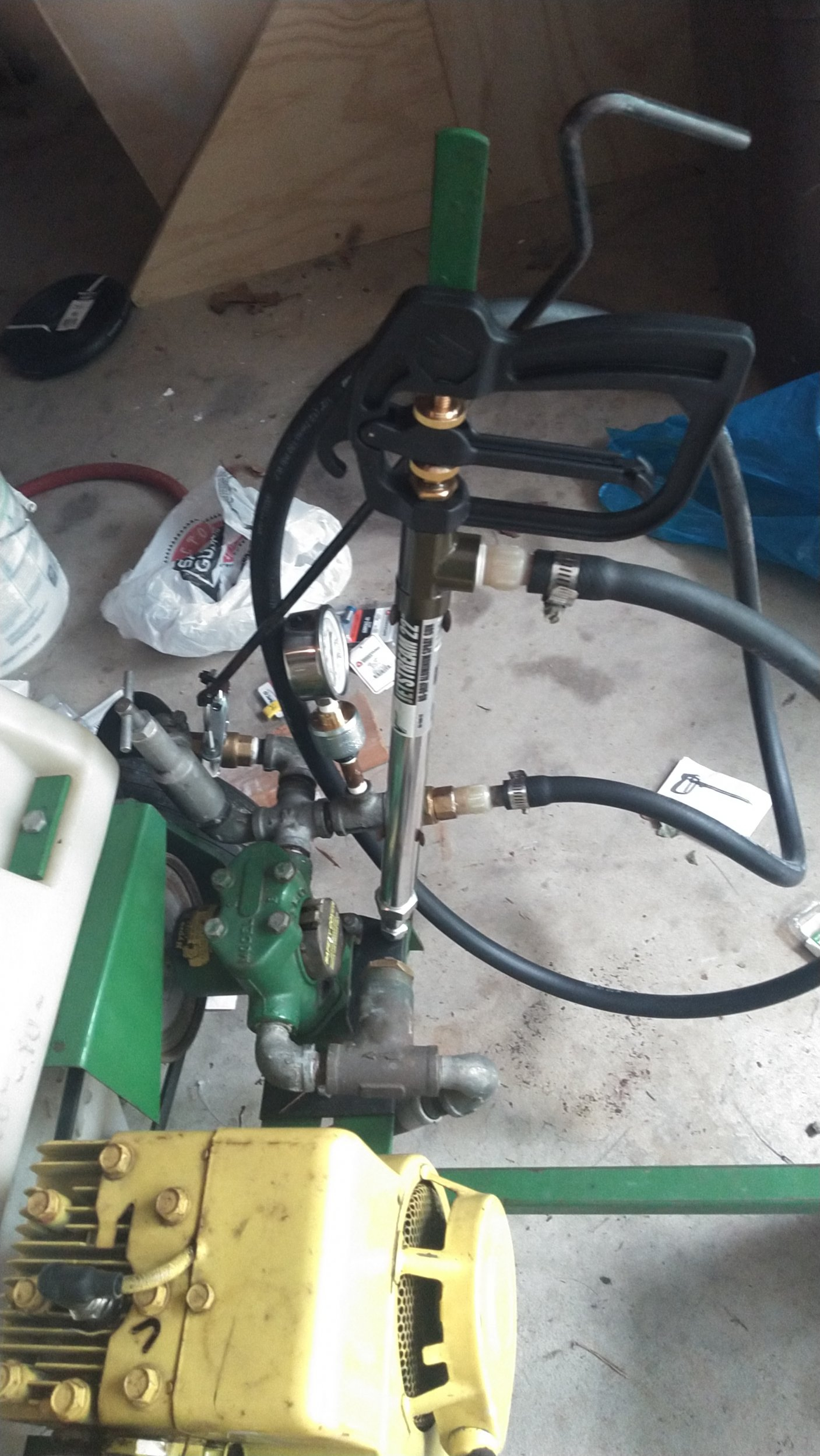

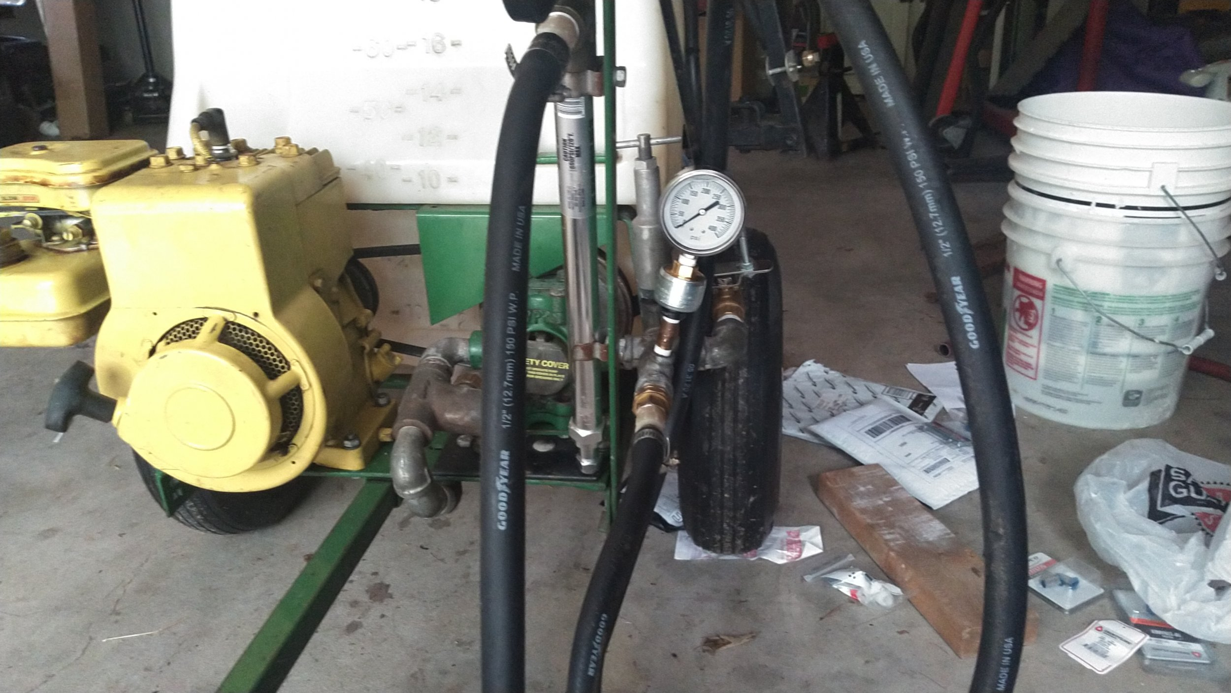

Here's a pic of it with the new spray gun, gauge, isolator.
Boom shutoff "T handle" ball valve purchased from an online plumbing supply house. U bolt connects the original shutoff handle extension to new valve handle:
New spray gun and hose from TSC:

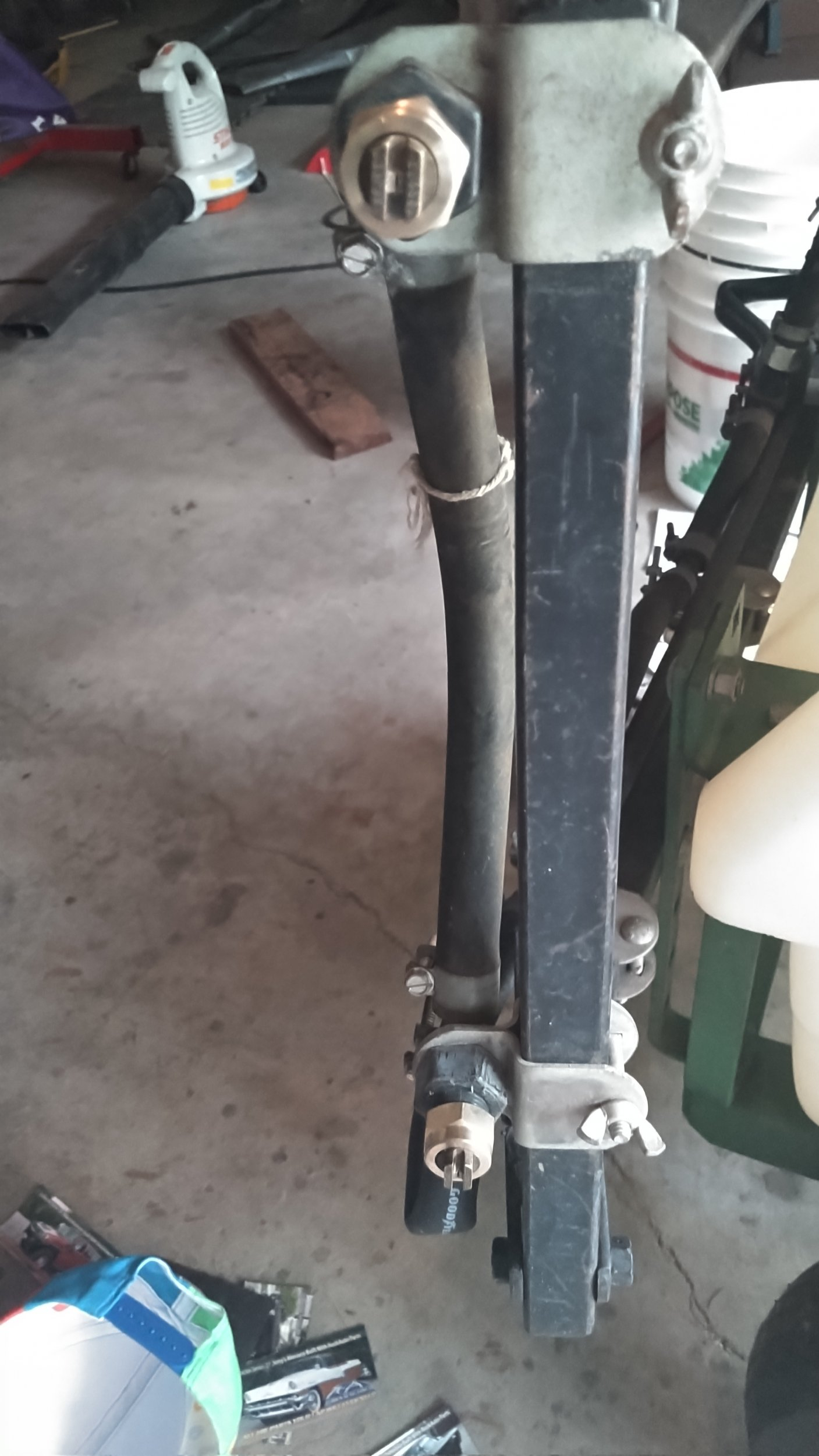

New TeeJet type brass nuts replace the old rusty steel nuts on the boom. Strange that TeeJet nuts and nozzles fit but not the strainer screens:
