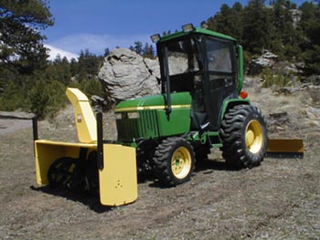

   / 59" Snow Blower #3
Re: 59\" Snow Blower
I have a JD 59" snowblower with all manuals (ops and maint) on my 790 but havn't seen a clue as to the OE manufacturer. However keep an eye on Ebay, as I've seen a few of them go fairly reasonably. Keep in mind although the snowblower main unit is the same for the 42-4400 series and the 790, the front Hitch Kit and hydraulic connectors are different. The snowblower is built very well and takes only about 3-5 mins to put it on and off (easier than the FEL)!
You'll need some weight in the back (wheel weights and something hanging off the 3pt) and may need chains if steep. I use the rear blade for smaller snowfalls. I strongly recommend a cab (even a cheap one).
