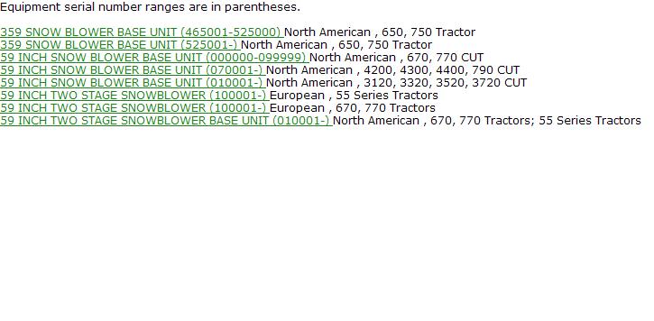

From the Deere site, doesn't look like the 950 is a tractor it will fit... but may have something built to accomodate.
I thought the 59" blowers were driven off the mid PTO.
Don't know if this will help. May be an indication what the 59 blower fits.

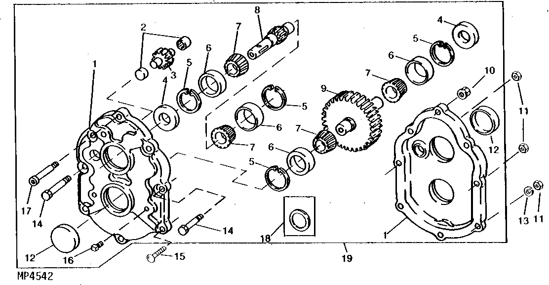

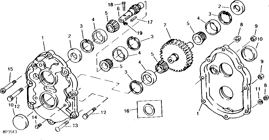

You should have compared the gearbox to the 55/70 series while you were at deere's site, its listed right there.
Anyway, both use the AM39363 Gear housing. The 50 series uses a M84788 15 tooth input gear(8) which, as near as I can tell, turns a 19 tooth idler gear(3). That turns the same M84790 50 tooth output gear(9) as the 55 series.
The 55 series just uses a M86075 19 tooth input gear(6) to a M84790 50 tooth output gear(7).
This means a 359 blower for a 50 series will turn over slower and in the opposite direction. Having never been inside the gearbox for one of these, actual confirmation of turning the shaft is better than taking my interpretation of the parts book. As a side note my brother also just bought a 359 but hasn't got it home yet, could be a surprise for him:confused2:
If its a really great deal the M86075 shaft and gear (6) can be had for $150 -same bearing and seal.

thanks for the info. i tried to compare the drawings, but was having a bit of problem fitting enough stuff on the screen. then i had the brilliant idea to PRINT them. now i can see what's going on.
it looks like there are (at least) 3 different gear cases. the 59, 359/50 and 359/55 all list a different #. the 59 and 359/55, supercede to the same #, but not the 359/50.
i didn't (tho i SHOULD have) pay attention to what direction the the impeller turned when i rotated the pto. i guess knowing that will tell me which version of the 359 blower he has. tho, being the belt drive, i'm thinking it is the backwards one.
with 3 different gear case #'s....i guess that there is no guarantee that the parts will swap, but i see what you mean about swapping the input gears and removing the small spur gear.

The gear housings are all the same, its the complete gearbox that has a different part number because the gears inside are different.

Tim, after reading your response, i rechecked my parts drawings...and you are correct. i missed the fact that they listed the 'housing' separate as the 'gear case'. i presumed the 'gear case' was just that, the case, not the entire box! both models list the same # for the 'housing'....so i do believe that the gear swap is entirely doable...$160 for the gear, $14 for the seal.
thanks for setting me straight.
