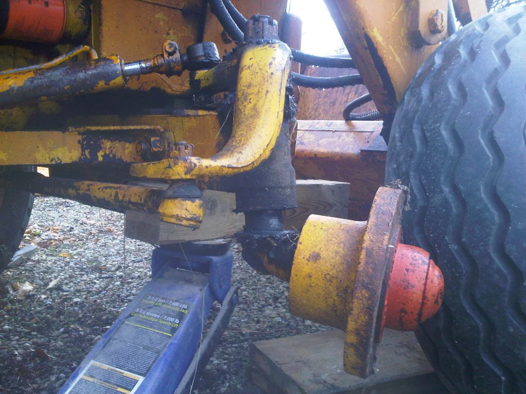

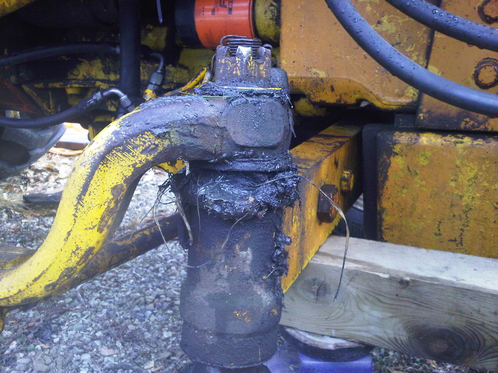

Can you see what is wrong with this spindle. Is there a spacer missing?

there should be a 2 thrust washers a thrust bearing and a needle bearing under there

/ 580 B Case Front Spindles
Thanks, I"ll have to go get some parts.
