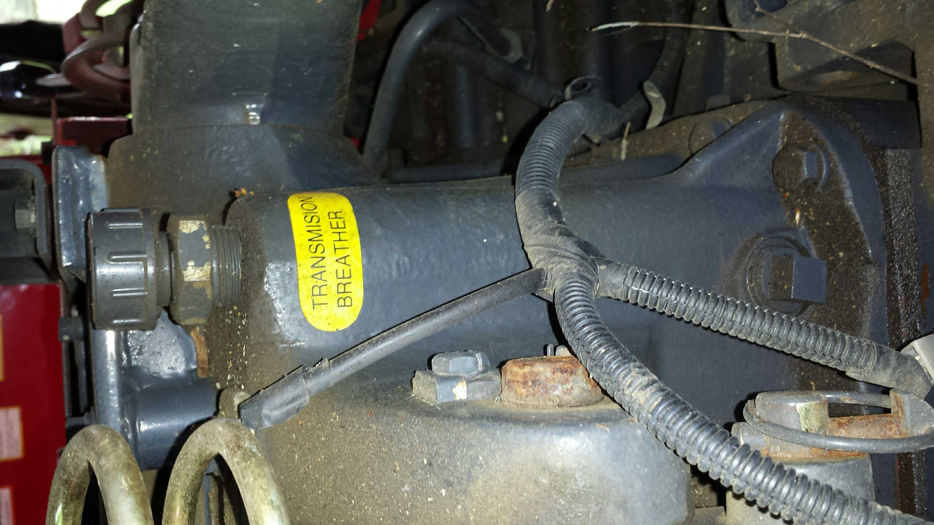

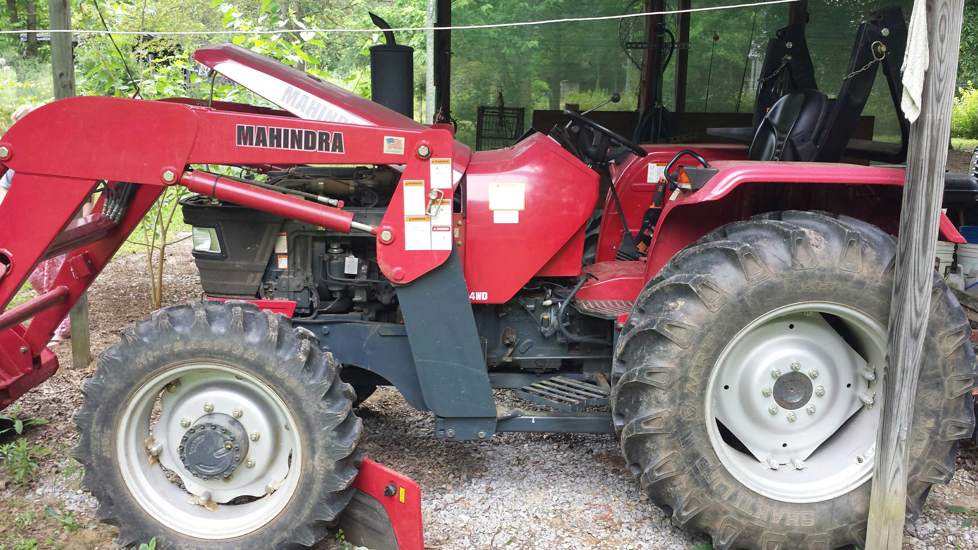

1464458607176.jpgcan somebody tell me where the transmission level check is on here and where the add fluid hole is. Thanks
/ 5530 trans dipstick location #2
Got a photo from the back side? Not sure of your model, but just behind the seat, is usually the filler hole...

1464462151316.jpgguessing this is the filler hole. Where do you check the level. I had a synchronizer line dripping and fixed it just wanna check and see how much ran out

Look just under the clutch pedal for a long hex nut that's angled out of transmission case. It screws out and has a dipstick attached.
/ 5530 trans dipstick location #7
in the first pic, it is the long hex that has yellow painted on it.(that's the check point).
the breather in the back,(your secound pic ) is the the fill point.
nice looking tractor.
Ok thanks guys lol i kept looking at that hex nut earlier but i was like nah its gotta look like the oil dipstick.
