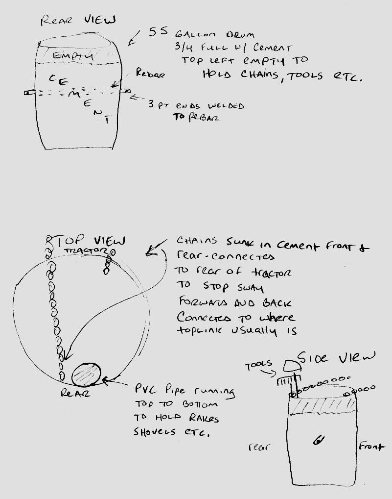

I saw a post awhile back about using a 55 gallon drum for a weight. other than that I don't remember much.
This is what I am planning on doing. I was goign to buy 2 -3 point hitch ends ( $2.99 at JD) and weld them onto rebar that I will drive through the center of the drum (standing up). I will also place a 4" pvc pipe standing in the drum from top to bottom. I will fill the barrel 3/4 of the way up with cement taking care not to get any into the PVC pipe. When I get almost 3/4 full will place the ends of 2 chains into the barrel at the front and rear. I will use these like check chains to hold some weight and stop sway of the barrel front and rear. The empty PVC will hold long tools like rakes and shovels. The top 1/4 of the barrel will be empty and can hold my tools, lunch, chains etc.
Paint it JD green and I have about a $20 weight box that holds my tools and looks ok
Any ides? How much will this weigh about?

   / 55 gallon drum weight? #2
There's 7.48 gallons per cubic foot, so there are approximately 7.35 cubit feet in a 55 gallon drum. 3/4 full would be about 5-1/2 cubic feet. Concrete can vary by the mix, of course, but it's pretty standard to figure 150 lbs/sq ft, or roughly 825 lbs. of concrete in your 3/4-full drum, plus the weight of the drum, rebar, 3 ph pins, chain, pvc pipe, tools, and other stuff, and, of course, your lunch. Don't know if you're a heavy eater, but that sounds like 850 to 900 lbs.
Tractor is rated for 815lbs 24" back from the 3pt arm ends so it should lift 900lbs. just about centerd at the 3pt ends but I will scale back slightly to around 700lbs. I don't think I need anymore ballast than that so why make the tractor lug more than it has to.

   / 55 gallon drum weight? #6
How much does your rear mower weigh? You might scale back to a half-barrel of concrete, about 550 to 600 lbs. On a light tractor, that should be enough - it would be for my TC18. The weight would be lower which would be safer. And, you can cary a bigger lunch. /forums/images/graemlins/grin.gif
It ways about 550 lbs but it is hung way out there so I thought 700 right behind the machine might be the same balance. Even with the mower lifted high and nothing in the bucket the tractor seems very well balanced on rough terrain.
I could try 1/2 a barrel and always add more, perhaps that is a solution.
   / 55 gallon drum weight? #8
Suggestions?
If you have a concrete floor in your storage shed, mount four heavy duty swivel casters on the bottom, so it is easier to roll it around for storage (and makes it easier to get it on the 3-point).
Additional PVC tubes could store chain if you put the grap hooks over the lip of the pipe or the drum.
Put a couple additional PVC pipes above the concrete to make shorter storage tubes.
Drainage holes in the bottom so any water will not accumulate between the drum and the concrete, nor at the bottom of the PVC pipes.

#9
Good ideas I will use the drainage holes and the extra PVC. i already have aheavy duty dolly i can put it on.
