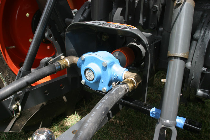

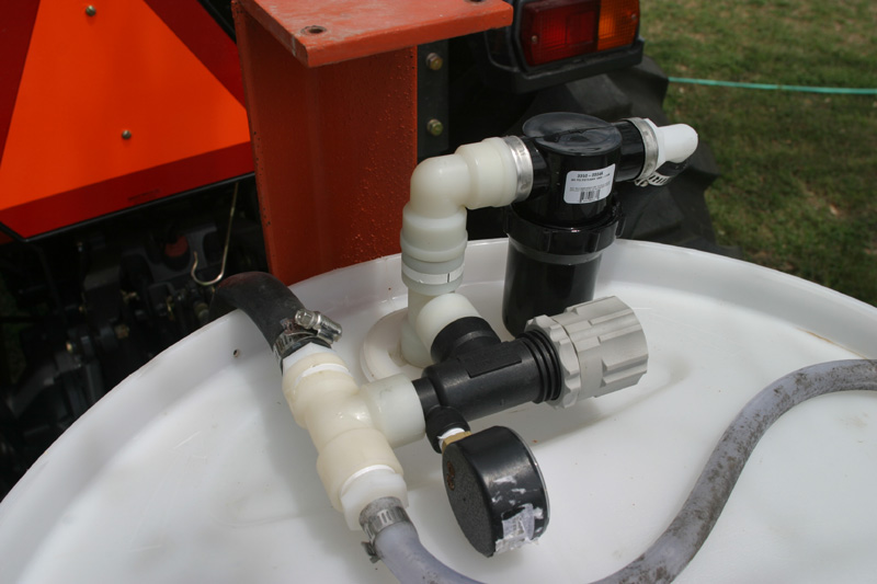

Here are some pictures of a sprayer I made last year. Purchased the roller pump, regulator and spray wand at TSC.
The rest of the nylon fittings were purchased at my local harware store. I mainly use it to spray fence lines. I first used a Shureflo electric pump (you can see the base I mounted it too in the pic), but that wasn't powerful enough. The roller pump can produce up to 200 psi with the tractor idling! I usally spray at 125 psi.

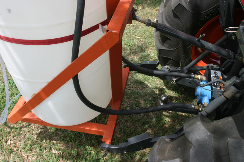

I used high presure hose to connect to the roller pump with regular hose bib connectors. Very easy to find and no tools needed.

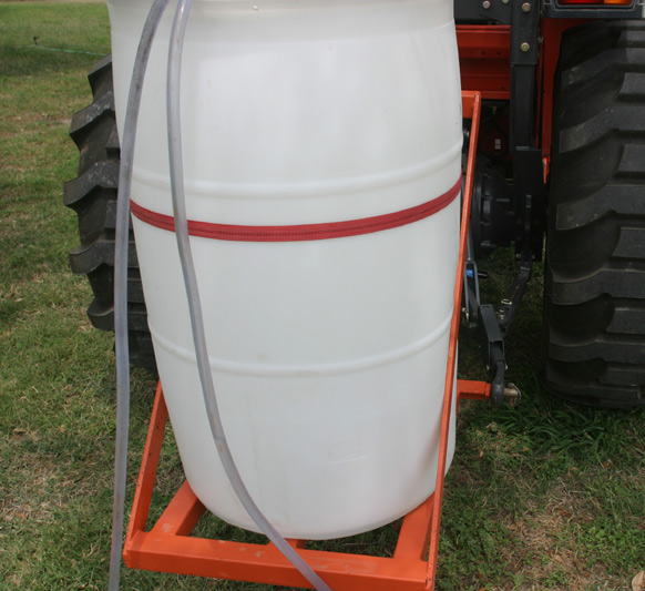

Made the cradle a little less wide than the drum for a snug fit.
Drum is secured by a single nylon strap.

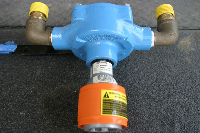

Used two street ells with hose bib adapters for easy hookup.

The pump has "FLUSH WITH OIL AFTER USE" on it, so thats what I do. The caps keep the oil from draining out during storage.

</font><font color="blue" class="small">( FLUSH WITH OIL AFTER USE )</font>
Yes sir, and if you store it with oil, or antifreeze, in it, it'll last for years. If not, it'll corrode and be hard to turn after awhile. That's a real nice looking setup you have.
