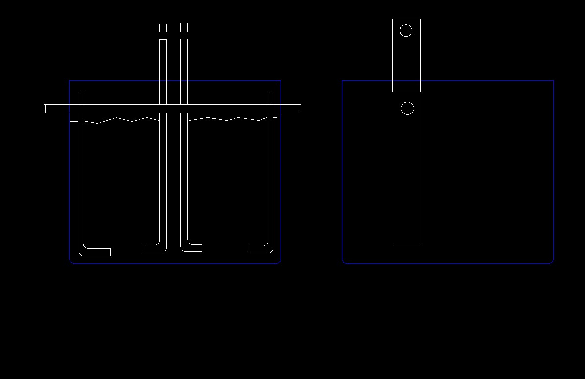

Looking for comments/suggestions from your experience in making a ballast for FEL from steel drum and concrete. Thanks. meangreenmachine

I have a cement filled beer keg for my tractor. It is fine for small bucket loads. It needs to be twice the size for heavy loads. I would think the 55 gallon drum would work out well for a large tractor. You will need to have the 3ph hookups integrated into the barrel somehow. The lower drawbar can be put right through the barrel. You may need to extend the length of it. The top link will need to be strapped around the barrel. I would think welding it to the barrel might not be enough to hold it on with a full load of cement. My farmer friend has a large block of cement that he just poured into a wood frame. He inserted the drawbar through the wooden frame. The top link bracket was welded to the drawbar using a piece of steel to keep it in place. Then he poured the cement into the box. He removed the wood after it hardened up. I think it is about 3' x 3' square.

A full drum of concrete could weigh 950#. Make sure you want that on your 3-point. You probably would want check chains to keep the weight off the lift.

Put the lower bar thru the barrel, and put two 1/2" x 2 & 1/2" steel flats thru the barrel for the top link. Put some rebar thru pre-drilled holes on the cement side to keep them from pulling out. If you want to be clever, add a square tube reciever hitch out the back of the barrel. Weld it to the bottom bar and weld the back of the tube closed (to keep the cement from getting out). It's nice to be able to tow stuff and not have to remove the weight. I also agree on the use of check chains.
Make sure that you position everything so that you can put it on the ground using the 3pt. BUT (!) be sure that with the arms up, the bottom of the barrel is 5-6 inches higher than the bottom of the axle. Otherwise it will rub on the ground going up hills or onto a trailer.

Thanks to all for your comments.....Tractor is JD 4310 with 73" FEL. Manual shows JD Ballast box and ballast box extention with ballast weight reco of 1200 lbs so I'm thinking that if I can get around a 1000 lbs with the barrel/concrete and a 3 pt. quick hitch I should be OK....Do you agree?? (All tires are loaded with methanol). The 3 pt has an adjustable linkage which serves as check chains to limit side to side swaying. Seems to me that JD would not give the 1200 lb ballast spec if the 3 point lift/linkage were not able to manage it well. Do you think I'm wrong here?

Check chains are attached to the tractor, usually in a top link hole, then to the lower arms. They are used to hold up the weight of the implement or to hold the implement at a set height. They were very popular on older tractors that would leak down over time and not self correct. A JD 4310 is a good modern tractor and has specs of about 2000# 3' behind the arms. It shouldn't require chains to hold the weight. Will chains help the tractor last longer? maybe. Is it worth the trouble? dunno.

I would think taking a metal barrel - poking some slots/holes in it and inserting the attachment points - welding on the top link and draw bar for correct orientation for the quick hitch - attaching rebar to them on the inside - then pouring the concrete to "hold it all together" should be fine for keeping things together for the long term. Then you can paint the barrel that green color you like so much - and have a quick hitch ballast box.

Here's what I built. It weighs 500#. Mine was for a quick hitch, but a regular will look much the same. Everything is made from 1/4" x3" strap and round bar stock. Make sure the horizontal bar is offset enough that the drum doesn't bump into your drawbar!

Here's where I end up: Will use 55 gal plastic drum (bright yellow if can find to match JD yellow wheels). Will insert drawbar through barrel at height to give good clearance to barrel bottom when 3 point is full up. Will weld top link steel to drawbar that will be centered directly above the drawbar. Height of top link pin will be set to match distance on 3 pt quick hitch top link hook. Will add some rebar to concrete mix. Hold on....it just struck me that the three point lift may not go high enough to engage the top link at the top of barrel and still provide adaquate ground clearance at barrel bottom...gotta do a little more investigating.

I think you are going to find that the top connection will end up below the top of the barrel. Unless of course you have a large tractor. You could notch out a section of the barrel for the top link and make a wooden box to hold the cement back.
