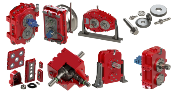

more examples,
PLUS, tell them the Ag color you need and they will match it to your machine !

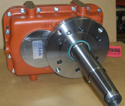

Speed increase unit example,
