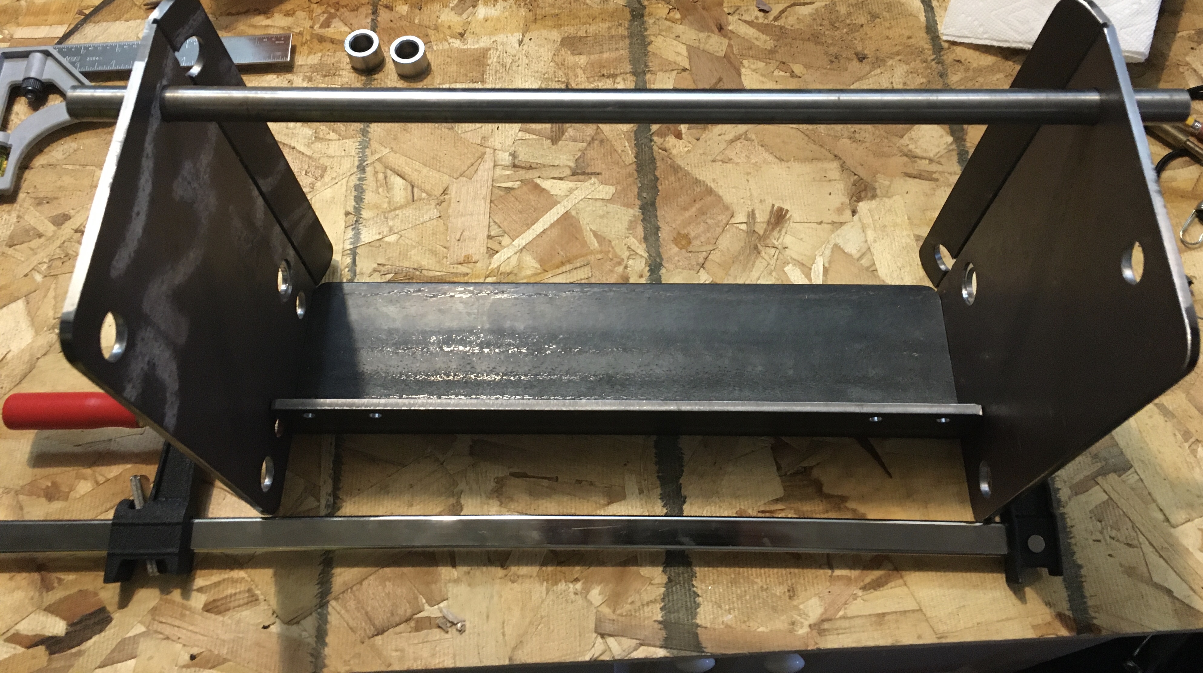

Can anyone answer me this.. The ends that are bent inward, are they making contact with the quick hitch or are they to simply help guid the support piece into the hitch? Wondering if they serve a purpose...and also wondering where all the pushing pressure is centralized?
/ 54 quick hitch blade #25
They simply guide the installation process.
The pushing pressure is on the pins.

Morning. Been feeling under the weather boys and girls, so the fab is on hold... Wife was sick, then daughter, and I致e been fighting something for a while now, thought I was gonna pull through unscathed, but i think it finally overcame my defense system. Anyway, between that and the fact that we picked up @ 3-4 of snow last night, I知 limping along with this project. Thanks for the info ovrszd. Wanted to make sure the bent ends, up against the hitch, weren稚 the force behind the all the pushing. I have not installed the lift attachment yet. Only the mounting bracket. Still have the loader on her. One last question if I may, that pivot pin, is it sloppy in there or pretty tight. I知 sure there痴 a little wiggle room, but I have a .750 gauge pin and it seems to be a bit to loose. I also have an .812 thats just a tad to big. So I知 wondering if it痴 somewhere in the middle of those two or is it a 3/4 diameter and sloppy..?
/ 54 quick hitch blade #27
I assume you mean the bottom pin that attaches the bracket to the moldboard? It measures 3/4", fits loosely in the hole. It's the pin that the moldboard pivots on if it trips.
#28
Yes! You would assume correctly. Surprised it痴 that loose..guess I could always turn something down or just use a3/4 rod, readily available at that size! Thank you.
/ 54 quick hitch blade #29
Are you going to allow the moldboard to trip?
If so, you need a bit of wiggle room so there's no binding.
without taking mine apart to measure, I'll guess the holes are 25/32".
#30
Oh yeah. I definitely want the plow to be able to trip, so I Had planned to leave some wiggle room in There. I have a 25/32 (.781) plug I made at work to see how well that fits. I was curious and just thought the .750 gauge went through that pivot hole way to easy. Kind of like throwing a hot dog down a hallway... when I get home, I値l check the hole with that plug I made and immediately after, go lay down. Wife says she wants a workout and will shovel the driveway. Have at it hon!! I値l be napping/healing. Ha!

Here is the semi finished product. Still have to paint it and hoping to this wknd! I do have another question...I知 wondering how much the bracket should swing on the plow pivot pin when it trips? 90* to the plow? Less? More? There are pics of the situation I have. You can see where the bracket is very close to the backside of the plow, then I used my hand grinder and took away some steel to add some clearance. Since that, I致e been able to swing the bracket Much further back, but should I add some additional clearance? Thanks

Sorry... there are a second batch of pics. I had trouble adding them all at once. Once I get some advice on the bracket tripping angle I’ll either grind a bit more steel to allow for that greater swing, or leave it as is and paint.
/ 54 quick hitch blade #38
My blade will trip and lay flat on the ground.
I run mine pinned so it can't trip.

Hey ovrszd! So it does swing all the way back. Ok. I’ll grind the rest off today and paint! 60* here this wknd in New England! Good day to get stuff done outside!
