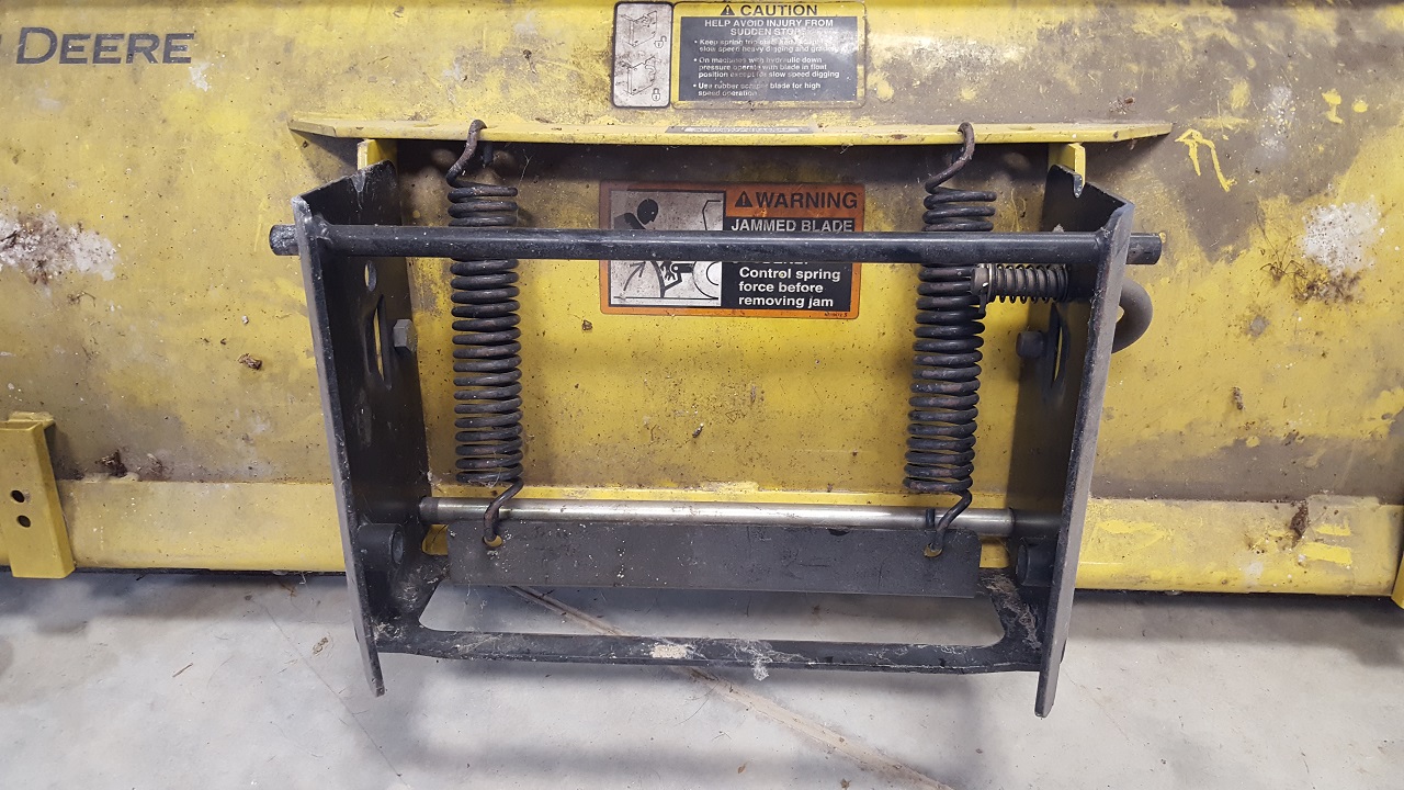

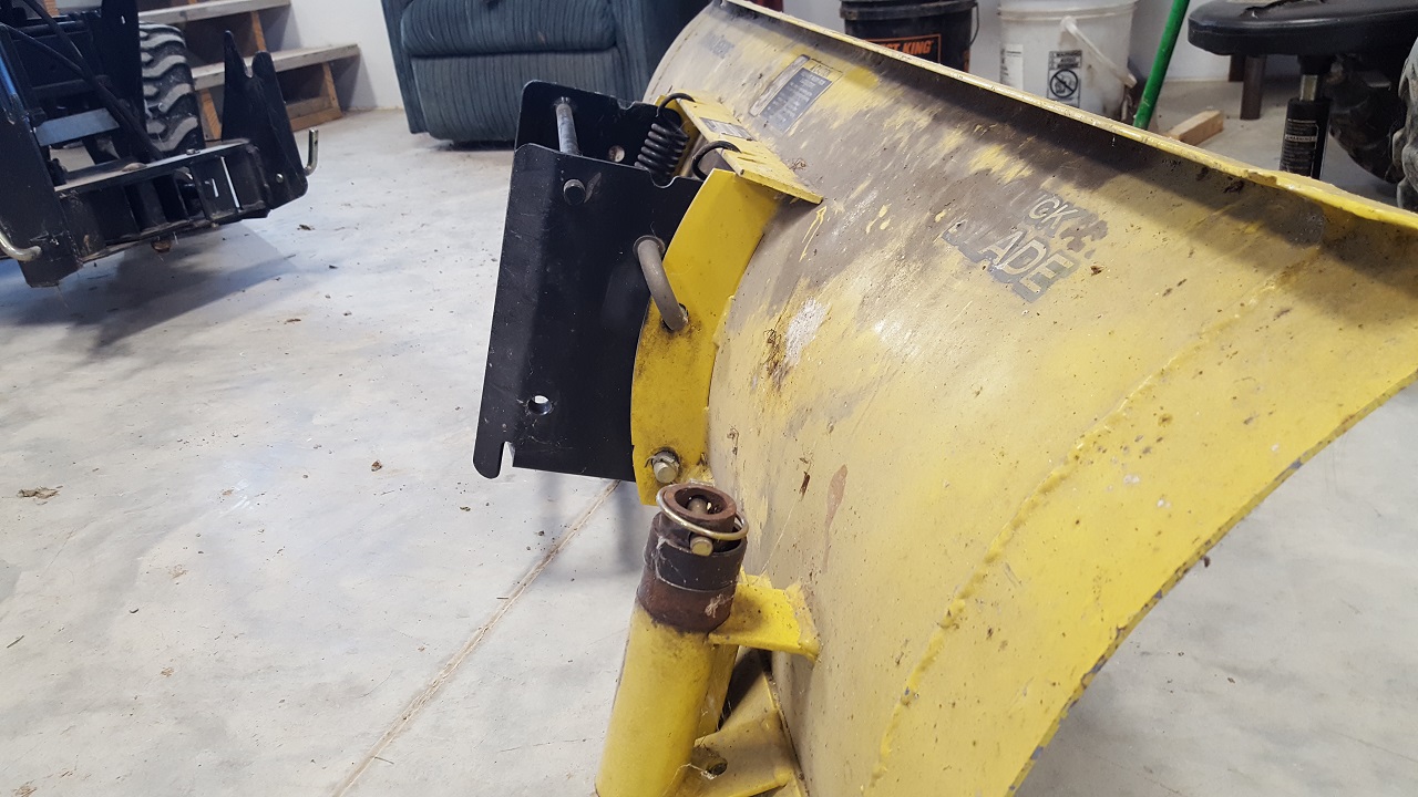

Morning all! I tried posting in the snow forum, but haven稚 had much luck.. so here I am. I知 searching for a print of the blade bracket/support that is on the rear of the blade and attaches to the quick hitch. I can稚 seem to find a used one for sale, and I don稚 feel like shelling out nearly $300 for a new one, when I have access to steel, lathes, milling machines and a welder. So I知 attempting to fabricate one, but could use some dimensions. Does anyone out there have one they could measure up for me or know if there痴 blueprint out there on the internets...? I can try and post a pic, haven稚 had much luck trying in the past, but it痴 part #AM131473. Thanks in advance!!

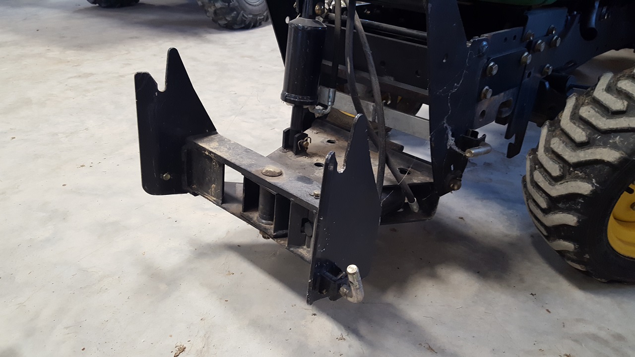

I'm going to install my front blade this morning. I'll get some pics of mine.

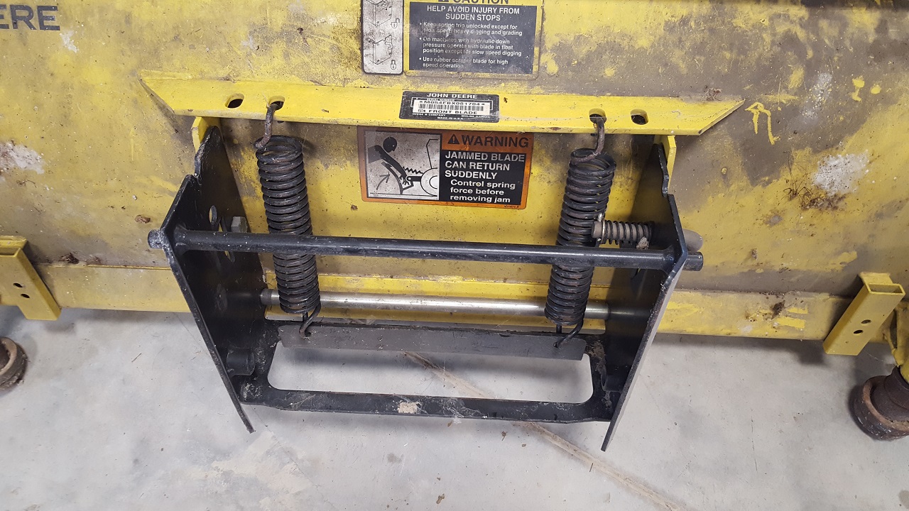

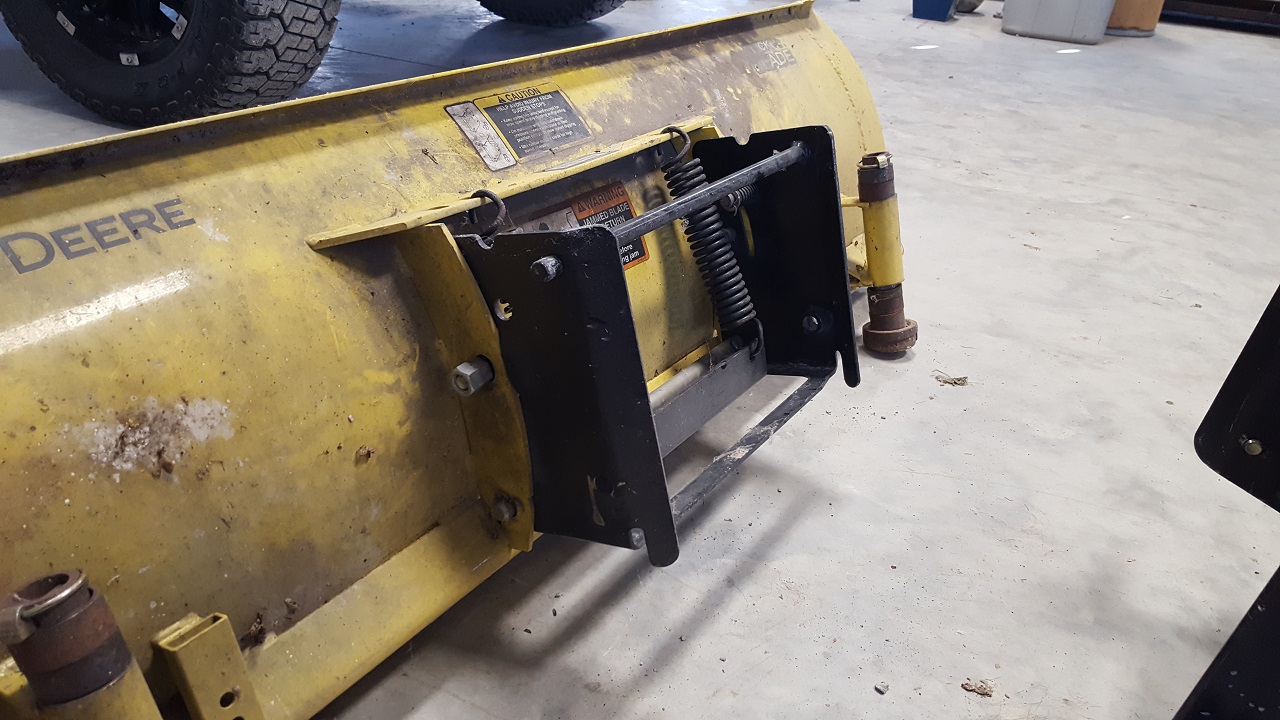

Either one of these what you are after?
   / 54 quick hitch blade #8
#9
Yessss! Top/first pic!! The black steel bracket with the springs. My plow is missing that. I壇 like to fabricate one, but I need some dimensions off it. Hard to find a used one as well and a new one is @ $300. I have access to steel and machines to work with steel...
   / 54 quick hitch blade #10

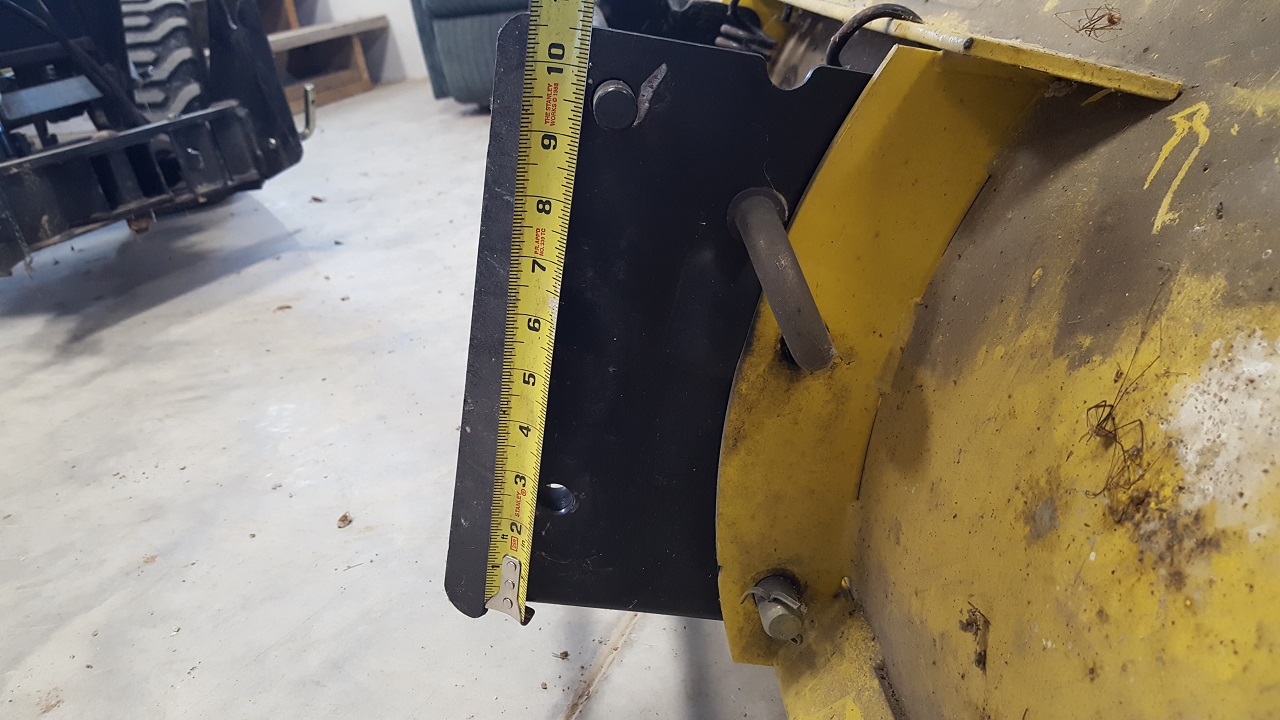

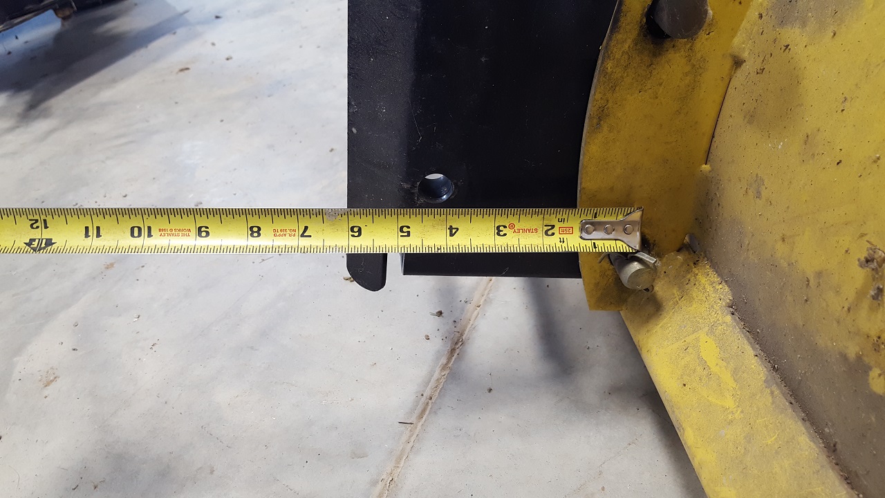

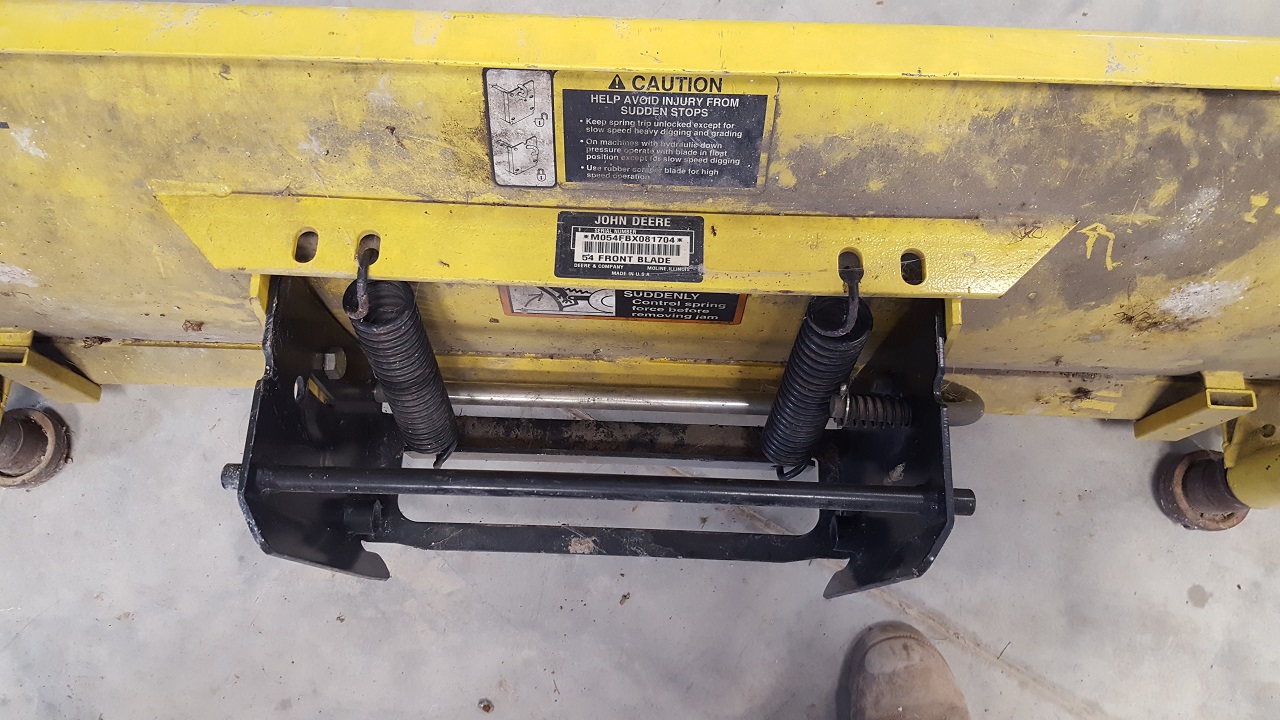

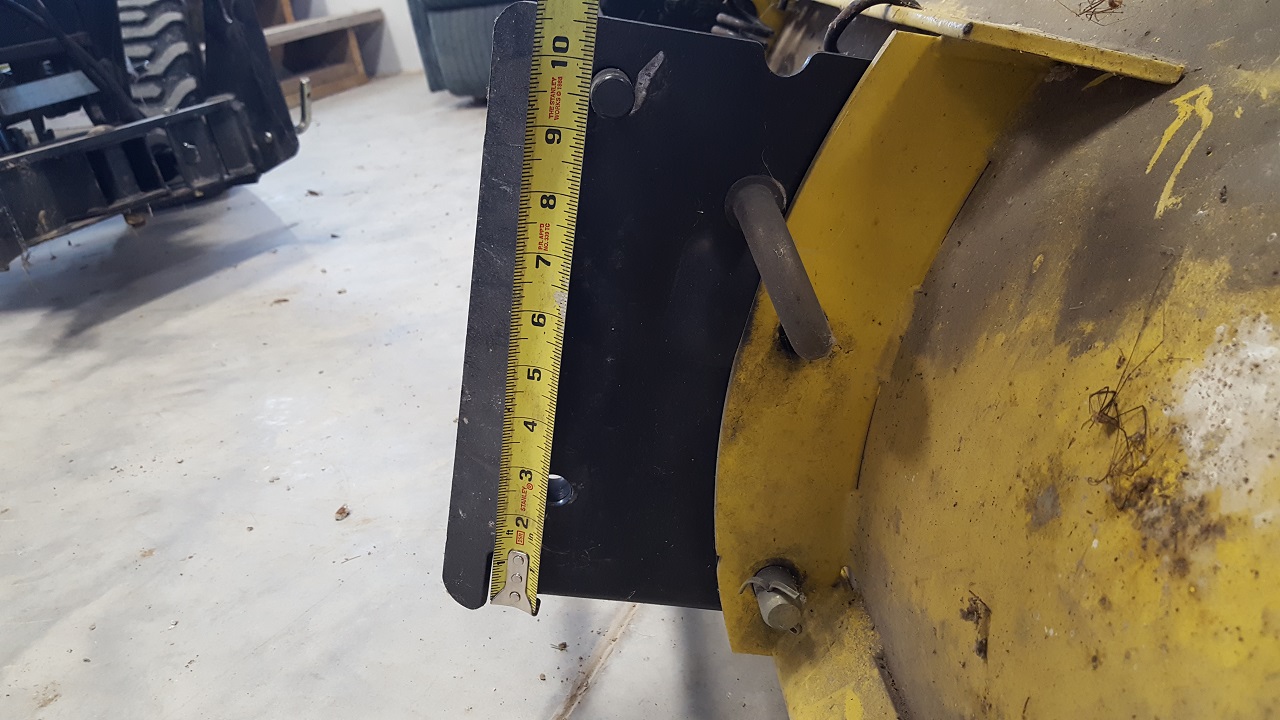

Try these. If you need more data let me know.
