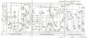

I believe my 5210 wiring is close to, if not the same for a 5320, if yours is the straddle mount.
When you say lights is it all the lights, flasher, work light, high and low head lights? On my 5210 the instrument lights would work some times and sometimes not. I replaced the diode pack RE262484. This is used for the instrument and low beams. If your tractor is the straddle mount, look at this post for the wiring diagram for a 5210. //www.tractorbynet.com/forums/john-deere-owning-operating/223290-need-wiring-diagram-5420-a.html

Please read my earlier thread. I included another wiring diagram, you are going to have to determine if this matches your 5320 model. Your problem could be in the diode pack RE262484 as that is common between the dash lights and the flasher/turn signal. I had a problem that my dash lights would work part of the time once I replaced the diode the problem went away.
The turn signal and flasher is the same unit.
