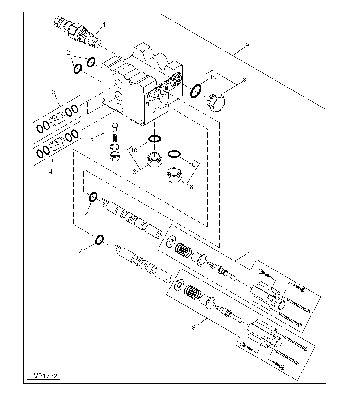

I think I figured it out! The float on my joy stick isn't working. When I push is all the way forward it doesn't float it tries to add down pressure. How do I fix the float on the joystick?
   / 5310 John Deere one way hydrolic attachment stop working #4
Remove the can on the bottom of the valve spool with float and inspect, clean and relube and put back together.
There are little balls and springs in a sleeve that lock the spool in float detent. , so be careful.
You might keep a magnet close by.
When working correctly, the float spool should snap in place and stay there until you pull the lever back to neutral.
There are drain holes in the can, so make sure the holes are down so any moisture can escape.

   / 5310 John Deere one way hydrolic attachment stop working #5
Here's the parts schematic if it has the factory valve.
