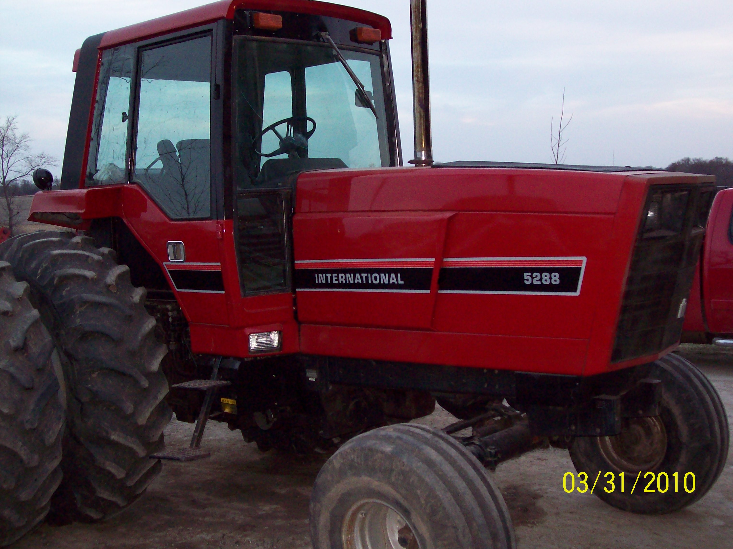

i have a 5288 nice tractor but it is hard to get it into all the gears you have to jamb it into gear , once you get it in a gear it moves , dont think sentry switch
any ideas

the 5088-5488 were the last of the international seris,i have herd that they have had trany problems ,but it may be just rumer ,the tractor works great just purched it from a auction for 6500 with 5000 hours but question if the trany should shift that hard or if the clutch needs to be adjusted ,once and a while it will grind into gear like the trany brake is not working

Just did some looking at Yesterdays Tractors and didn't find much. Was mentioned that they shift better after the oil is warm. Looked over at Red Power Mag and there was 18 pages on 88 series tractors. Sounds like the transmissions were good after updates were done. It's largely the same transmission as the Magnums used with different controls and that is probably the best power shift ever made. The only thing I read there that might be you're problem is that there was mention of an updated lube valve spool that helped with shifting. I by no means read all the post so you should go there and look for you're self and maybe ask for help there.

thanks kim talked to dealer he says to drain all rear end fluids he traced the serial # the tractor came from the nebraska area and it may have the wrong trany fluid in it ,possably to thick for minn area

It sure won't hurt anything (other than the pocket book) to change fluid and filters. I've heard the early Magnums held 35 gallons and the later more like 50. Who knows when it was last done. The lube spool valve update that was mentioned on Red Power was to reduce the flow from 2gpm to 1gpm to reduce the viscous coupling effect of the wet clutch discs. That would be the same effect that thicker oil might have on the clutch. I wouldn't think that there would have been a warm weather oil and a cold weather oil recommended by IH. I thought they used HyTran in everything. Be interested to hear if it works for you.

changed all fluids and 3 filters today wow what a difference it shifts easy no grinding the old oil looked a lot thicker maybe not hytran, hydrolic pump is quit now ,

Was the oil "milky" or off color in any way?
With a power shift trans, plugged filters or milky, greenish oil causes different shift issues. I've never had the issues you described, more of a slow shift, or like the clutch is slipping. The milky oil is caused by water over time getting into the oil and makes it thicker.
You also might want to cut the filters open to see what was in them.

oil was dicolored looked like differrent brands mixed together there was probabely 3 table spoons of water that came out first, filters the one towards the rear was slightly pluged with composit like material on the pre screen ,like brake pad or clutch material dealer says this is comen

People shouldn't mix different oils in a powershift, but they sometimes do. Powershift oil I have been told absorbs water to prevent damage. Some of the discoloration may have been from that. Hopefully this takes care of it for you.

used it hard for 3 days no shifting problems

That tractor looks great! The 50-series IHs are one of my favorites of all time.
