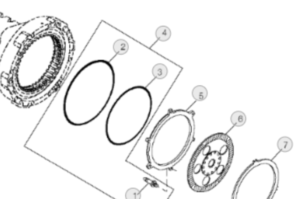

I've had a problem the last few months with my 5220's brakes wanting to stick/drag.
The drag is light enough that it's only noticeable when it comes to a quick stop when you press in the clutch.

This is not what you want to hear but on an older model JD utility tractor with very similar brake system my neighbor had to remove axle housing to R&R springs(key 1) to stop his tractor brakes from dragging. YMMV

I'm looking at the same task with my '99 5210, have bookmarked the pages in the 2 1/2" thick manual for both of our Deeres, have since bypassed the master cylinder when it began gushing oil (return oil from steering) and and needs rebuilt as well. After a few hours of 'can't use the brakes' the housing still warms when operating. I don't need the brakes for much of my use, roading heats 'em up and the drag is obvious, and I had 'er 100% and ready to sell when this went bad. :(
Brake repair begins with removing fenders and ROPS, then one has to muscle-off the heavy axle halves to access brake parts shown in Jim's pic. IIRC there's a 'kit' (part#) to replace the springs in 3s. Not looking forward to the task as a one man job, but I can scan/share pages (steps in order) to share, if finding the info online isn't easy. The only tricky part is in putting the pistons back in w/o mucking up their seals. Details of that are on youtube somewhere.

Is your oil clear or milky? Sometimes when oil gets contaminated with water, it can make brake lining swell and cause dragging. Since you can get brakes to free up briefly after hard application, makes me think linings are swelled. Brake retractor springs can cause problem also, but if there was any history of water in trans oil, I would recommend new brake disks when changing retractor springs.
