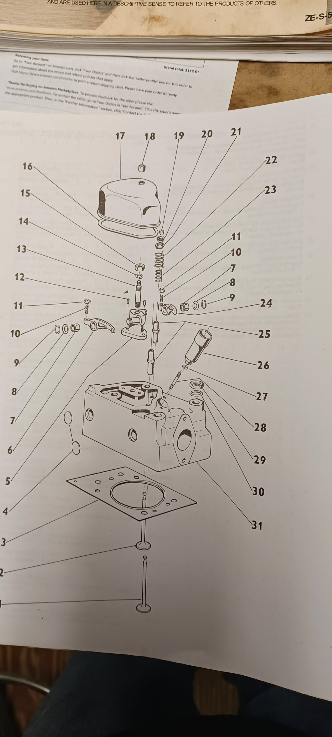

the #3 cyl head bushing/cup is allowing what looks like carbon and fuel to leak where the cup is mounted
in the head, the service manual does not show how to remove/clean and install a new cup, very few Zetor's
here in south ms so doubt a machine shop has any exp with replacing a cup.
anyone have any exp/knowledge with proper procedures on this ?

Looking at your picture more closely, it looks almost like permatex no.1 is leaking out. Have you removed the injector yet? It may not be the cup at all.
