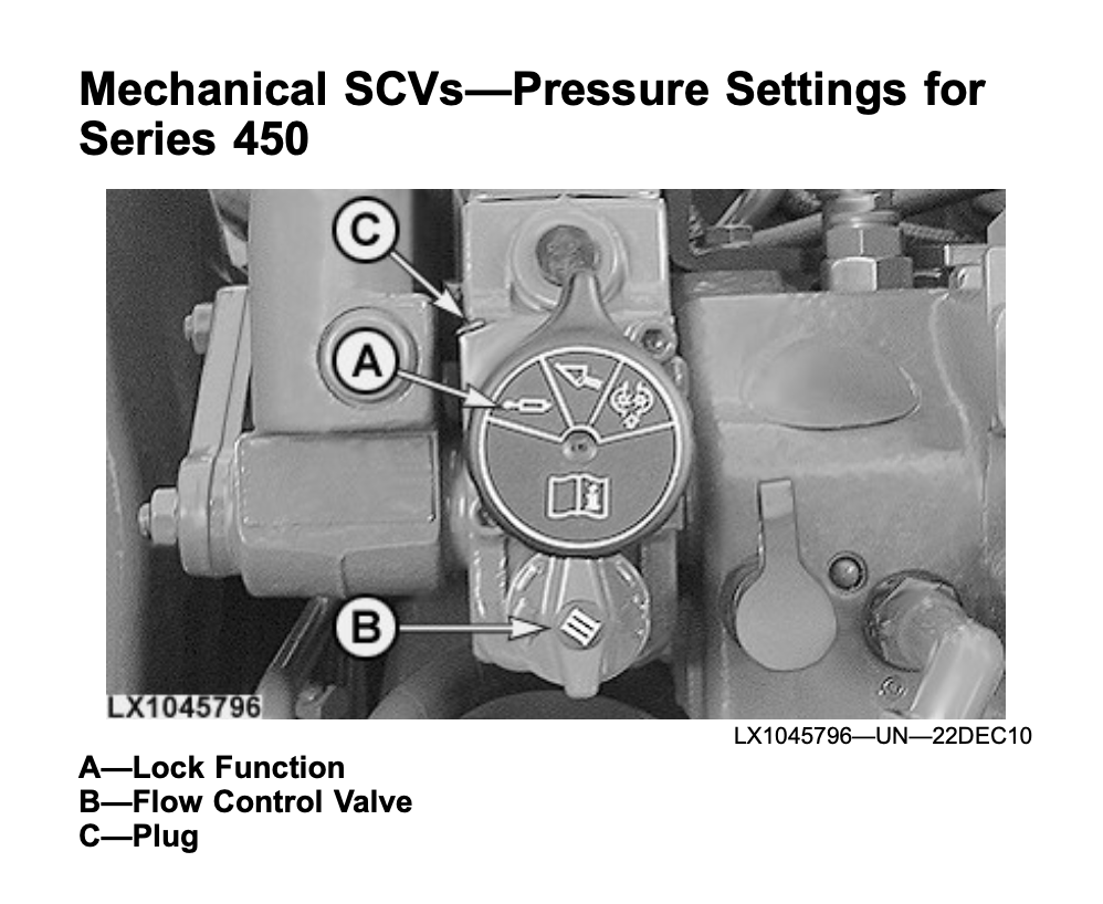

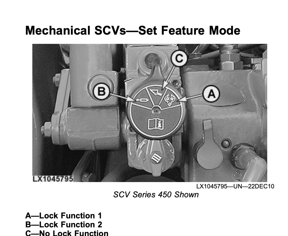

Do your SCV valves in the back have a black knob on the top? It may be set incorrectly for float.
Some also have a flow control knob. If the flow is dialed way down, it will probably cause float resistance.

It does have the selective control valve knob for adjusting one of the SCVs into continuous, no, or automatic and I have tried all three positions. Also, the manual states that "Detent settings affect only extend and retract lever positions, not "float."
I have also adjusted the flow control knob on the SCV bank which should also only affect one SCV and the behavior does not change.
