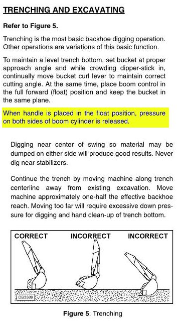

I can't think of any backhoe that I have ever used having a "float" position.
What would you use a float position for on a backhoe?

You use the "Float" for trenching.
Excerpt from the Woods Manual.
