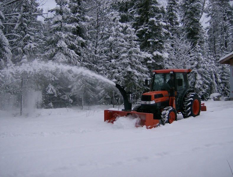

I have a GL4630gstc and will be doing the 50 hr service over the holidays. The operators manual says kubota UDT or sae 80w90. This seems to me to be two very different oils. UDT being a more hydraulic type oil with less viscoisty and 80w90 gear oil being a heavier oil and has the extreme pressure additives for bevel gears. What are others using.

Dutchman,
I don't know about your fluid question, but that's what I call a snowblower!!
