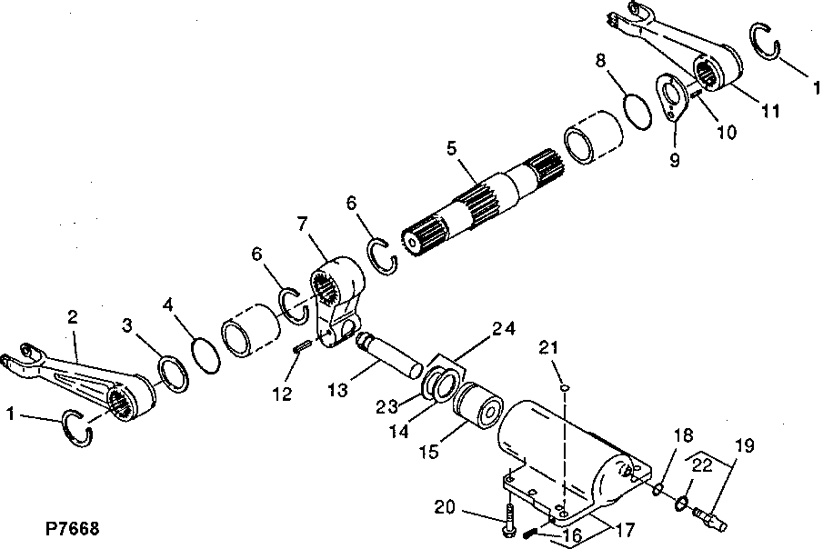

i believe it is in the valve now cause when u raise it up and shut the tractor off it drops to the ground.
Possible control valve(none repairable) or RS piston seal leaking. Also could be thermal relief valve leaking(parts key #19)
If your draft control is incorrectly adjusted it will also do this. Start with the easiest answers first and work up from there and if still under warranty let them figure it out.
Agree with 6dogs. Check the Owner's Manual for the draft control setting. Some manuals will state where to set the draft control when not using the draft function so it does work properly.

thanks again for all the helps guys. the dealer is working on the hydraulics now and it is a piston inside the rocker shaft leaking internally. if the parts come in then it should b finished this week.
