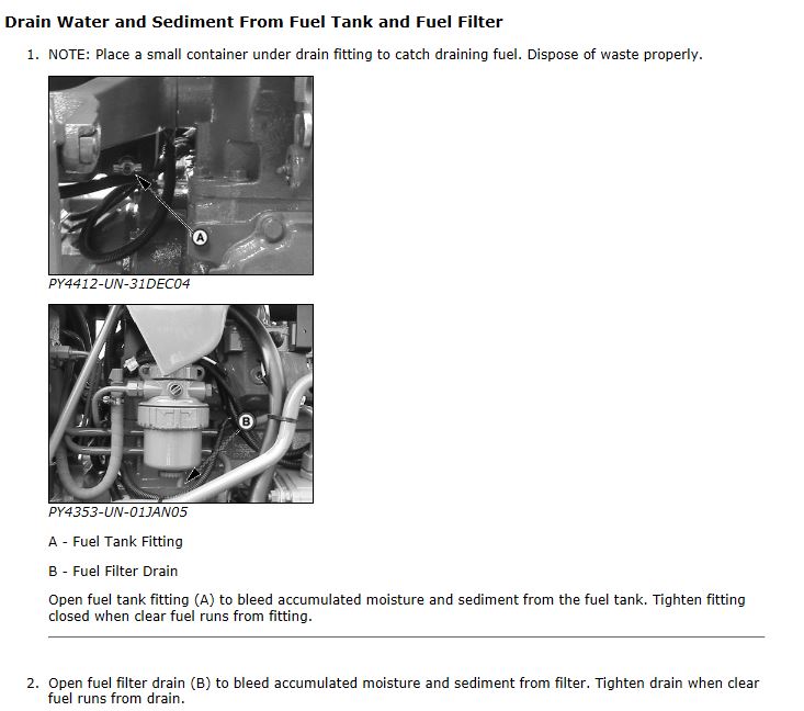

Related question regarding priming a 50x5E series Deere:
When you drain (or bleed off any water that may be in) the fuel filter by opening the port on the bottom of the filter, how does this not introduce air into the filter?
Should you only drain filter with shut-off valve into filter open?

Procedure outlined in the operator's manual. Do you have one?
Yes.
It basically says "Open drain...close drain."
When I did procedure as per manual, I then had to bleed system from filter to fuel pump (removing bleeder screw and loosening return line at fuel pump on the other side of tractor) for it to start again. Basically, bleed everything except output lines of pump. This was not as per manual.
