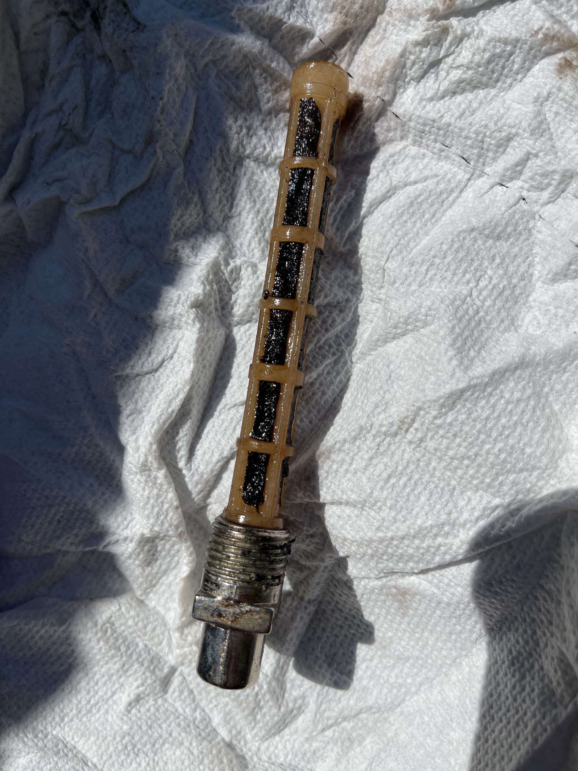

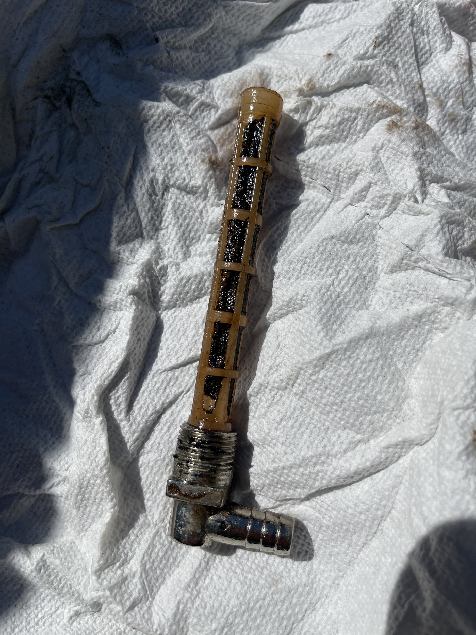

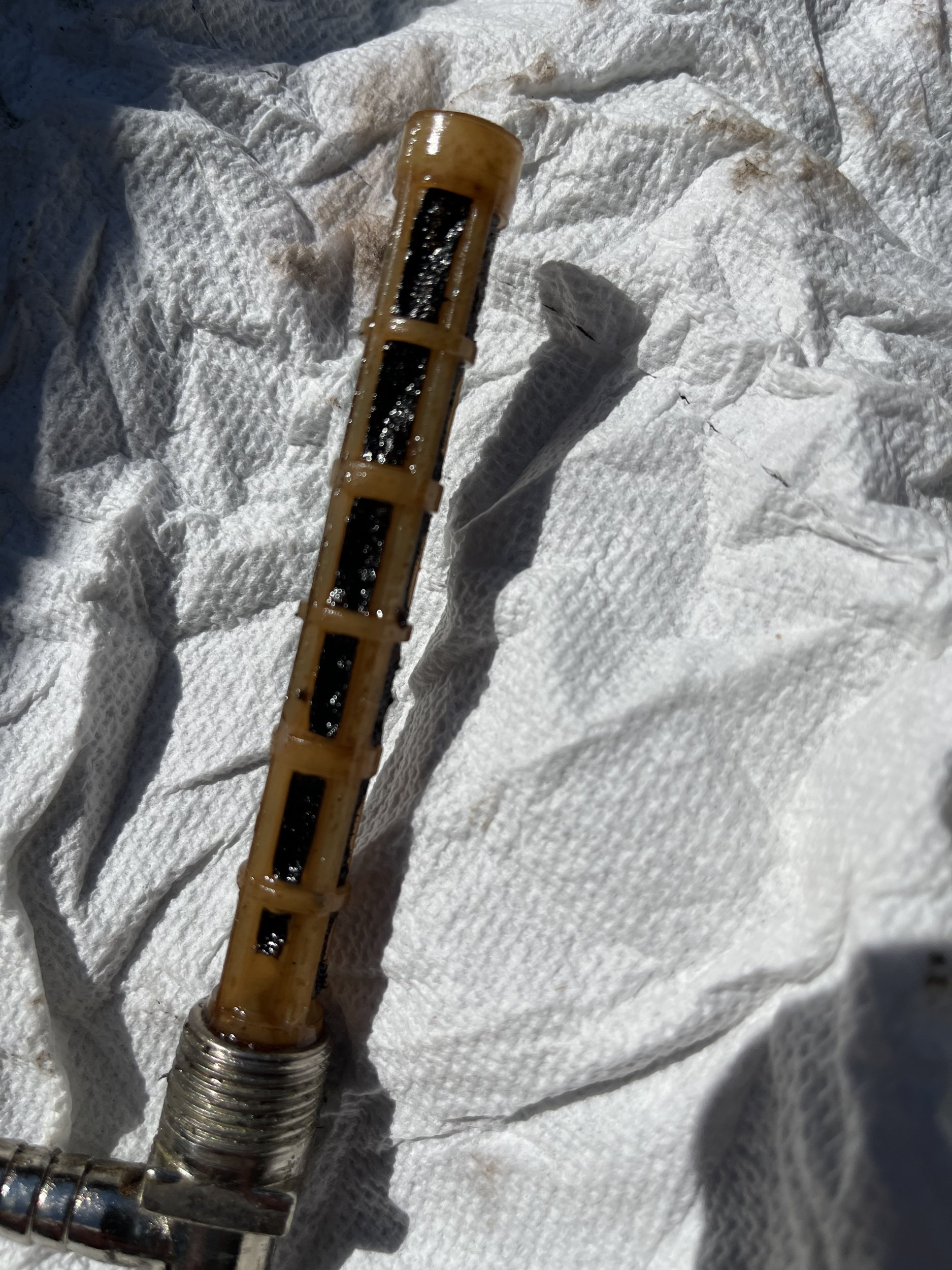

Definitely installing filter kit external to the tank asap. This after having run E-ZOIL Bio-Blast treated fuel since 3-4-20. But to be fair I did not clean the filter and tank prior to starting the use of the treatment. The tractor is topped off with fuel after each use and sits for extended periods under a covered hay barn. Tractor runs fine with the filter cleaned and reinstalled.

Back in March 2020, I was at the local John Deere dealer and asked about the issue with bio growth in the fuel tanks causing filter fouling and fuel delivery problems. The Service Manager pulled up pics on his phone of the black gunk on the fuel supply inline pencil filter as fuel exits the tank. He told me that the ultra low sulfur diesel fuel that we use today has the problem with bio growth due to the reduced sulfur content. That fact coupled with the plastic fuel tank which doesn’t help with condensation due to temp swings creates the conditions that enable the bio growth to occur.
The Service Manager told me how to clean the affected tank if bio growth has already gotten established.

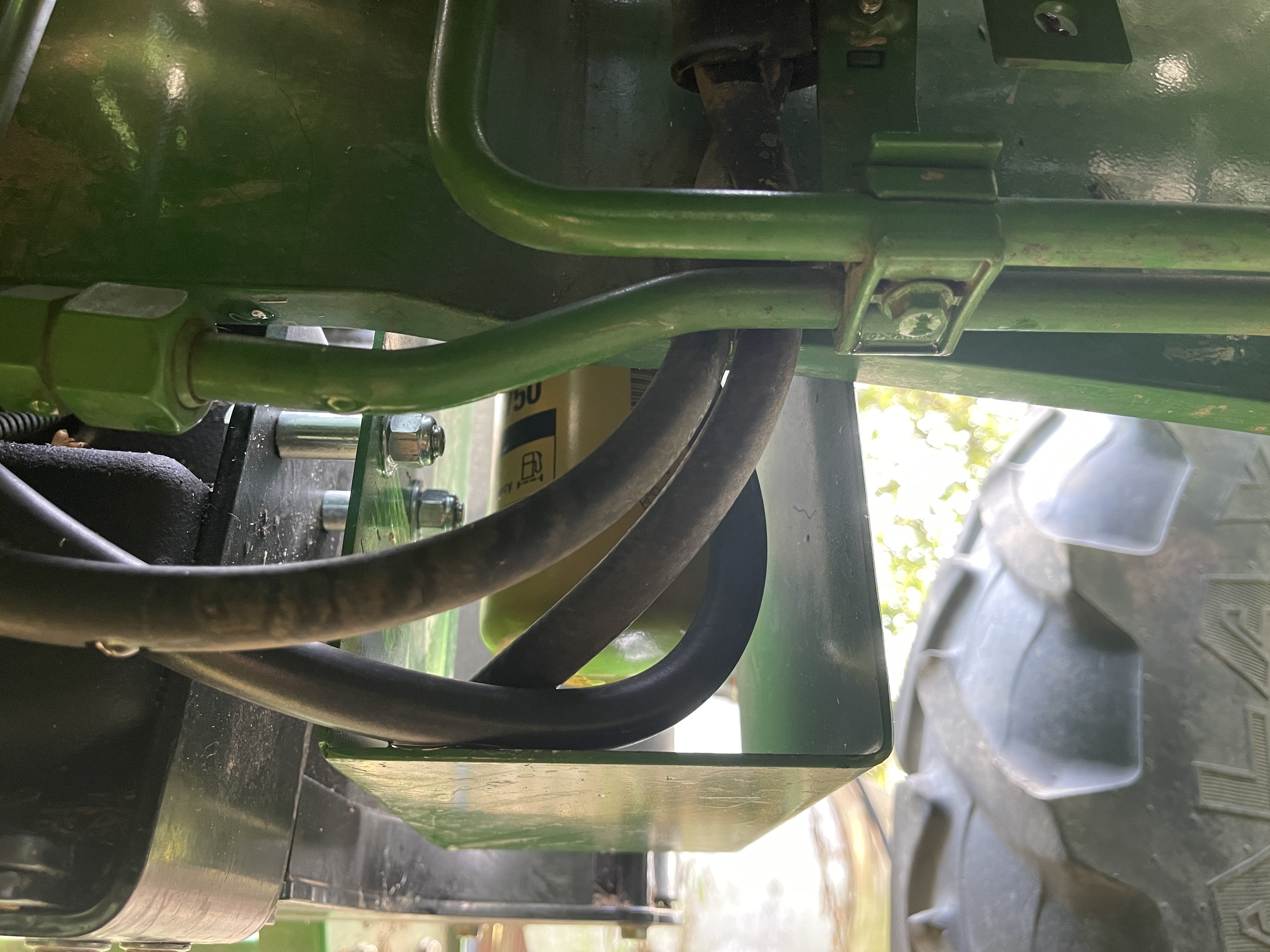

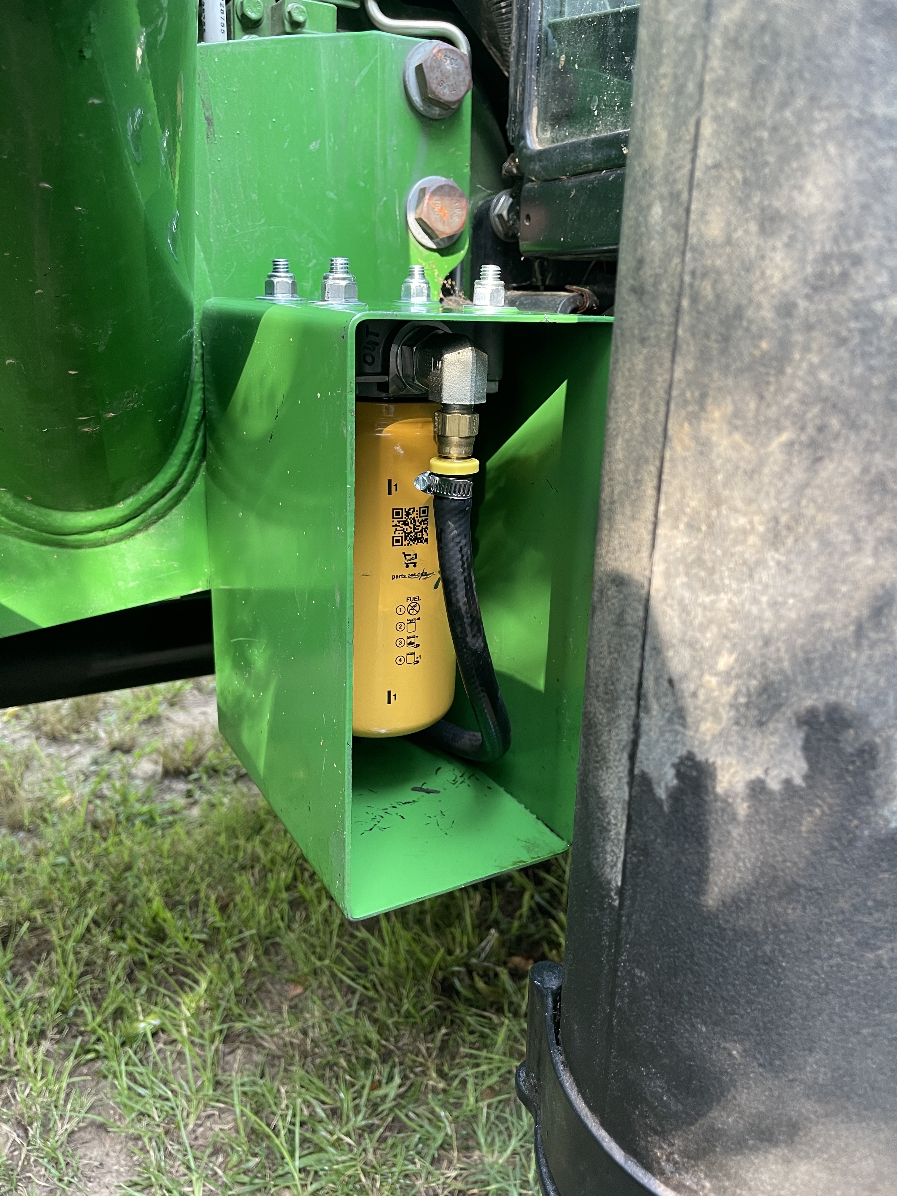

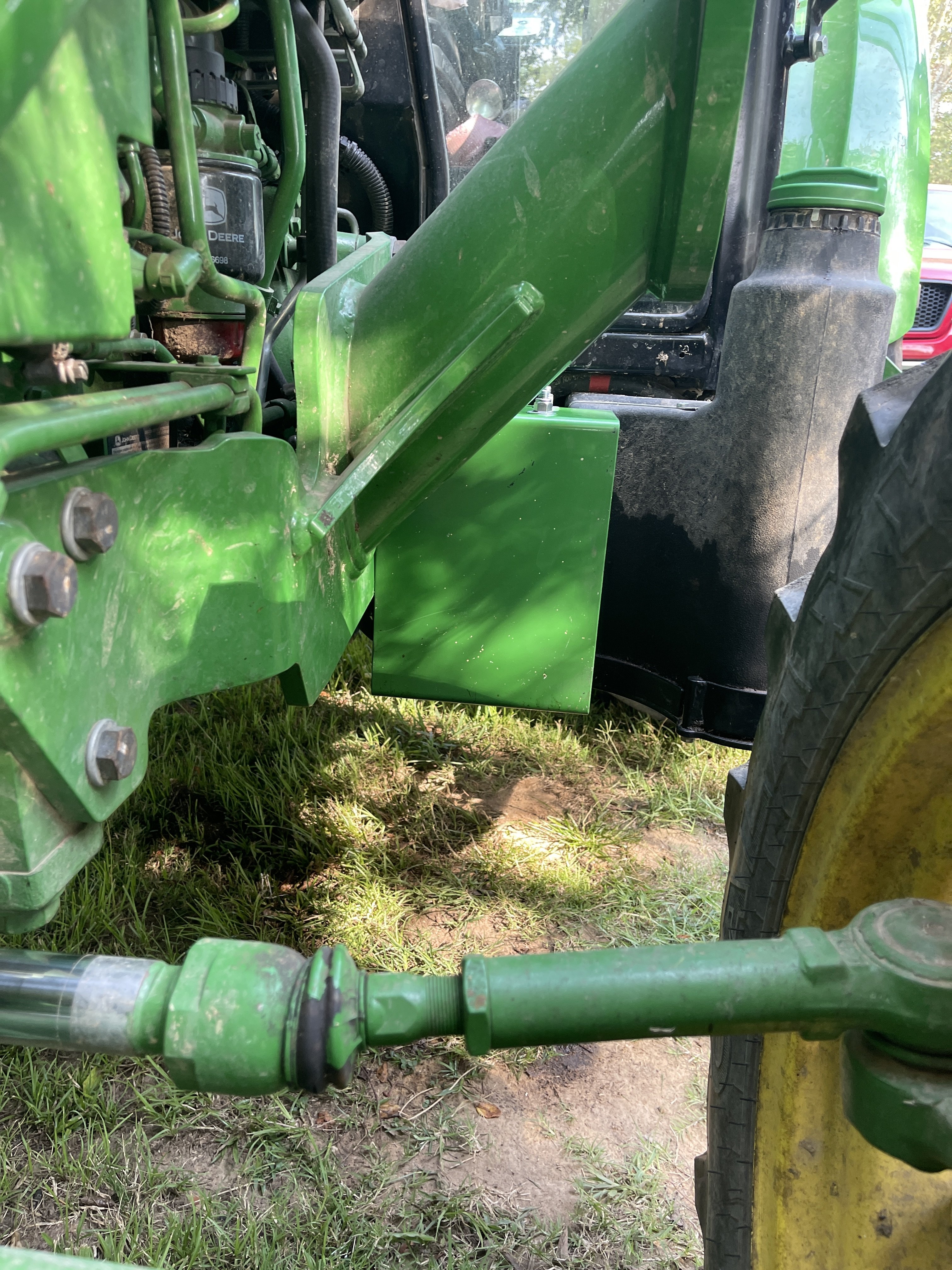

5075E Fuel Supply Issue
Pics of external fuel filter mod to my 2018 JD5075E after removing the OEM internal pencil size filter.
Used a Baldwin filter base and Cat Fuel Filter both purchased off Amazon, hose end fittings from local ParkerStore Hydraulic Hose & Fitting Service Store. Replaced OEM fuel hose with Gates hose. Custom fab on filter enclosure, top two bolts to hold enclosure utilized existing tank mounts (changed to longer ss bolts w/ss spacers), bottom two bolts - drilled holes in tank mount (ss bolts w/ss spacers). So far no more issues with starving fuel flow.
