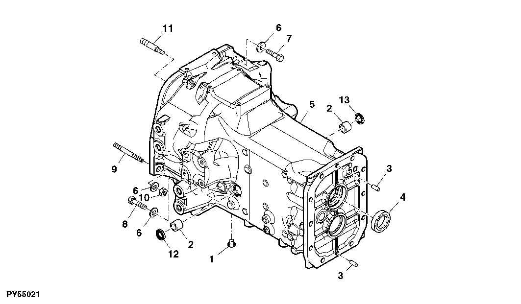

Can you post a pic of the "bolt" you mention?
   / 5055e bell housing bolt #4
Is it pipe plug(parts key 1)?

Yes, it is the pipe plug part key 1. I wonder why Deere never mentions to remove this in the manual at least once a year?
