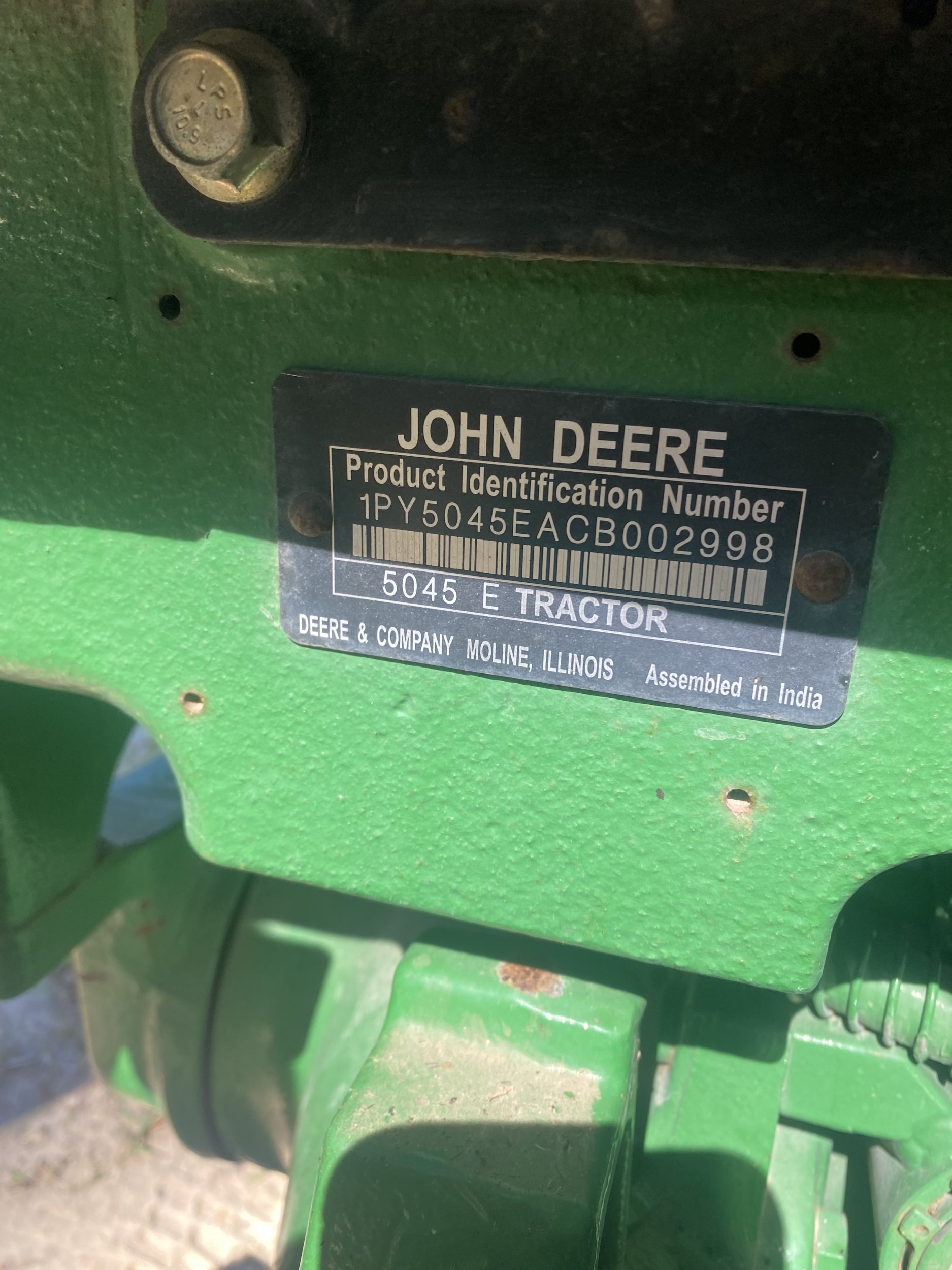

Harry, I did go out and look at mine and you’re right…it only has the hand primer on top of the fuel filter base! I remember that because when I changed the fuel filter, I had to pump that to prime the system back up so it would crank! I will look into that strainer as well! I have attached a picture of my serial number so I may not be reading my year model right! I thought it was a 2000 year model!

Harry….just did some reading and I GUESS the SN tells the year it was made! As far as I can tell…I BELIEVE the last “0” in the SN tells what year and according to JohnDeere website it was the 1st year model…which would make it a 2012… I TTHINK! LOLOL…do you know for sure?
/ 5045e loosing power & smokes #13
I have no way to track your serial number. I'm just going on experience and model year 2000 sounds way too early for that series tractor. 2012 sounds much more likely. I don't see many 5045 models, the 5055e and 5065e are much more common in this area.
