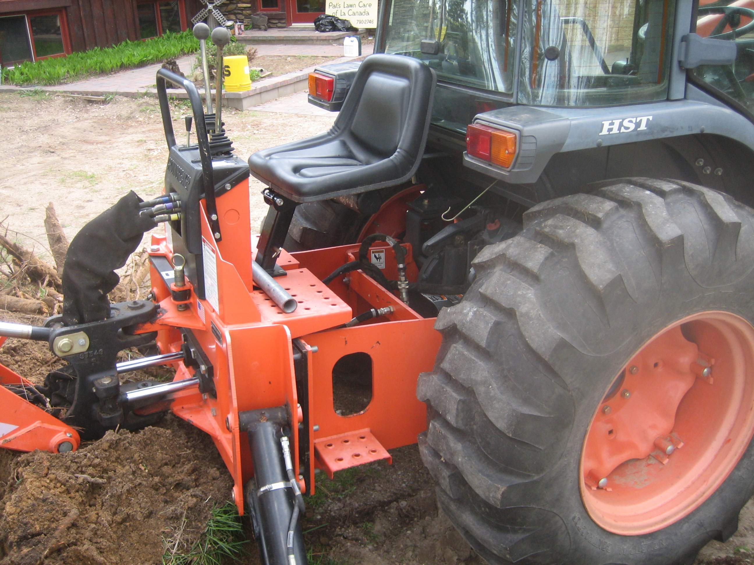

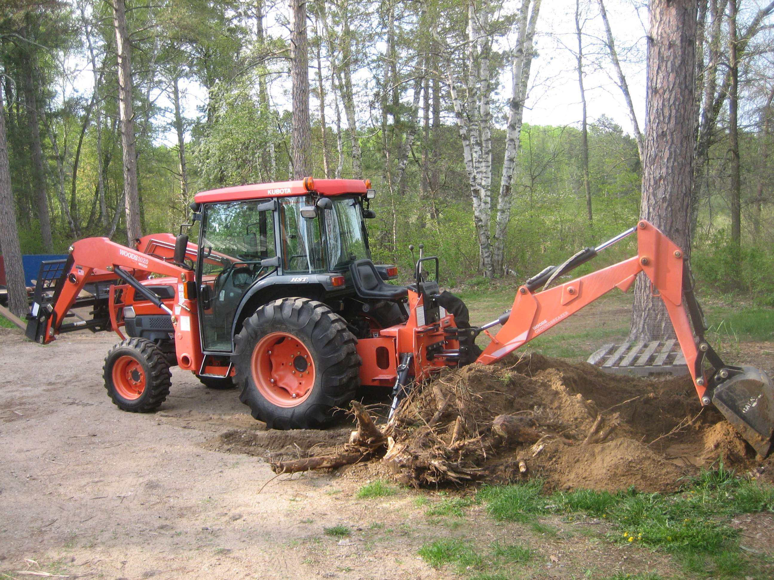

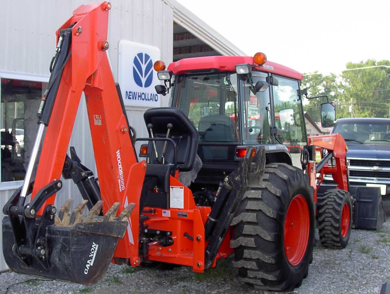

Here is a pic of My woods bh9000 on a 5030HST Kubota. Check with Woods for a subframe for your tractor. I might be talked into selling mine. 9.5 foot digging depth it is no toy.
