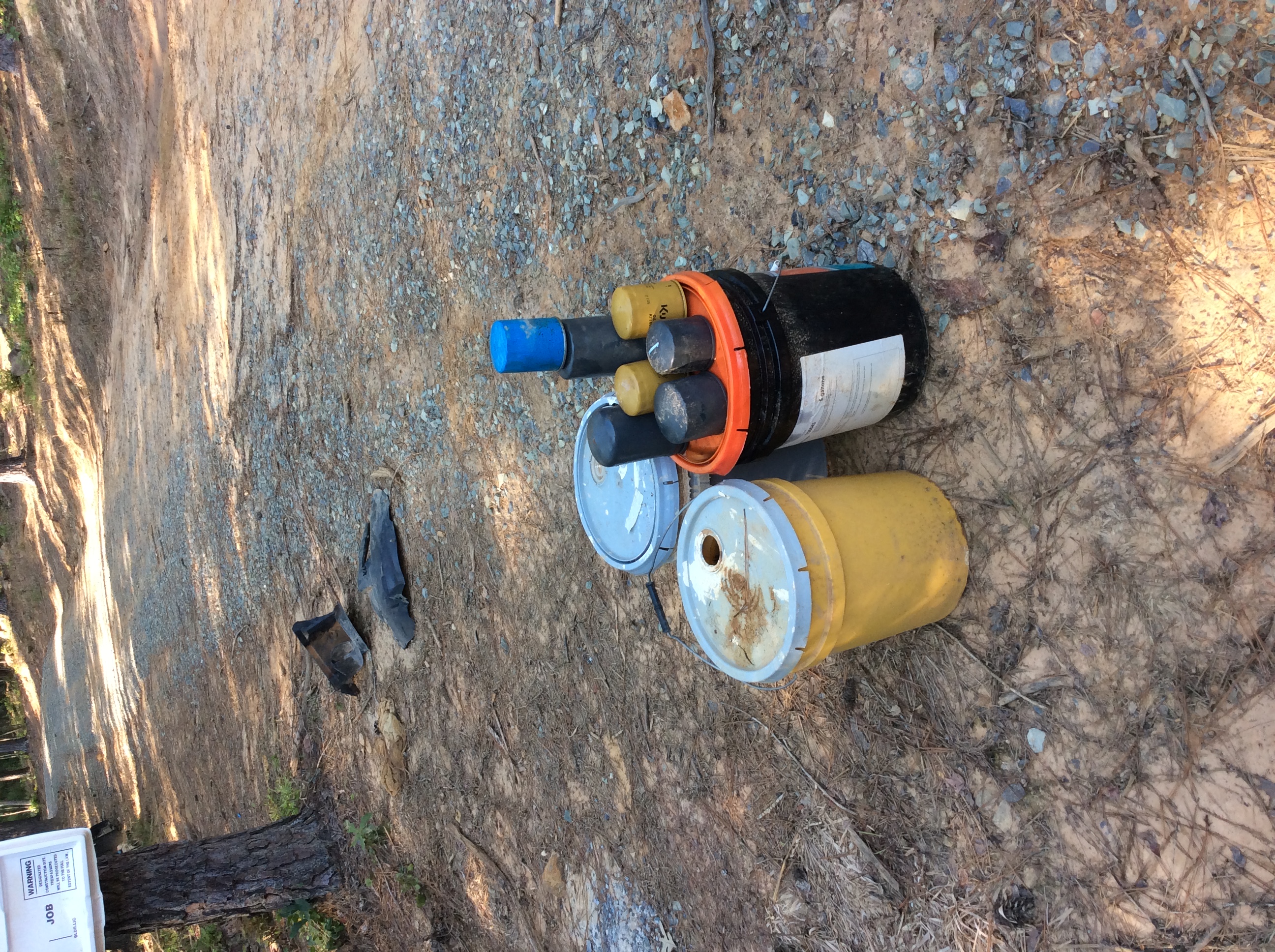

So I cut the filters open and nothing was obvious bad looking. just a few very small flakes of brass as expected, some obvious dirt like you'd expect, some rubber gasket material.

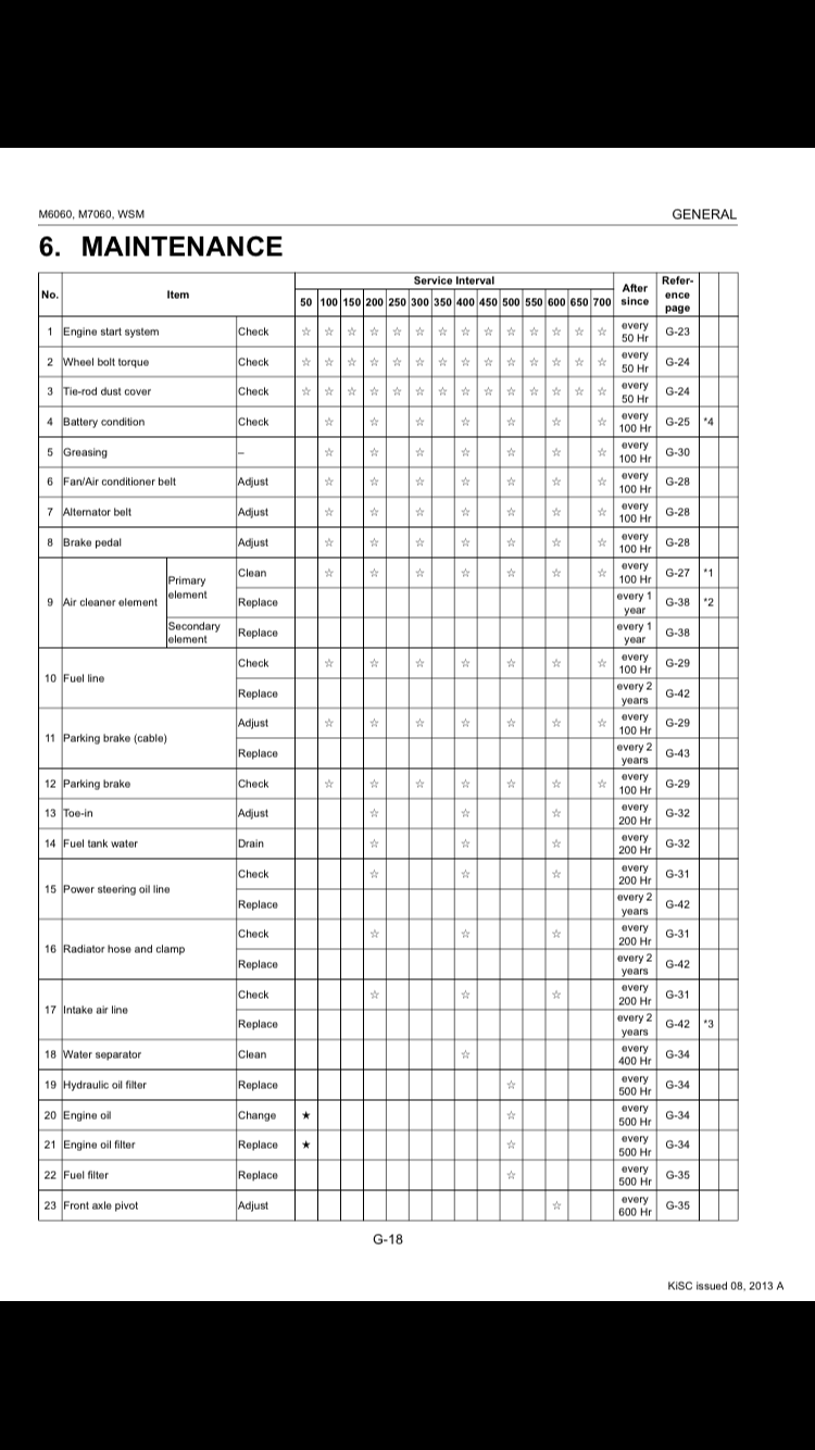

As for not changing them sooner, I bought the machine used with 270 hrs on it. Asked the selling dealer to get it up to date on whatever was needed to be done and they did. The book does not call for the Hyd oil to be dumped/ filters changed till 500h so they didn't do it. I bought the machine 1500 miles away unseen. I likely should have done it as soon as it arrived but sort of trusted things had been done that needed to be. The engine oil had been for sure.
Just the Hyd oil/filter change on this machine is $500 for parts and oil. not expensive for a machine of this value but still not something ya just go doing willy nilly!
I'll be dumping the oil in 20-50 hrs and rechecking the filters to be sure.
I know the previous operation that had it used rear remotes a lot, and so do i. I suspect the previous operator likely didn't take care to clean the tips as well as they should have.

yea.. the manual dose say 500hr on the m7060 for hydro filters. I was thinking of doing the hydro filters at 50 when I do my engine oil. I already bought them just to have. I think you made the case for changing them early in my mind.

Blaster, i just drained all the oil into a rubbermaid tote that i k ew would hold it all. i'm sure most of the oil
came out. i'm sure if you did have the rear higher, less would drain out.
I've ran about 15 hours since i changed the filters and am now heading on the road for work for a month.... had to order oil in as i didn't have time to drive 2.5 hrs to the nearest place that has kubota stuff. Of course delays meant the oil hasn't arrived yet, hopefully there's stock when i'm back, as i'll run a few more hours then change it all and update with what those filters look like!
5030, i agree with you, oil and filters are cheap. but this interval is following Kubota's recommendation. I don't have a local dealer for any type of ag equipment. nearest is kubota at 2.5 hrs for the toy dealer and 5 for the ag sized shop. Not sure how someone with no experience is supposed to know better than to follow what the manual says!
