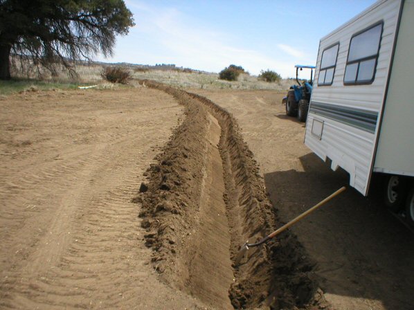

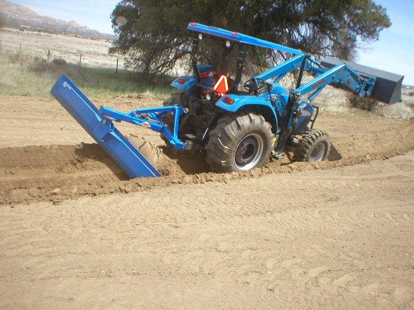

Have any of you used a rear blade to do any trenching? I had to put in a few hundred feet of temporary water line last year and I used my rear blade, 2 passes to get 18" deep. Laid the line and back filled, all of it was pretty easy. I suppose that if you had very many rocks that it would be much more difficult though.

I'd hate to try and do that in our Claycrete dirt here.

Brian, that rear blade work looks great and it did a fine job for you. However, I have so many roots and buried tree parts on my place that I am running a sprinkler system on, that I would tear up a nice piece of equipment using it that way. I've bent the frame (not the shank) on a subsoiler (Howse) and have broken two middlebuster furrows. In hind sight I would have been better off with this particular project to have rented a trencher.

Yeah, I guess that the ground needs to be just right to be able to trench with a blade. I'm lucky I guess, I have only a few roots and or rocks that I ever have to deal with. Although while working on a new drive I ruined my rear blade.:( But that is what happens when you use equipment that is not matched properly, as I have done more than once.:eek:

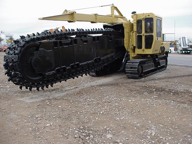

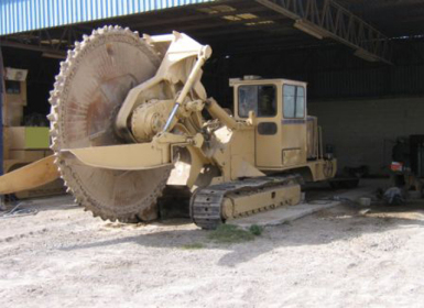

Either one of these little toys should do the job for you in a hurry. :eek:
