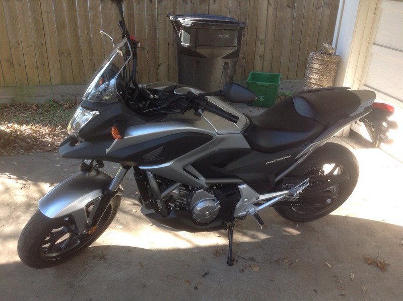

Does that thing actually get 70 MPG. I had a 500 cc SilverWing (1982 I think) with a little trunk on it just big enough for a helmet and it did pretty good and had lots of power but only about 35 MPG. Then I bought a 1984 Goldwing and got about 32 MPG but man was it a blast to ride and powerful. A buddy had a 750 Honda ACE and got about 50MPG. 70MPG is like scooter or mo-ped mileage.
/ 50 Hour Service #22
Gary, I sent you a PM so we could stop hijacking this thread -- sorry everybody, I should have started a thread titled "Cheating on my S3010".
