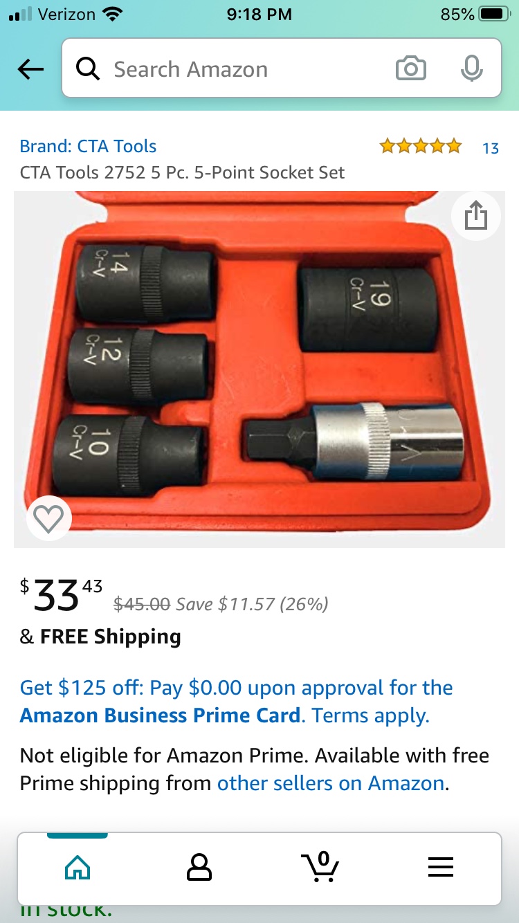

The 10 mm should work
   / 5-Point sockets #6
And since 25/64 is almost exactly ten millimeters that set should work for you.
   / 5-Point sockets #7
25/64 = 0.390625
10mm = 0.393701 ,,,,,,,,,,, 3 thousands larger
   / 5-Point sockets #8
Anyone know where I can find a 25/64" 5-Point socket to fit the bolts on a Ford 1715 injection pump?
The 1715 uses a shibauru engine from japan, which is metric. The other posters are correct in thinking it's a 10mm, because it is.
