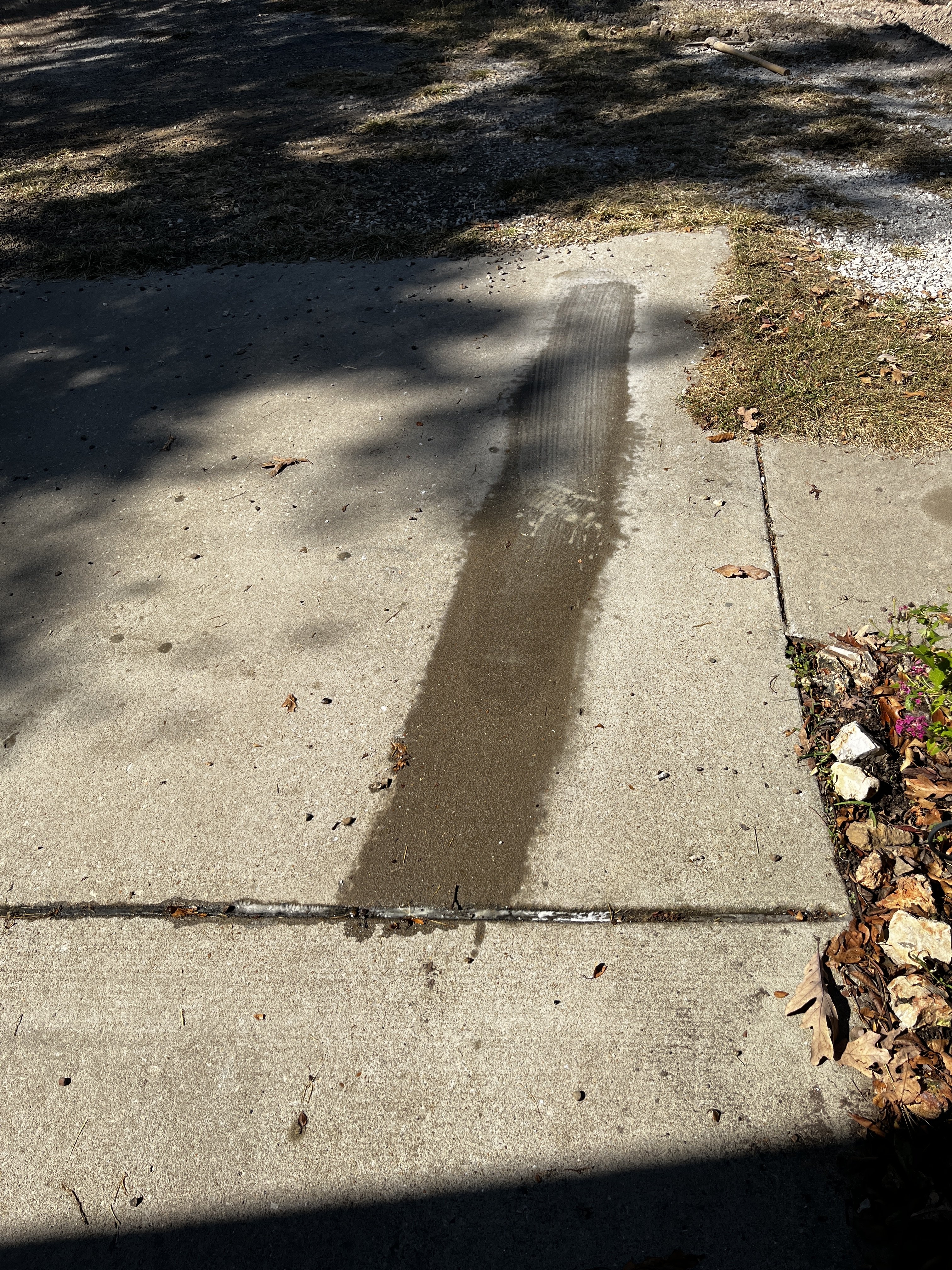

Gotta clean this up before the misses gets back home, yikes!
Was using BY85 backhoe on my TYM T574H and afterward, scooping up the spoil pile with the loader bucket. Going to check levels, but I don’t see anything on the fittings up front, could this be from the backhoe?
Any easy way to find hydraulic leaks, like infrared light or some kind of black magic?

It's a bummer that a new machine is leaking. But it may just be a quick connect that's dripping or a fitting that didn't get tightened enough.
With that much fluid on the ground there's a good chance there is some tell tale fluid left on or under the machine. You may see drips where you parked it after using it, if its parked on a hard surface. Or you can look at the sides and under it starting with the rough area that was above where the puddle on the ground started.

Just topped it off, I think we’re good now. I did notice the male 3rd function fitting up front was dripping from earlier in the day when I took the grapple off and mounted the loader bucket. After refilling, I went to dry it up and it seems that I pushed the dust cap on the male coupler on too snug and it was slightly actuating the tip detent and releasing fluid. Is that possible and, if so, why would they design a dust cap that way? I left it on much looser this time just in case.

Worked with it this last weekend and didn’t lose a drop. My conclusion is, I put the dust cap on too tightly on the male hydraulic fitting and the hose completely drained on the driveway. The tractor was positioned in a downward trajectory to facilitate this.
Using that UV light, it’s the only place fluid was “visible”.
   / 5 hours of use and leaked hydraulic fluid on my driveway 🙄 #18
Appreciate the follow up. Keep an eye on the fitting just in case. I think, rather that the dust cap issue, there may have been a bit of debris holding the fitting open, or a poor seat on the fitting. If it occurs again, I would change out the fitting.
