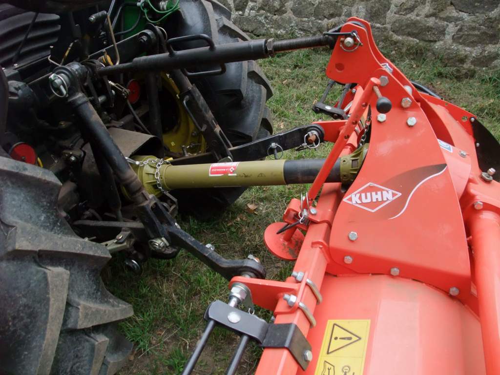

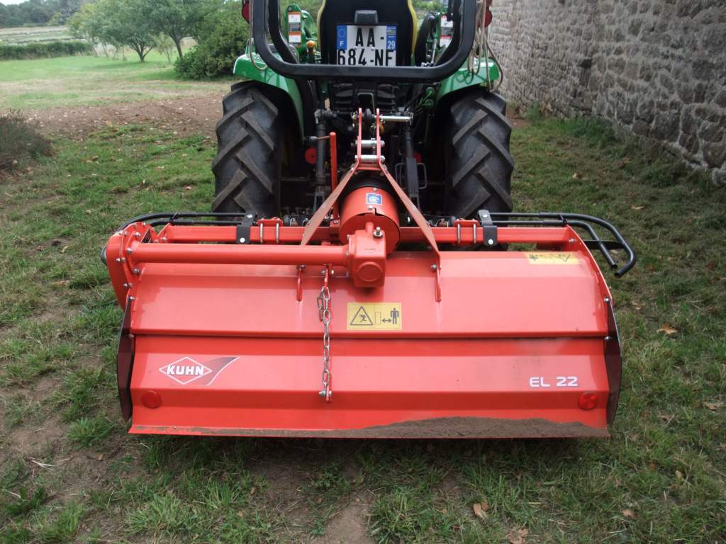

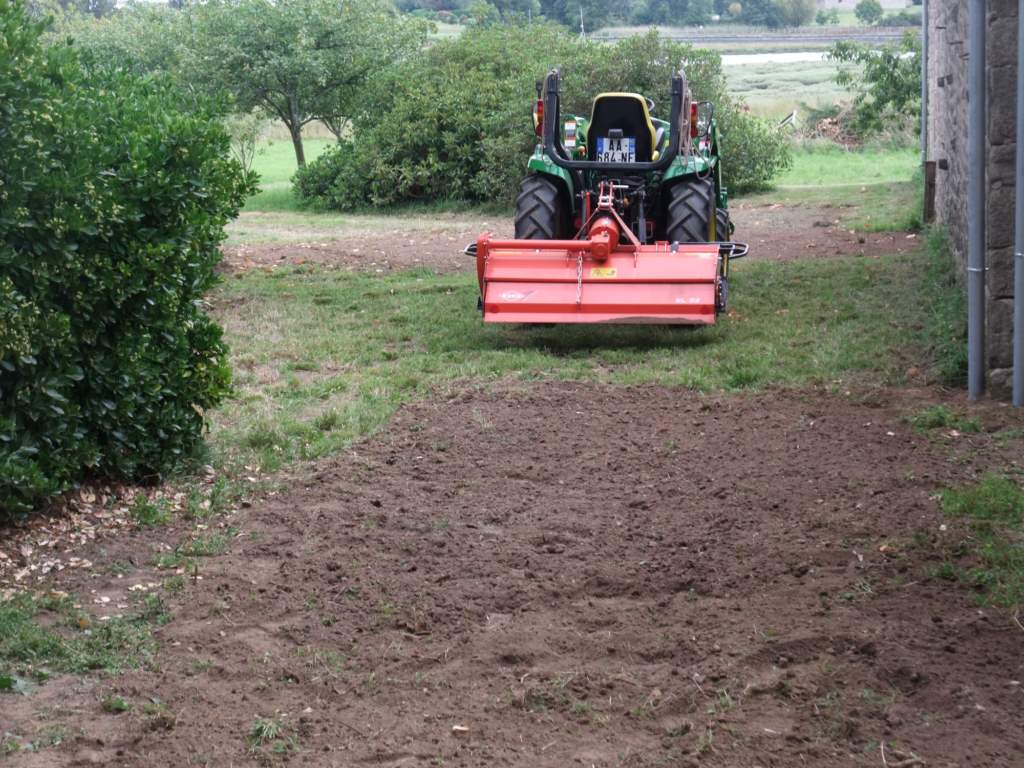

I use a 5' Kuhn tiller with my 30 HP PTO JD 3520. It seriously shakes the tractor when hitting rocks or roots, but there is plenty of horse power. I think you would be OK with 22 HP. A narrower tiller will make the job longer as you'll have to cover your tracks.
